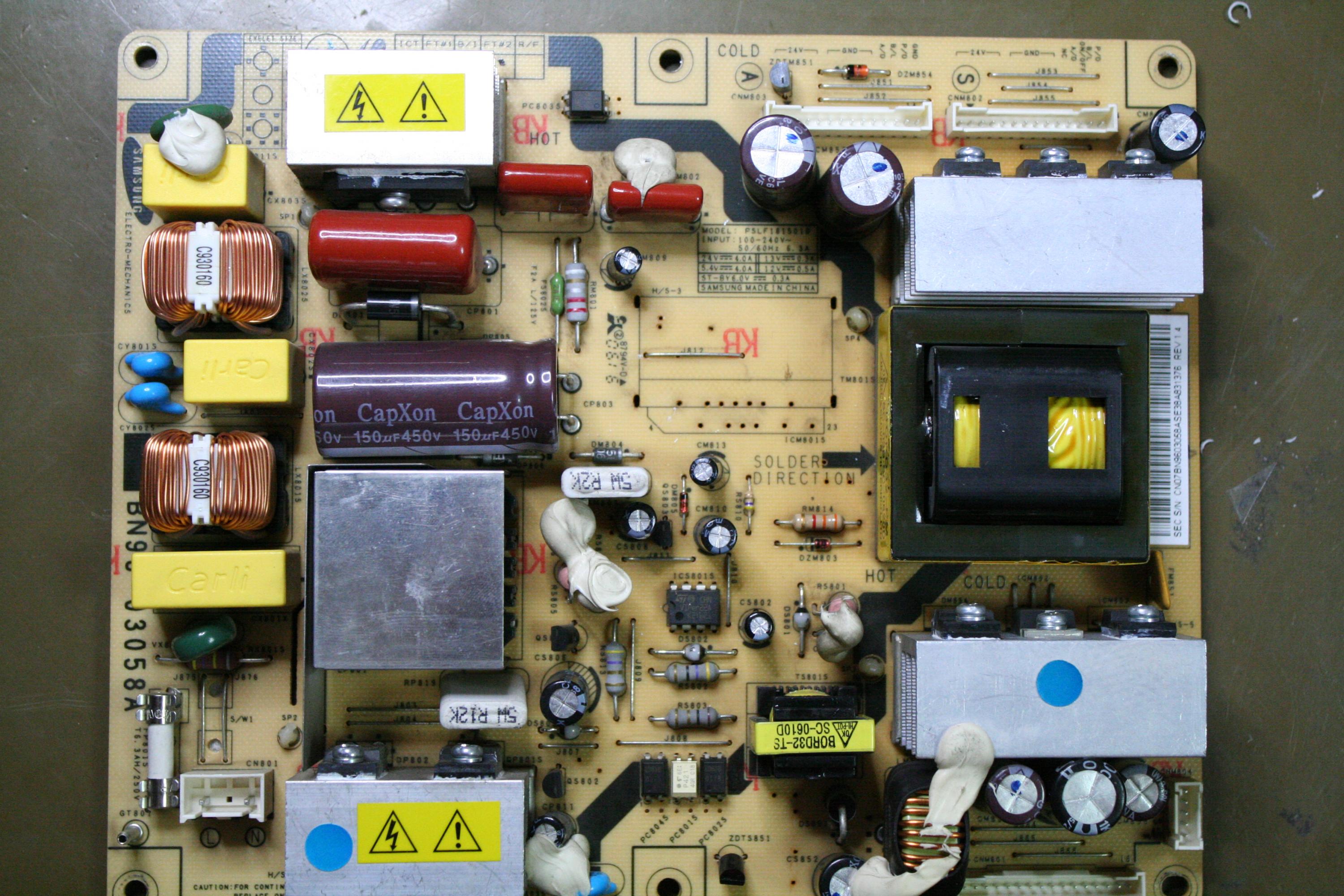

    Greetings fellows, this is my first ever post here asking for help, so please don't be too rough on me if I mess anything up )

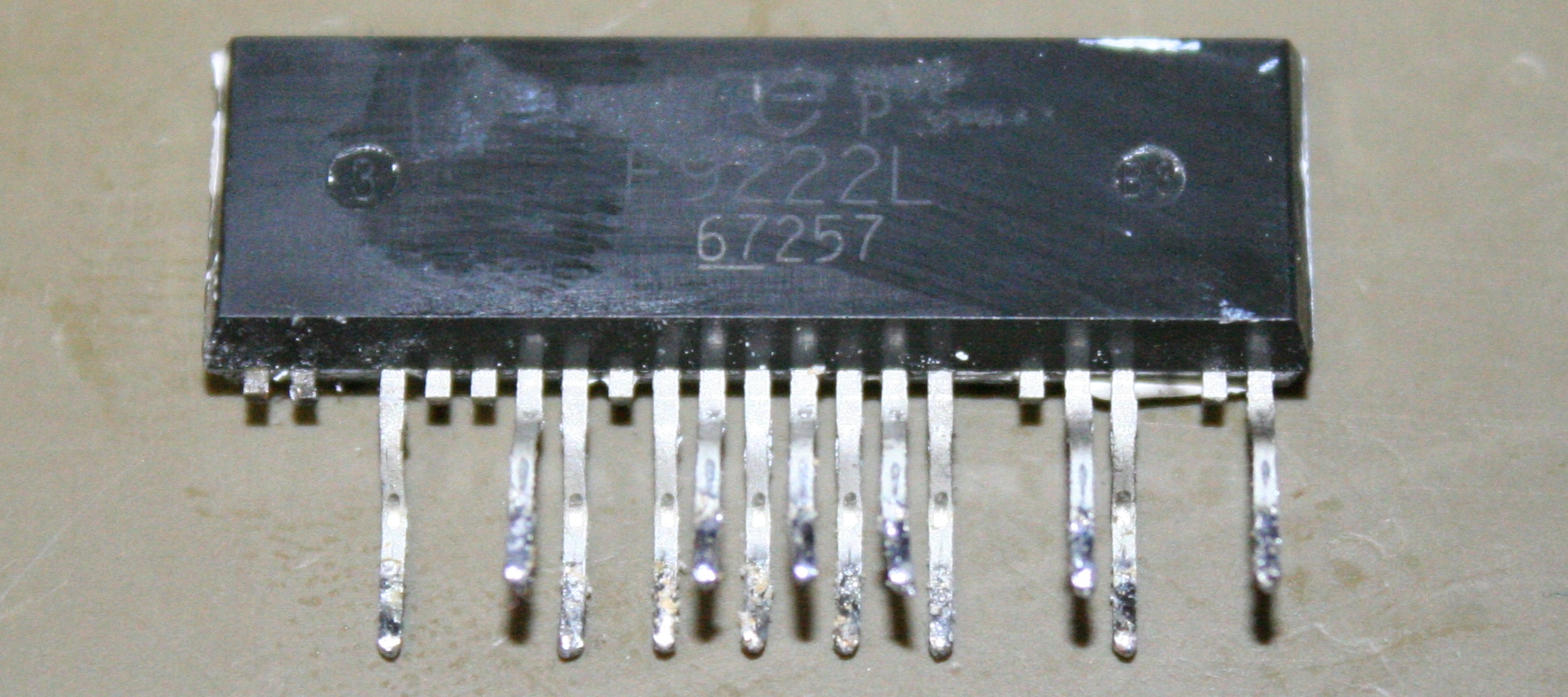

    So I've got this small Samsung TV (model LE26r71b) with a bad power supply. The power supply board is a BN96-03058a (the one in the first picture - hope you guys can see it). I've repaired several of these before and all of them had either bad caps (the irony), or the IC in the second picture gone bad (or, of course, a combination of both). The IC is a F9222L and it's a pretty obscure thing, as I couldn't find a detailed datasheet about it. I do know that's it basically two MOSFETs with a control IC built it. On all of the supplies where I've encountered this F922L so far, the problem was the classic flashing red light or a completely dead set (blown mains fuse due to one of the FETs in the F922L becoming shorted, sometimes taking out the mains rectifier with it).
    Replacing the F922L fixed the issue every time, however, the symptoms on this one are quite different: the set doesn't turn on (duuh), but the power light doesn't actually flash, it sort-of FLICKERS accompanied by a rhythmic whistling sound, indicating that the PSU is trying to power on but can't...strange.
    Taking some basic measurements showed that the 5VSb line is Ok....and that was about it, since applying those 5 volts to the ON/OFF pin produced the same result: whistling sound and no power to the 12V rails (inverter and main board were disconnected). I checked the diodes in the secondary side for shorts and they all reported fine. So did the KIA278R and the 33167t (both in the upper left of the board: the KIA is a 12v voltage regulator and, while not showing any shorts, I can't exactly check whether it's working or not, since the 12V rail doesn't show any sign of life (the transformer is not supplying anything to the secondary). The 33167t is a transistor and it's part of what I'd identify as a buck converter that produces the 5Vsb, so that's definitely working. Now my question is: could this defect be caused by the F922L ? It's a fairly expensive part, so I wouldn't want to get it and realize it's not that (TVs not mine btw). I know there's a whole lot of other parts that can go bad on a SMPS, but maybe someone else has had this particular issue before and can at least guide me. I must admit, I haven't fully checked the PFC section, so maybe you could give me some pointers there too. Sorry for the wall of text, but I wanted to give as much info as possible. Cheers
    Wattevah...

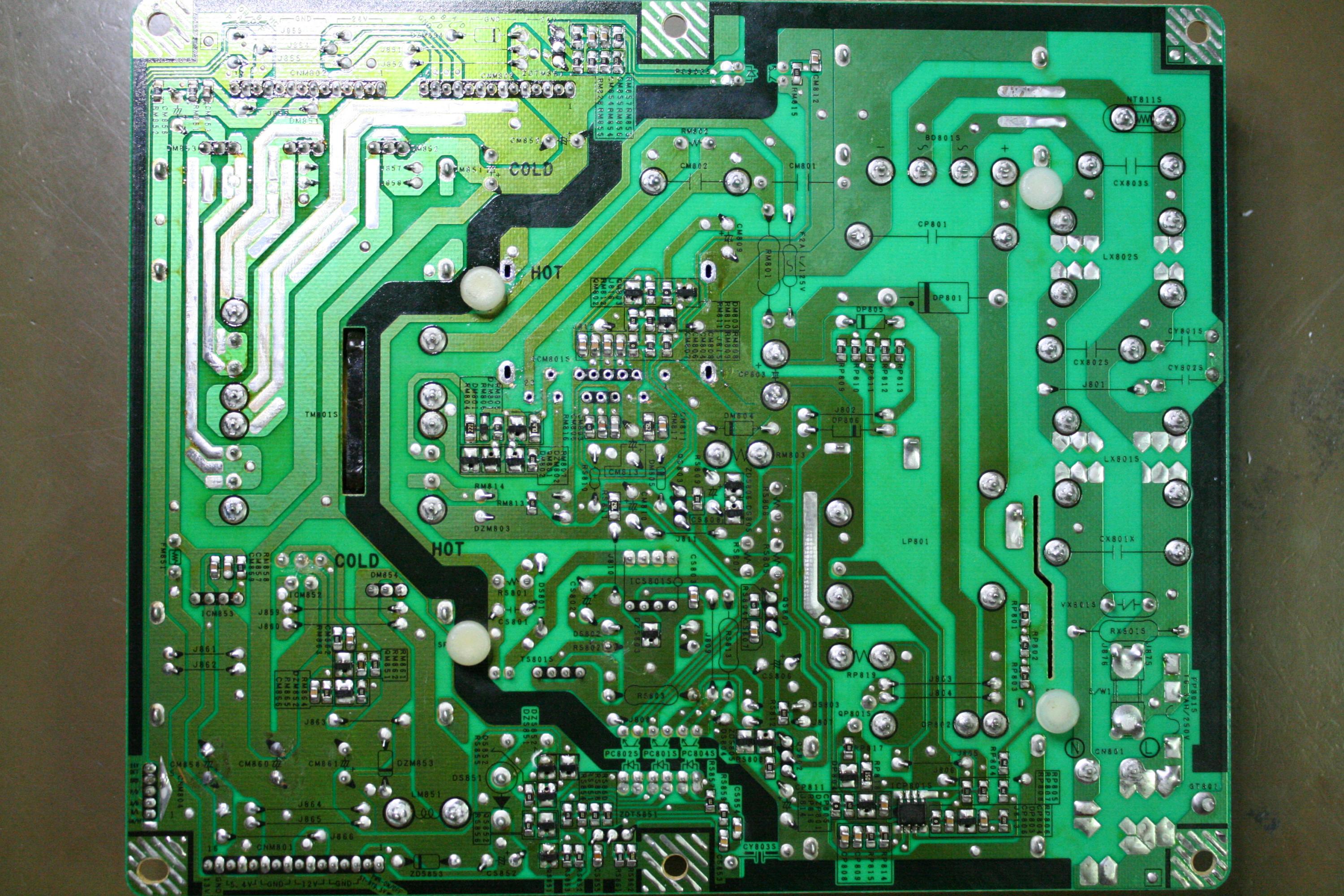

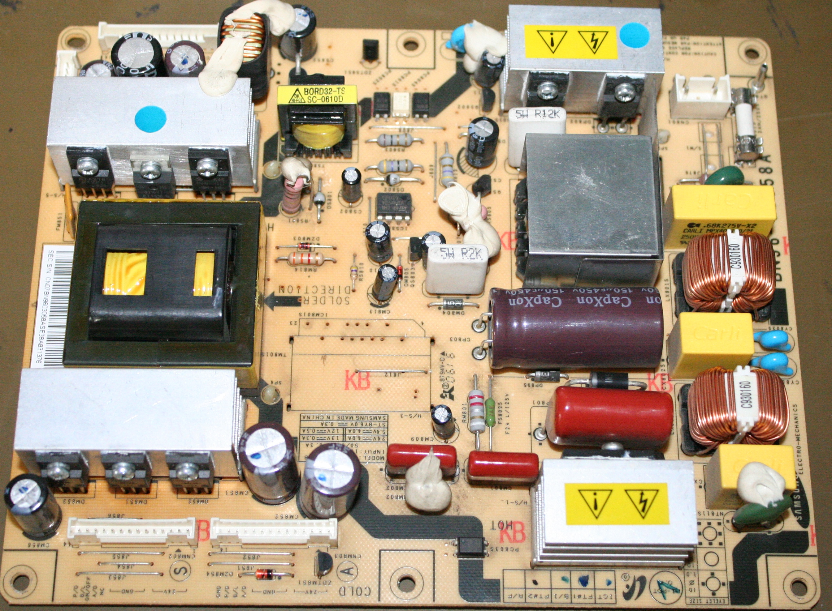

      Can we get straight shot pictures of the bottom and top sides?

          Pictures of BN96-03058A
          Here are the pics you asked for: top and bottom. Hope they're clear enough. I have already removed the F9222L from the board, so that's why it's missing.

            Re: Samsung LE26r71b power supply issue. Any thoughts ?
            Posted the pics above, plus an update: I've replaced F9222L and still the same issue: flickering power LED and no 12v. Supply makes that ticking sound when I attempt to power it on. Big reservoir cap reads 324v with nothing connected to the board and the STBY pin floating (not connected to 5v standby).
                    Check those little capacitors, specifically the ones that are near a heat sink.
                      I'll start replacing caps tomorrow (I too immediately thought of heat damage, especially since the bloody things are always strategically placed near hot parts). Hopefully one of them will cause it to fire on. Again, I'm placing my hopes on that CM802. I've also talked to a guy today who's more tech-savvy than I am and he also suggested I'd check the 5 SMD resistors on the back (RP809 through RP813) that provide the feedback for the PFC, so I'll also do that as well. Another thing he suggested was applying 5V to the 5V stand-by pin of the main board to see whether the power LED still flickers or remains stable, to rule out the possibility of a bad main board, which would be a tremendous laugh after all this trouble I went through (not to mention money spent on parts - lesson learned: CHECK THE MAIN BOARD FIRST!) )
