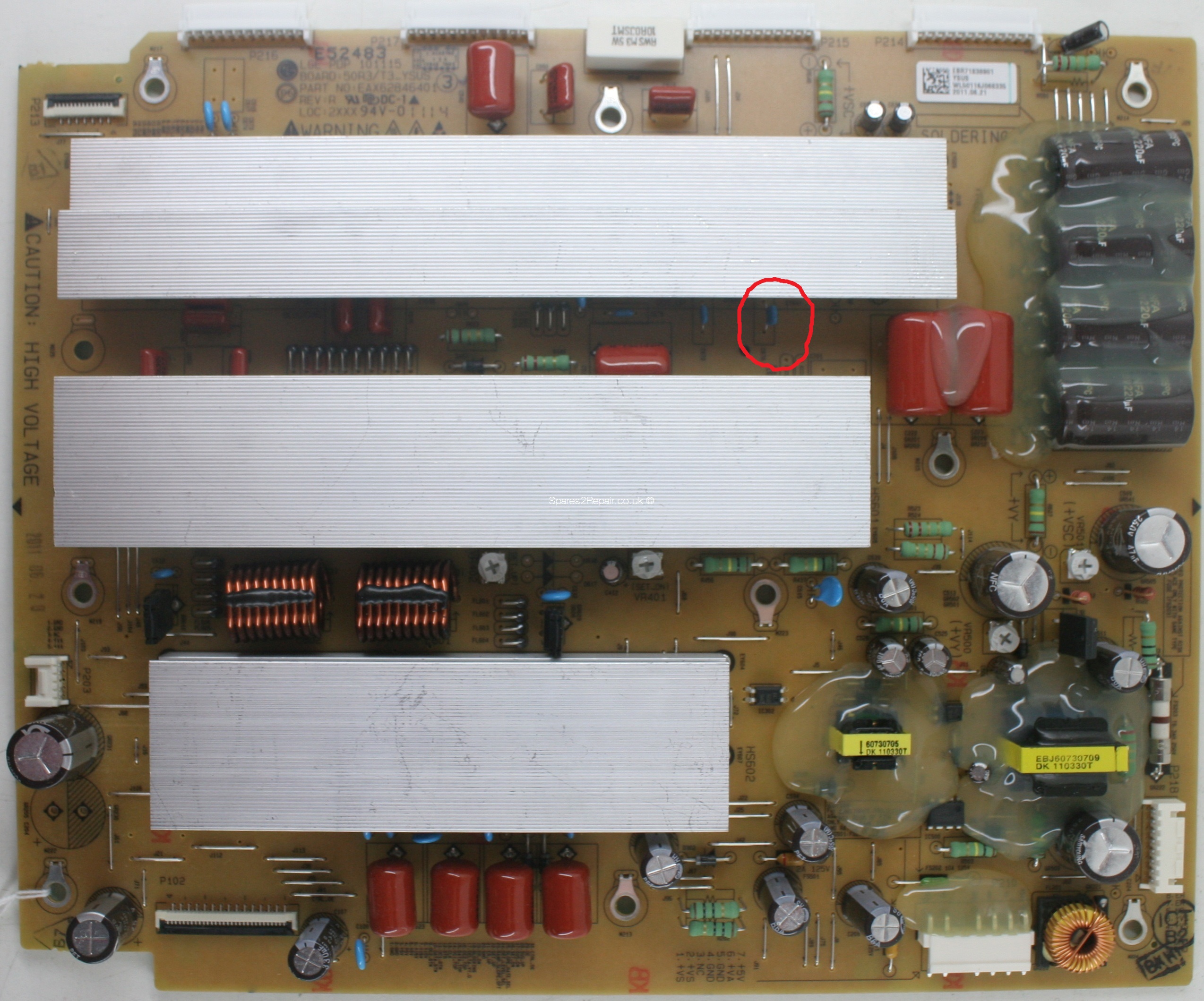

    I picked up a LG 50" plasma to work on. When I got it home to see what it was doing it had a burnt 102k 1kv capacitor on the Y-sus board. I replaced it and it's still not running but the Y-sus board has a buzzing noise. Here is a picture of the capacitor I replaced.

    Nevermind. When I checked the power supply board I forgot to plug the main board back in. TV is up and running. 2nd TV repair is in the books.

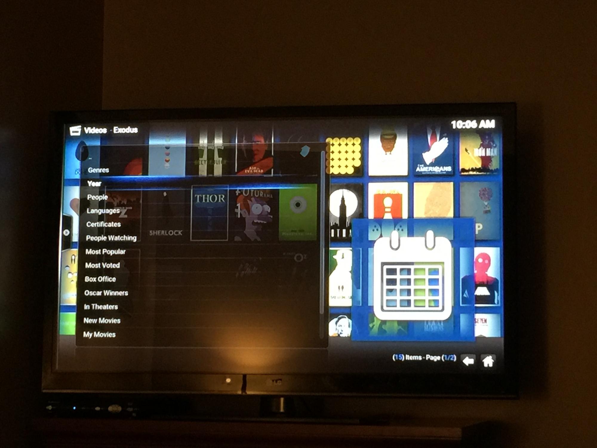

      Here it is up and running.

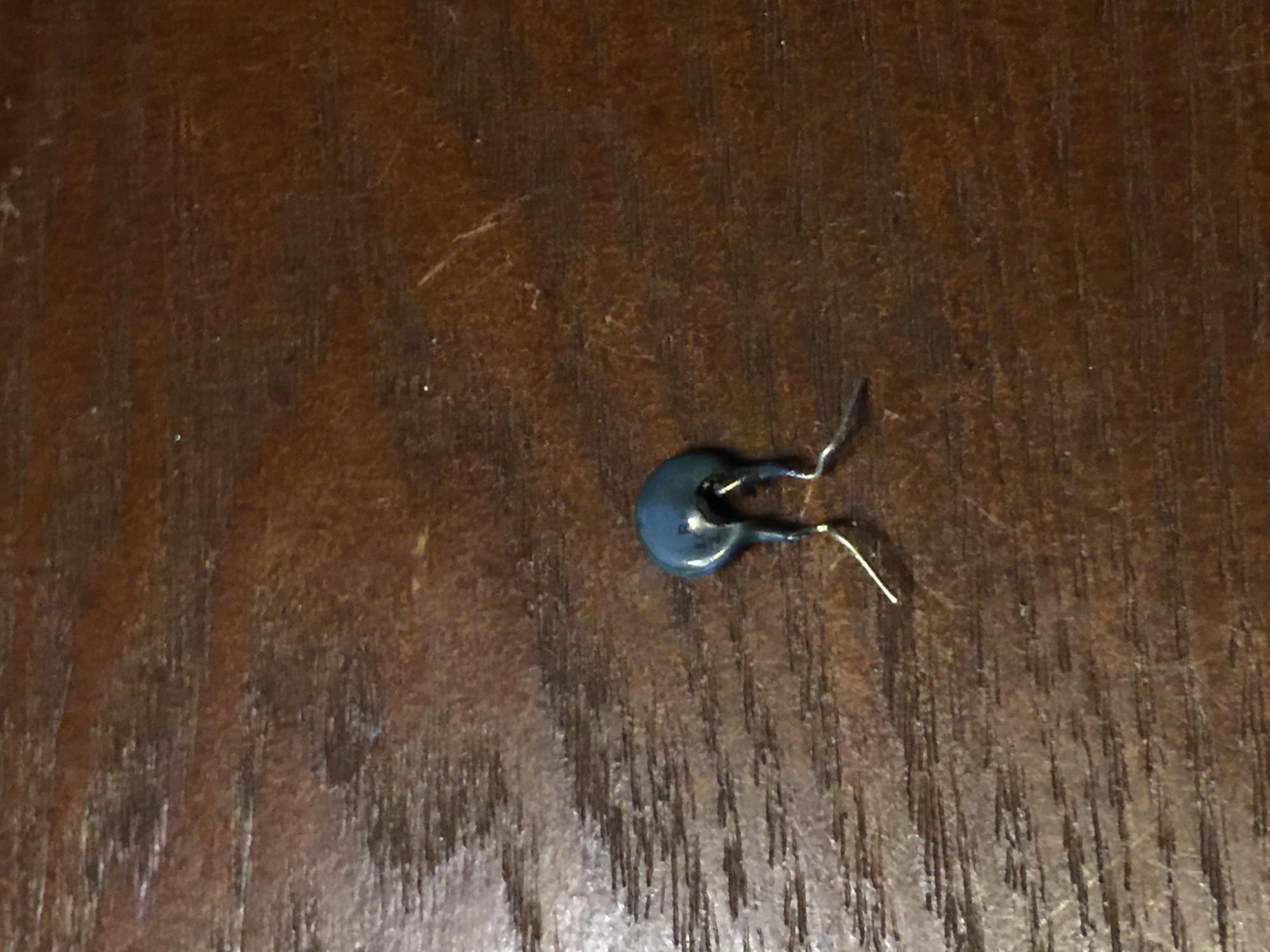

        Here is the bad capacitor that I replaced.
