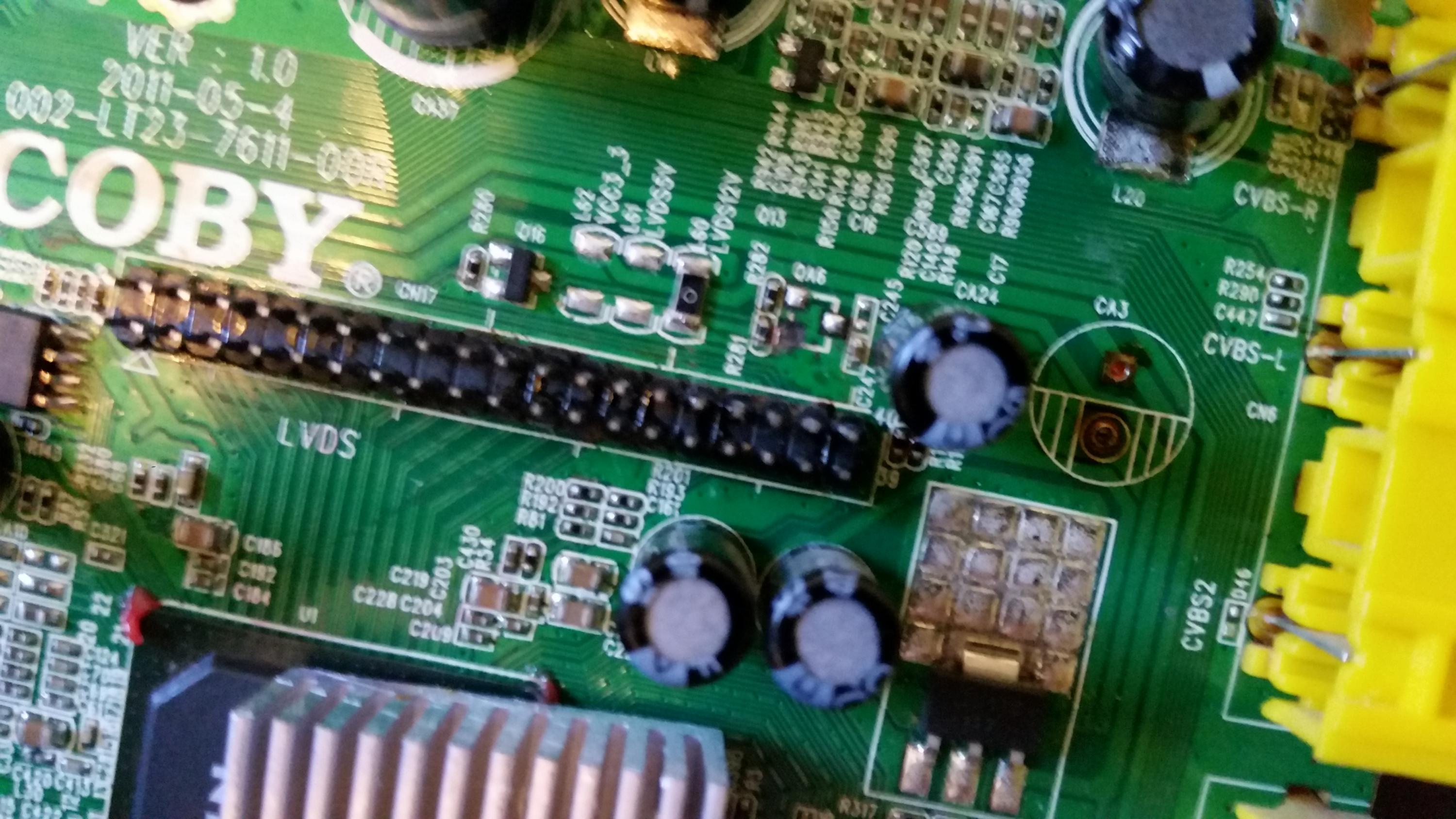

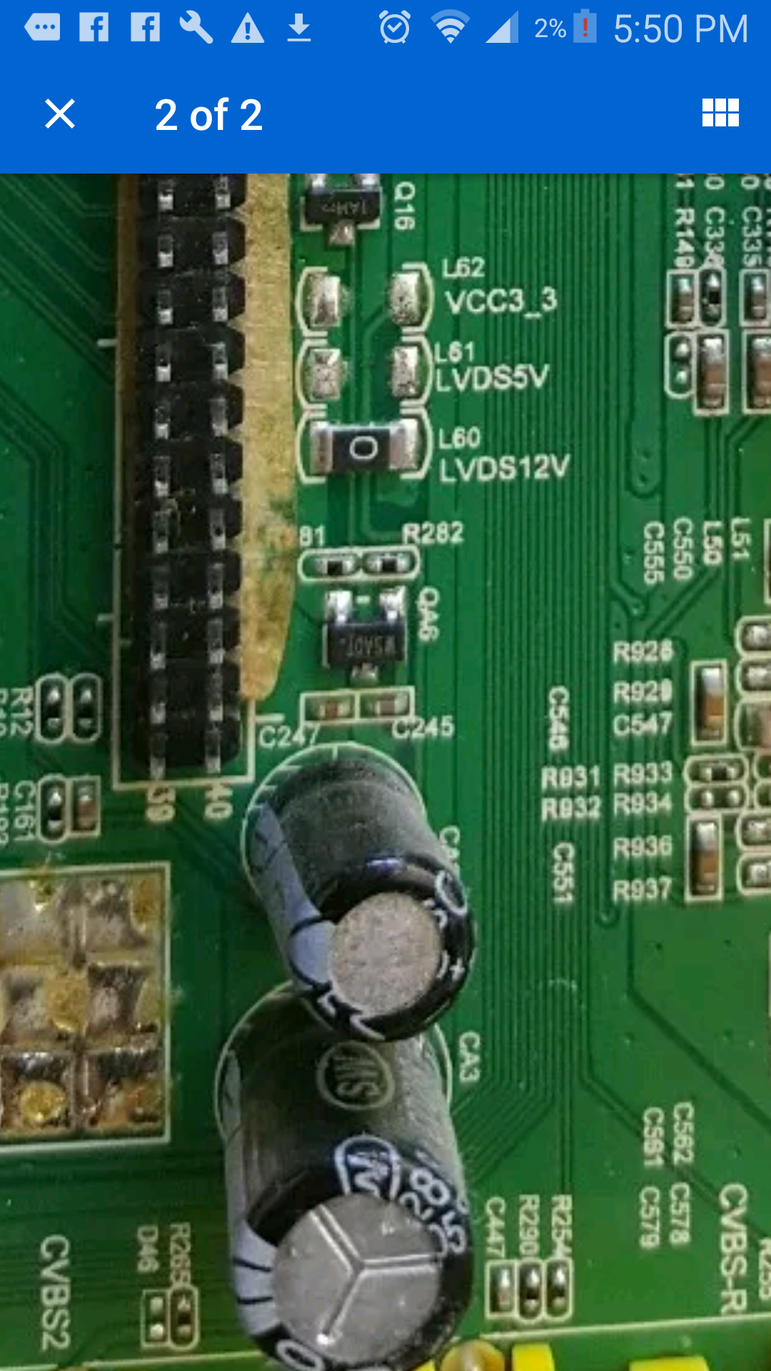

    coby led4626
    I need help identifying a part for replacement, the mainboard i have has a burned component, unidentifiable markings incidentally, i have found a pretty clear image of the component but cannot find any information about it, can someone identify this part? Its in location qa6.

    Re: coby led4626
    Looks like a mosfet to me for the panel-VCC used as a switch. Maybe a P channel Mosfet. Something like a AO3407. https://cdn.badcaps-static.com/pdfs/...b1f6ab665c.pdf Not that I am saying it is that exact replacement for it, as I can't read either what the picture is saying. But if push comes to shove, this is better than nothing.
    I wonder if your panel is shorted?

      Re: coby led4626
      QA6?
      Do you have 12V at either end of the Inductor L60?
      That device has to be able to handle at least 5A or more. You can look up the spec sheet of the LCD panel to find out what the inrush and the running current of the TCON is needed.
      And as mention, you should check the fuse on the T-CON board and the resistance between GND and the output side of the fuse to see if there is shorted circuit there.

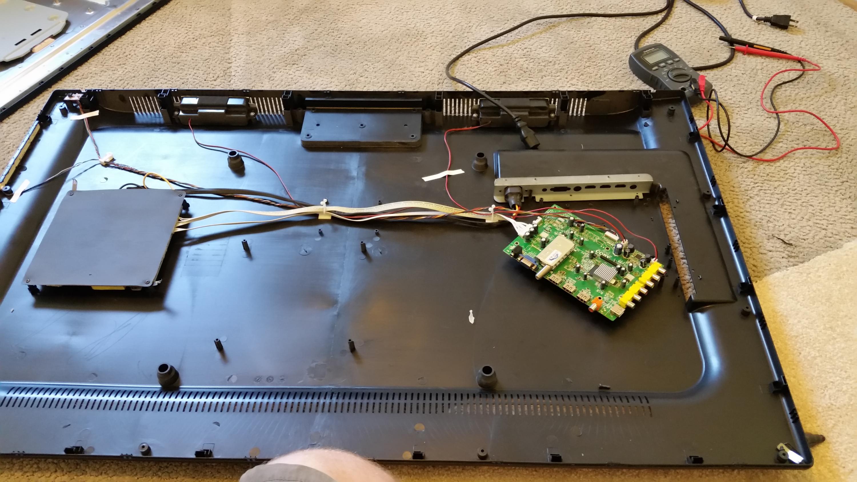

        Re: coby led4626
        I do have 12v at both ends of l60 bud, and the tcon fuse is good, im not sure how to test a shorted panel capleaker? Ill post a pic of how the boards are layed out, i didn't have the tcon or led inverter board connected when i tested the main board.
