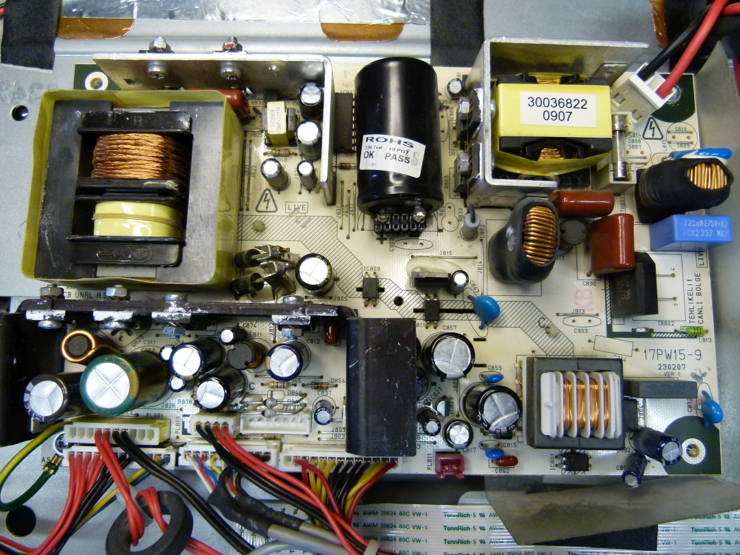

    Vestel MB22+17PW15-9 (Goodmans GTVL32W26HDF)
    Goodmans GTVL32W26HDF (32" approx 2007)
    Vestel MB22 chassis
    PSU 17PW15-9

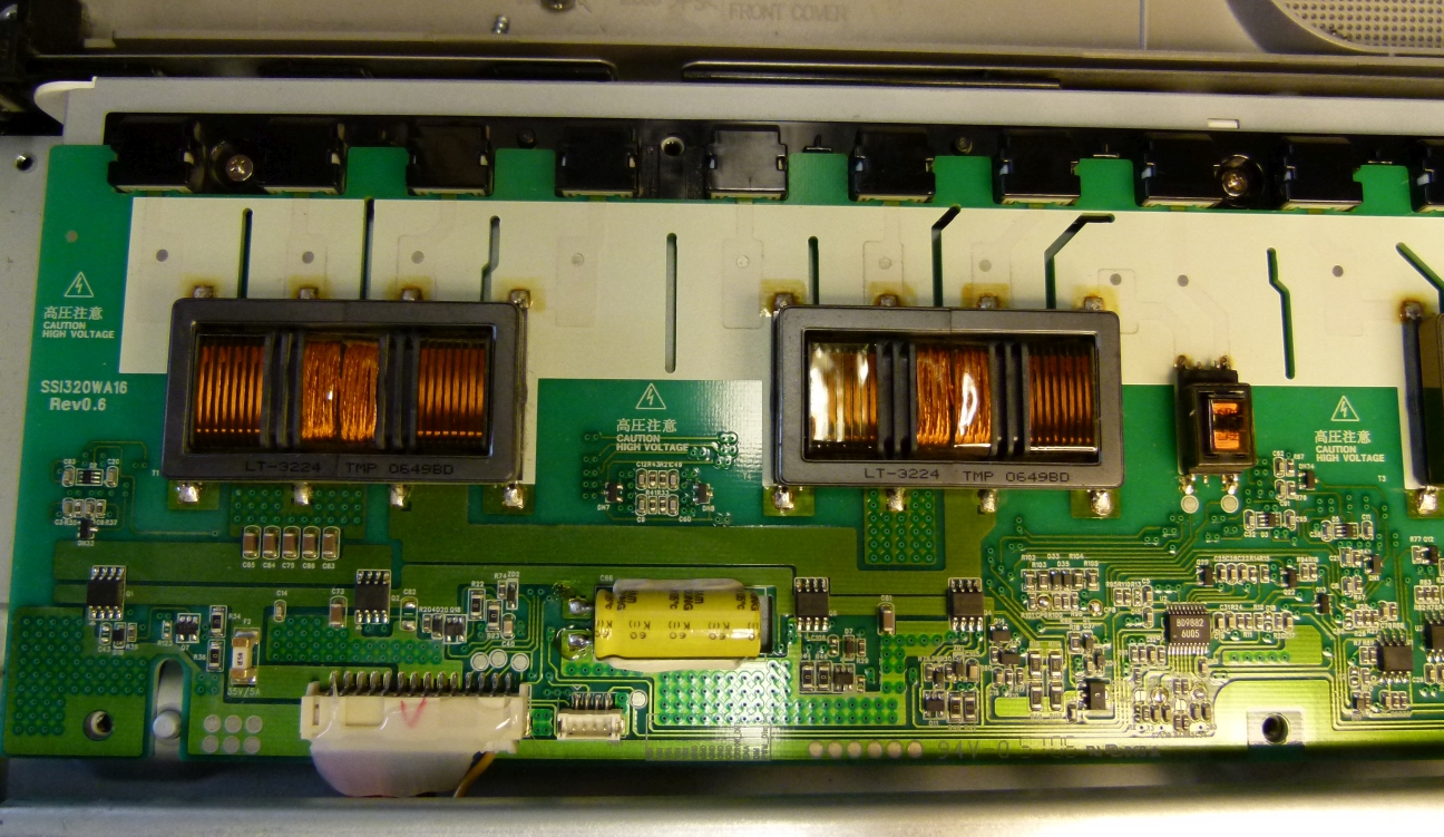

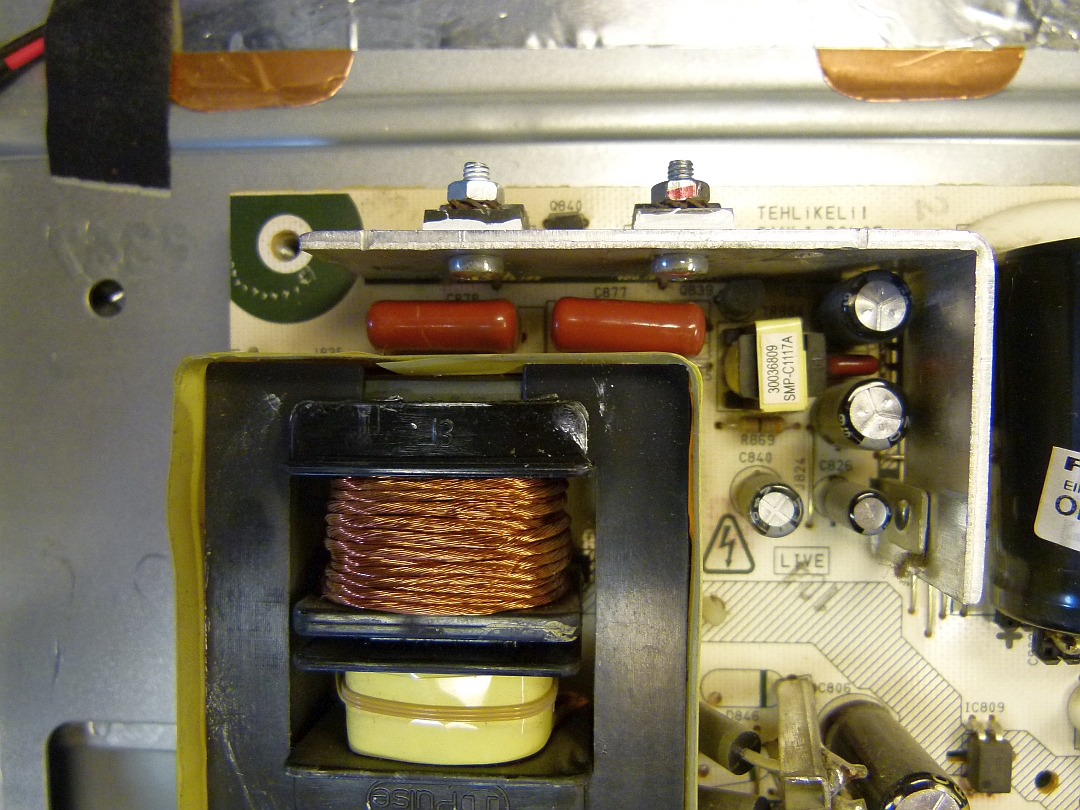

    I had this TV for repair from a family member a few years ago with a no picture fault. It seemed OK otherwise and sound was present. I changed a few bulging capacitors on the PSU board with no fix and it turned out to be a blown SMD fuse on the TCON board (CP101). It has arrived some years later with the same fault, so off I went to the same place, but the two TCON SMD fuses (CP101/CP228) are OK.
    Looking more carefully there is no backlight but the picture is there. There does not appear to be any brief backlight flash at switch on so I'm fairly sure there is no backlight at any time. Tuning, sound and standby operation are all normal.

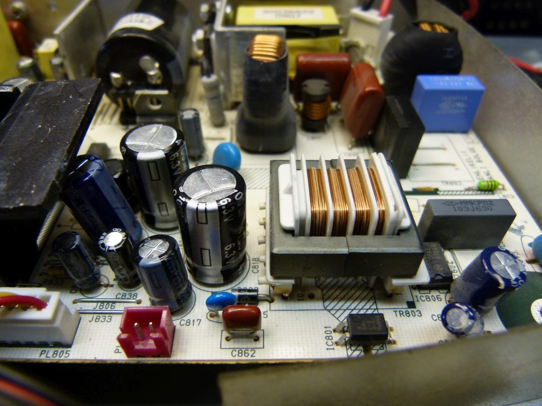

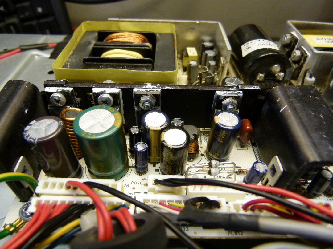

    - I've changed more caps that have bulged since last time (C851, C812, C818)
    - The 24V rail is steady at 24.6V when on and present on the inverter board
    - BL_ON/OFF on PL802 pin 12 : 0V standby and 3.3V TV on and present on the inverter board
    - A_DIM on PL802 pin 11 : 0V standby and 2.3V TV on
    - A/D_DIM_SEL on PL802 pin 9 : No connection
    - D_DIM on PL802 pin 10 : No connection
    - The big cap (C819) has 345V in standby and 390V TV on, which I have read is correct
    - C877 + C878 get mentioned a lot but I have not changed (yet) - they measure as 15n1 and 14n6 out of circuit

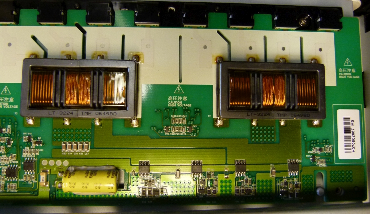

    The panel is a Samsung LTA320WT-L16 with SS1320WA16 inverted board
    - Nothing appears burnt on inverter board. Slight irregular heat (?) ticking when TV on - may be normal
    - Two SMD fuses (5A/35V) on inverter board intact. 24.6V present.
    - Two Samsung electrolytic caps on inverter board look OK
    - Transformer LT-3224 (x4) have 1K5 secondary resistance, all the same
    - Transformer primaries all have same voltages when TV on, not sure of pin-out
    - Nothing appears burnt at the CCFL sockets (have had the panel apart)
    Any further pointers would be appreciated - thanks.

    You have the PFC voltage (390V) so it looks like the power supply is fine.
    I suspect a tube or inverter fault.
    Measure all the inverter transformers both primary and secondary resistance (set off) and give the results.

        Re: Vestel MB22+17PW15-9 (Goodmans GTVL32W26HDF)
        "There does not appear to be any brief backlight flash at switch on"
        I would say you have bad inverter board, if you have bad lamp/s the inverter should still fire the startup Voltage first (you will see the lamps flash on) and then goes into shutdown if bad lamp/s is detected but you are not seeing that.
        It is SAMSUNG Inverter board which is known for being bad, reece fixed some of these with bad PWM IC.

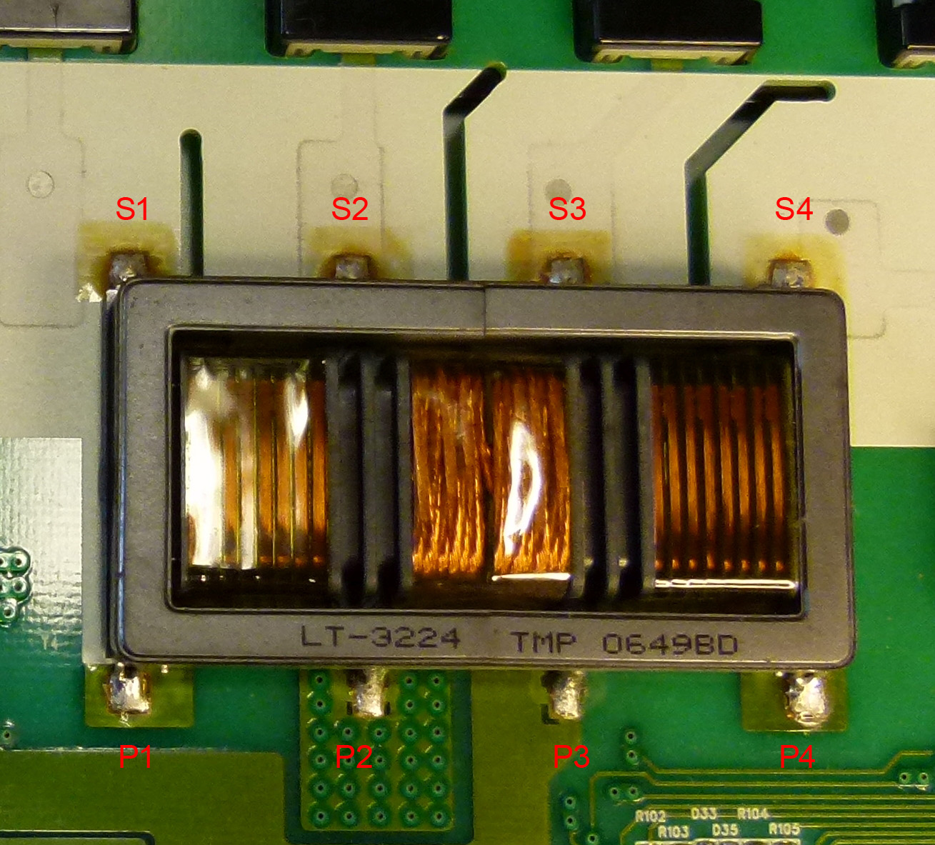

          See new picture for pins.
          All measurements taken with transformers in circuit.
          (P1+P4 don't appear to be connected - mounting only??)
          P2-P3 : 0R dead short on all 4 transformers
          S1-S2 : 1K45 on all 4 transformers except top transformer=1K51
          S3-S4 : 1K45 on all 4 transformers except top transformer=1K51
          The additional small transformer shown in original picture Inverter-1 has primary of 30R and secondary of 32R, again mounted in circuit.
          Thanks for your help.

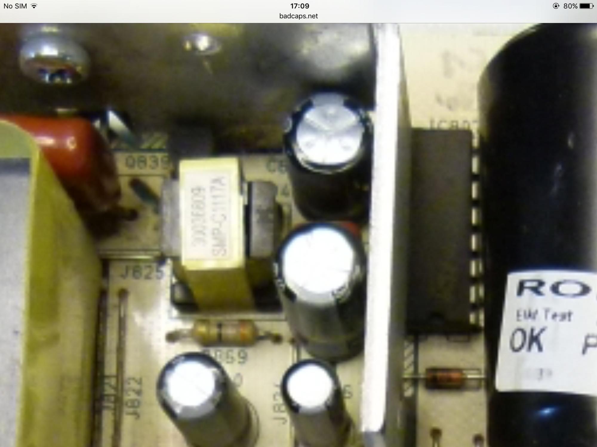

                    Also there is two caps on the Psu I urge you to replace, two 100uf 50v caps next to the top heatsink replace them as they commonly fail which will cause issues in that supply.

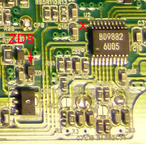

                      A few more observations. Another thread refers to a very similar Samsung inverter board:
                      www.badcaps.net/forum/showthread.php?t=11182
                      Controller chip BD9882 seems hard to find in the UK but can be had for USD1.46 at Aliexpress [with a 4 week+ wait!].
                      I measured a few voltages on my BD9882:
                      Pin 11 (standby): 2.2V (if over 1.8V backlight should be on,so correct)
                      Pin 13 (regulator out): 3.1V (same as in other thread)
                      Pin 12 (under/over voltage): 1.54V (OK I think)
                      Pin 20 (Vcc): 4.5V (low?? Datasheet shows 5-14V range,other thread=9.1V)
                      The low Vcc could be an issue or faulty BD9882 dragging it down? It is hard to be sure, but I think the Vcc trace goes to a GY644 (the marking has not shown up at all on the picture attached). I cannot find out anything about GY644 but maybe a regulator.
                      Your comment on the two 100uF/50V caps noted for later (C834/C835), but I don't think you were meaning this to be a possible cause to the no backlight fault? These appear to be labelled 33uF/50V on my circuit diagram but are 100uF on the board, as you rightly say.

                      > budm + CapLeaker
                      Just to be sure I've powered up the TV from standby in complete darkness and there is definitely no initial backlight flash.
                      Thanks to all.
                      Rich

                        That control IC is bad or there is an issue around it.
                            Final info on this...
                            I cut the trace to pin 20 (Vcc) of the control IC leaving that pin isolated (see X on new pic). The voltage on the feed (left of X) then jumped up to just over 9V which is almost the 9.1V in the other thread I mentioned earlier.
                            Zener ZD8 is marked F4 which is also 9.1V so this is likely to be the correct supply voltage for the IC. The larger item below the Zener that I previously suggested was a regulator has a 'Q' board reference so more likely a transistor.
                            I'll decide whether to go with an IC or a board in the next day or two, though I suspect I don't have the eyesight and equipment to change the IC or the patience to wait for one to arrive!
                            Thanks again - will report back with final status, whenever that may be.
