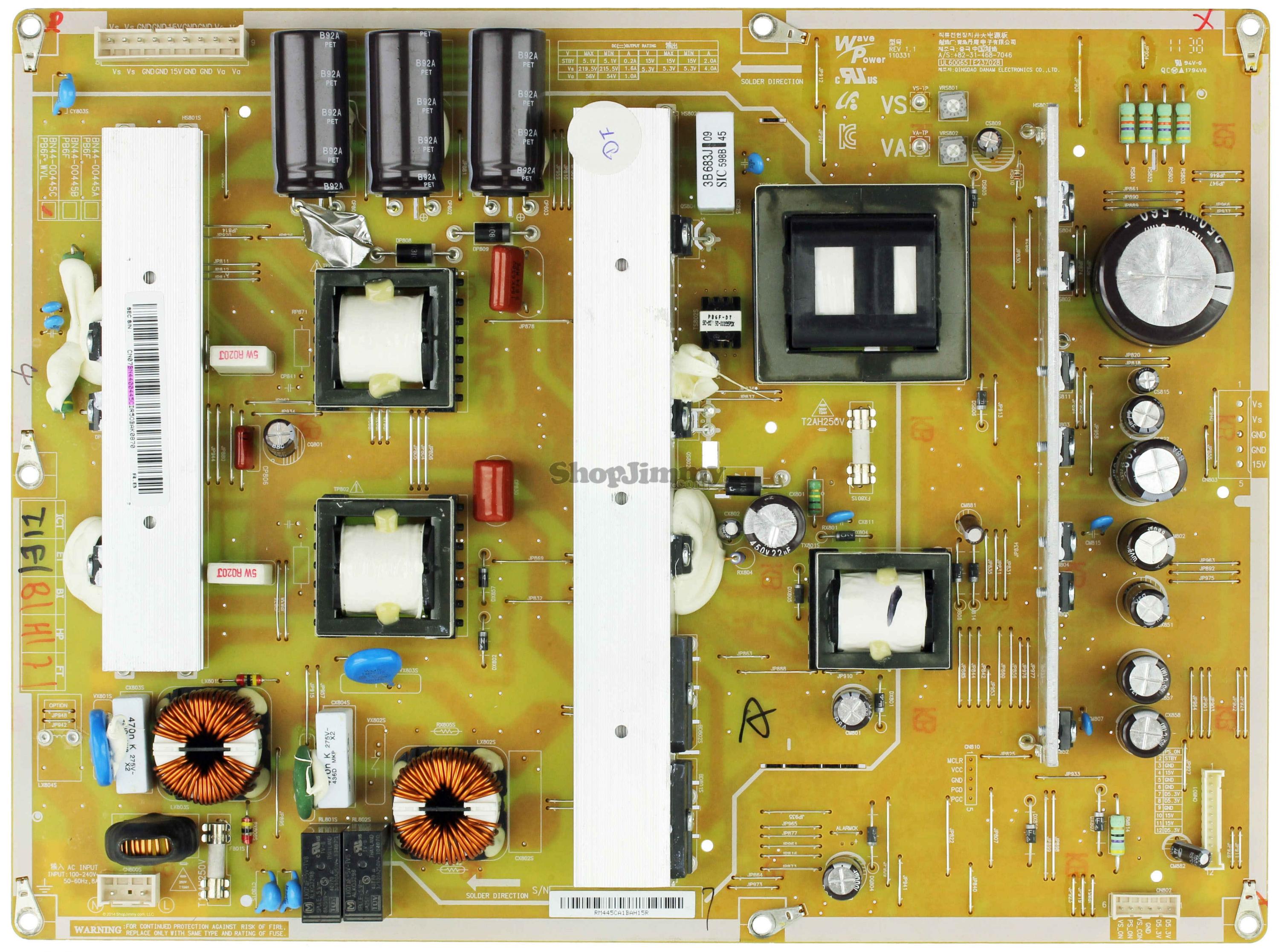

    I have a Samsung PN59D530A3F plasma tv that doesn't power up. All it does is clicks. I removed all connections except the main board and it still clicks. I don't see any VA or VS. I want to test the power supply outside the TV.
    I jumped the ps_on pin to ground. The power supply clicks and stays on, but no voltages. I havent jumped a resistor to VS_ON to test VS since I want to test the main DC voltage. Am I doing this right?
    I get 160V at main filter caps. Is there a PFC circuit on this power supply?
    Part number is BN44-00445C.

                Here is a pic of the entire TV. I am 99% sure it is the p/s. I removed all boards and shorted PS_ON pin to GND to turn the power supply on. All I get is the standby voltage and nothing else. I also put a resistor on the VS_ON and input 4V to turn on the VA and VS. I still got no VA or VS. I only get 160V on the filter caps, I should be around 400V at full on mode, but it stays at 160V, or standby voltage.
                Here is a pic of the TV boards.
                  Re: Forcing on Power Supply with PS_ON
                  So it does not mean it needs 24VDC to run, so what is the P/N? 15VDC for VCC is about right but we need the spec sheet of the IC to verify. You can possibly have bad PFC diode.
                  Right now when GND the PS-ON (LO = ON for this power supply board) pin you should have close to 400VDC on the main filter cap, you need to get that PFC working first.

                    Part number is R2A20118ASPW0, see data sheet below. I wish a schematic was available for the board so I can diagnose easier. Obviously the problem is on the primary side so I will focus on it when troubleshooting.
                    http://html.alldatasheet.com/html-pd...0118ASPW0.html
                      15V VCC is fine, per spec. sheet minimum start Voltage is 10.5 (typ.), it will go into low Voltage shutdown if VCC is 9.3V or lower so Hysteresis Voltage is 1.2V.
                      Check PFC Diode DP809, 809 to see if they conduct both directions.

                                    Does anyone know what area creates the PFC voltage? It would be so much easier with a schematic.
                                      So right now the PFC controller is getting the VCC to run, the PFC diodes are not shorted, it they are shorted then all you will get is 160VDC on the cap and no boosted Voltage.
                                      So it is either bad PFC IC due to no drive signals to drive those two PFC Power MOSFET, r bad MOFETs which I doubt it very much to have both of them failed at the same time and most of the time they shorted out and will cause the main AC fuse to blow which is not you case. Or the Voltage at pin 3 BO (Brown Out) detection pin is not getting enough Voltage so it thing the incoming AC is too low so the PFC stays in the shutdown mode.
                                      Check the Voltage on that pin 3 to see what you have, it is usually connected to high resistance resistors which often fail.
                                      We need really good closed up pictures around that PFC IC.
                                      BTW, the components with xxP are the components used in the PFC circuit, for example: dP809, icP801.

                                        The voltage is 4.5V on pin 3 of the PFC controller IC. Here are some pics of the PFC circuit.
