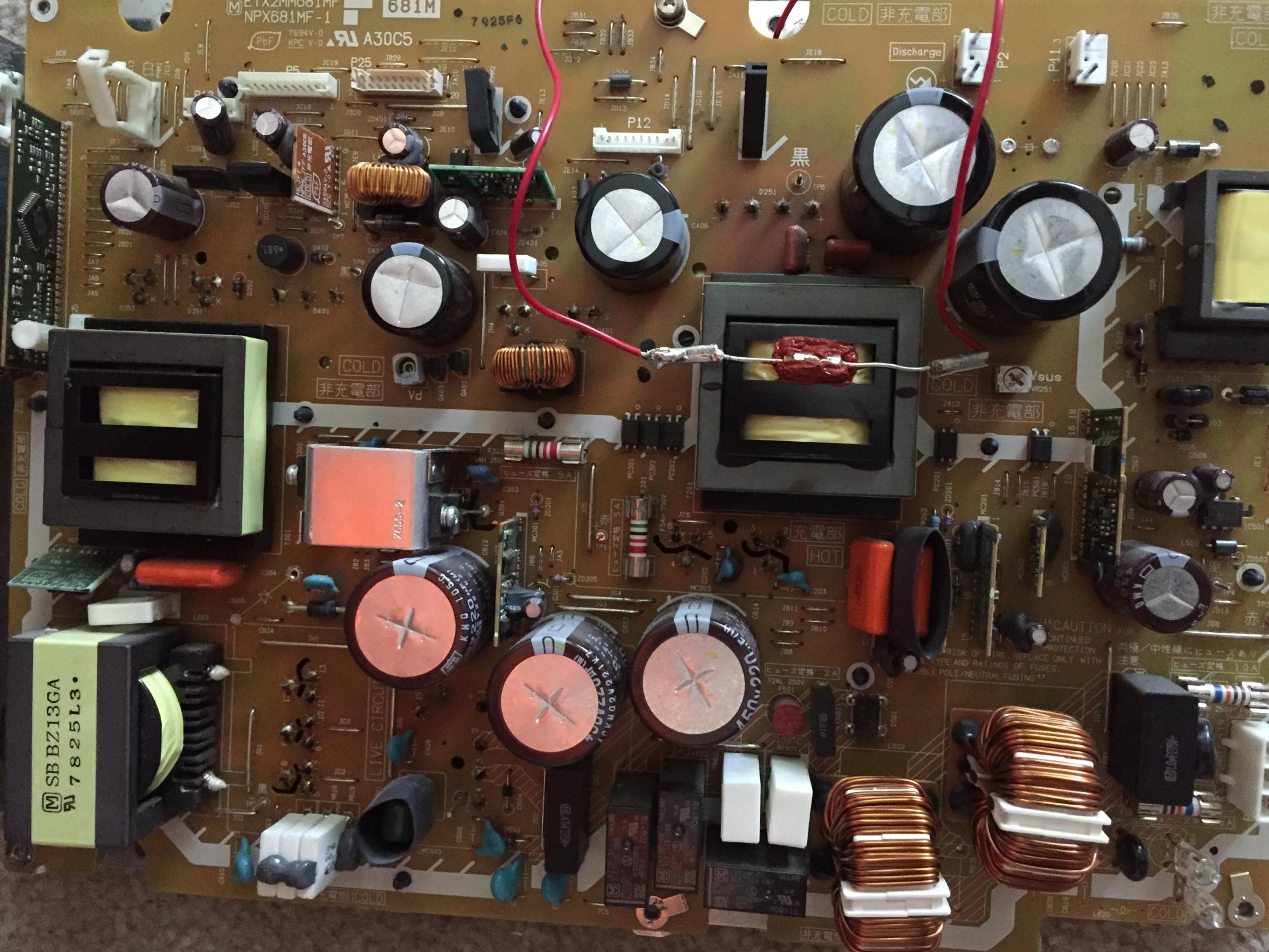

    I got this th-42pz77u for $20. I took the back off and saw this on the psu.
    I'm not sure what it is but the bets on it say TG128, 15A 250V. Is it a fuse?
    It is soldered to the back of the transformer it is stuck to.
    What is the reason for it.
    I had another psu, so I used it and the tv was good.
    Should I scrap this? I was afraid to power on the tv with this in it.

    its a thermal fuse the one inside the transformer is probably blown hence been by passed like that there is a youtube video showing how to repair it properly

      It's a 15A AXIAL TYPE THERMAL CUTOFF

        Thanks guys. So it was probably ok?

          did the power supply work? if so yes may of been ok but the repair could of been done a lot tidier etc.

            It seems a very high value amperage thermal fuse to find in a set.

              I don't know if it worked. Seller said the tv had 7 blinks. I took the back off and found the sc connector discontented from this psu.
              When I saw that thermal fuse, not knowing if it was safe, I swapped my other psu in, plugged the sc in and the tv was fine.
              I'll just keep this to scavenge parts from. Starting to accumulate a lot of scrap boards. Lol

                  The one he fits in the video (6 mins in) is 150 degress half a amp but he does say the amps dosnt matter so not sure myself.

                    I see where they are comming from. It's really only being used as a temperature circuit breaker. If the transformer heats up due to a short circuit winding or excessive load current then it open circuits.
