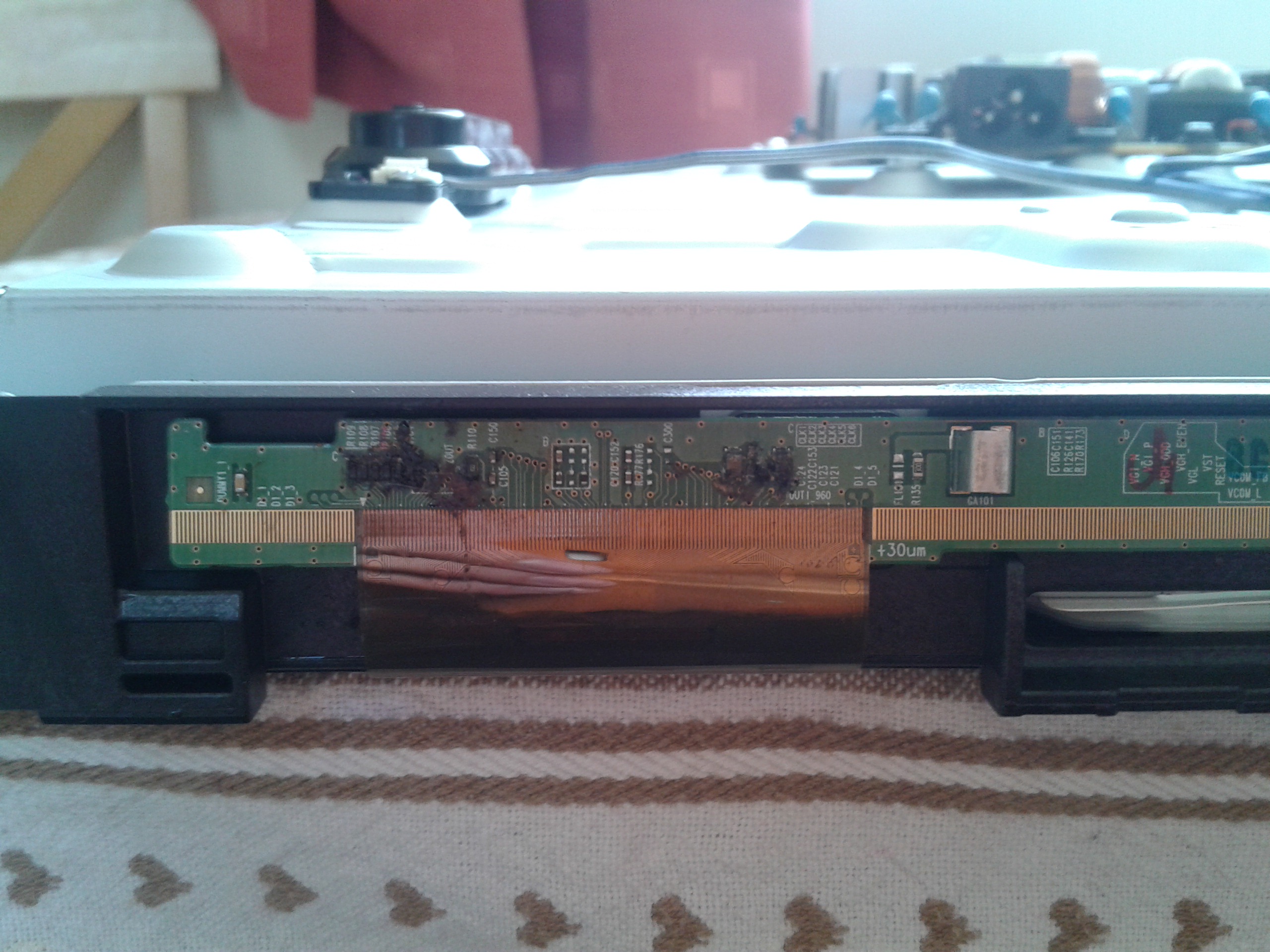

    you are not going to repair t-con right ? then change it from good source working one.
      Re: LG 42ln578v-ze problems
      You can try new T-CON board.
      You can also check some of the Voltages at these test points:
      VCC
      VDD
      VCC18
      VGH
      VGL
      HVDD

        checked voltages this morning, voltages are
        VCC - 3.3v
        VDD - 0v
        VCC18 - 0v
        VGH - 0v
        VGL - 0v
        HVDD - 0v

          Check voltages again this time with the ribbon disconnected that gave you the lines on the screen. see if they come up? but looking like short on the driver board to panel

            ok so checked the t-con card again i was getting the same with both ribbon cables disconnected one at a time but when they are both disconnected i get,
            VCC - 3.3v
            VDD - 15v
            VCC18 - 1.8v
            VGH - 28v
            VGL - 5v
            HVDD - 8v

              It does look like there's a panel problem.

                  Before you move on take the outside screen surround off, and check driver boards for damage, you could still find a fix.

                    ok ill have a look, what sortr of thing am i looking for? iv never gone that deep into a tv befor

                      You need to strip the fram off the Lcd glass whilst being VERY careful, then get us an image of the boards that are bonded to the Lcd screen please.

                          tv done about 20 tv's just replacing caps, power boards, t-con card im only really just starting to get into it so learning alot.
                          think iv found the problem.....

                            go deep to the panel taps and check if there water damage or burn before you go to change T-CON
                            So that's the problem.

                              looks like someone has over done the cleaning of the screen , but all other parts should be good the T.Con tested fine with the ribbons disconnected so the driver board damage was just loading T.Con down. Good luck and keep us updated how you get on with your next repair

                                Ahh dam panel is done for then common on these, people are not careful when cleaning them
