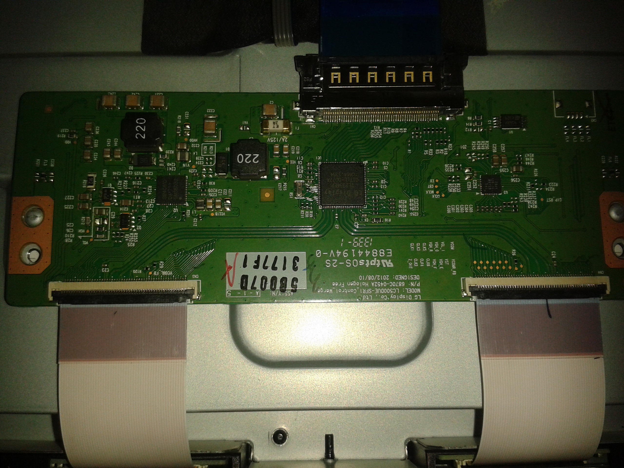

    Im starting up my own electronics repair business fixing tv, laptops and such like on the side as well as working as an electrician's mate, im not advertising im just asking for help please, as iv been handed a tv and im a little stumped.
    The TV comes on fine but i have no sound or picture, the back light comes on!
    Iv check all the output V on the main board and there fine, power going to where it should be.
    So im thinking its the T-con board but i was under the impression that if thats the case the TV go's into like a self protect mode and wont turn on.
    Any help would be grate thanks

        Look on the T-CON Bd and see if you can find the Fuse. Check if you have 5-12Vdc on each side of the Fuse.
          Re: LG 42ln578v-ze problems
          Pictures of the board, T-CON board? 12VDC on the T-CON fuse.

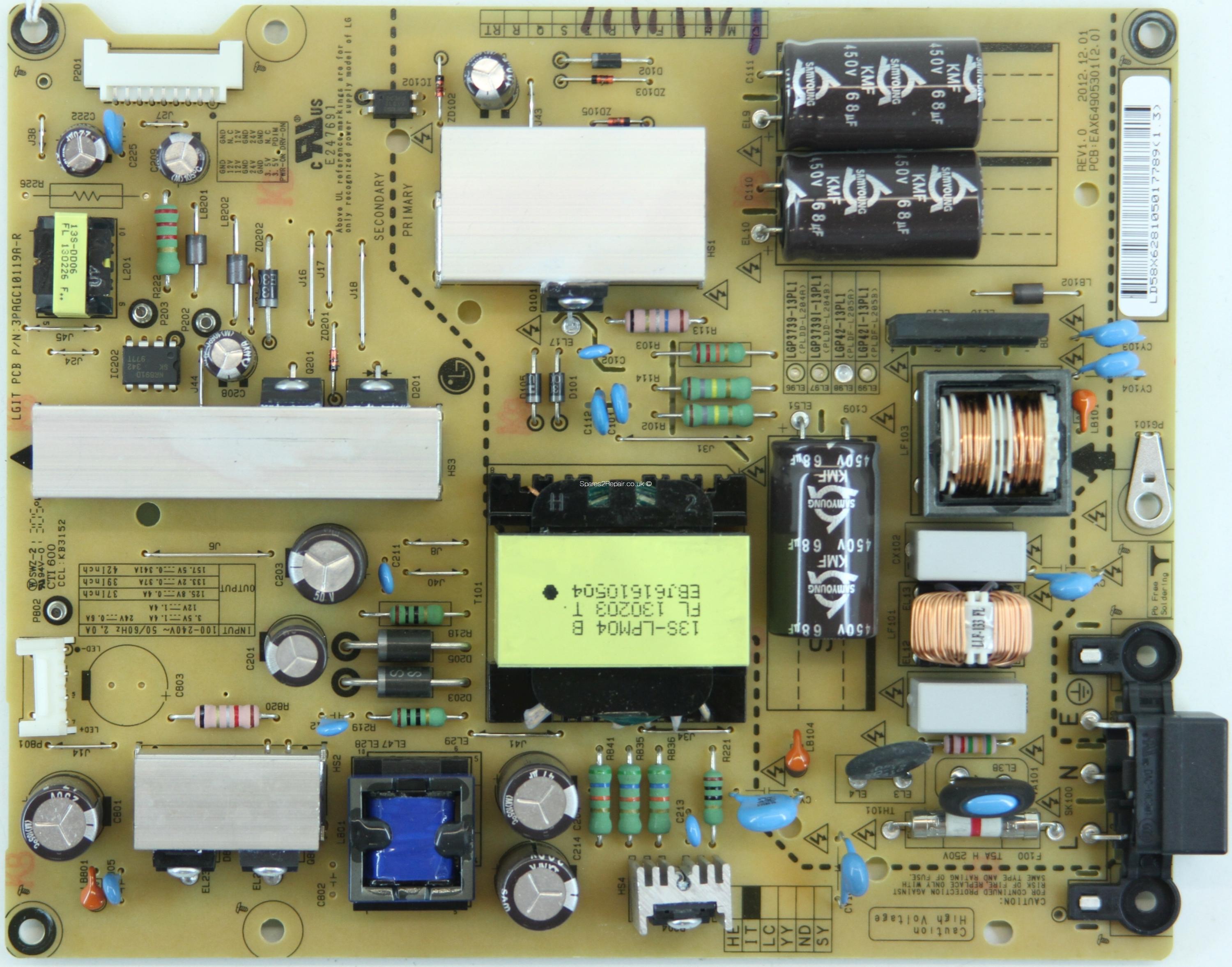

            On P201 do you have the following voltages
            24V
            12V
            3.5V
            Pwr_ON = ??
            DRV_ON = ??
            PDIM =? ?
              yes voltage at both sides of the fuse
              https://www.badcaps.net/forum/attach...1&d=1471375104
                  24V
                  12V
                  3.5V
                  Pwr_ON = ??
                  DRV_ON = ??
                  PDIM =? ?
                  and what voltage do you have at the led output connector P801 which says 157V on the board for 42" set
                  P201 yes all voltages are read right
                  P801 is only 70v but back light is on and working fine
                            Using a bright light can you see a picture or the menu on the screen if you look very carefully.
                            back light is working i can see the light from the back holes in the tv
                              So you have SOUND, you have backlights but no pictures on the screen, 12V is present on the SMD fuse of the T-CON board.
                              So next thing to do is to have one ribbon cable between the T-CON and the LCD panel connected one at a time to see what you get.

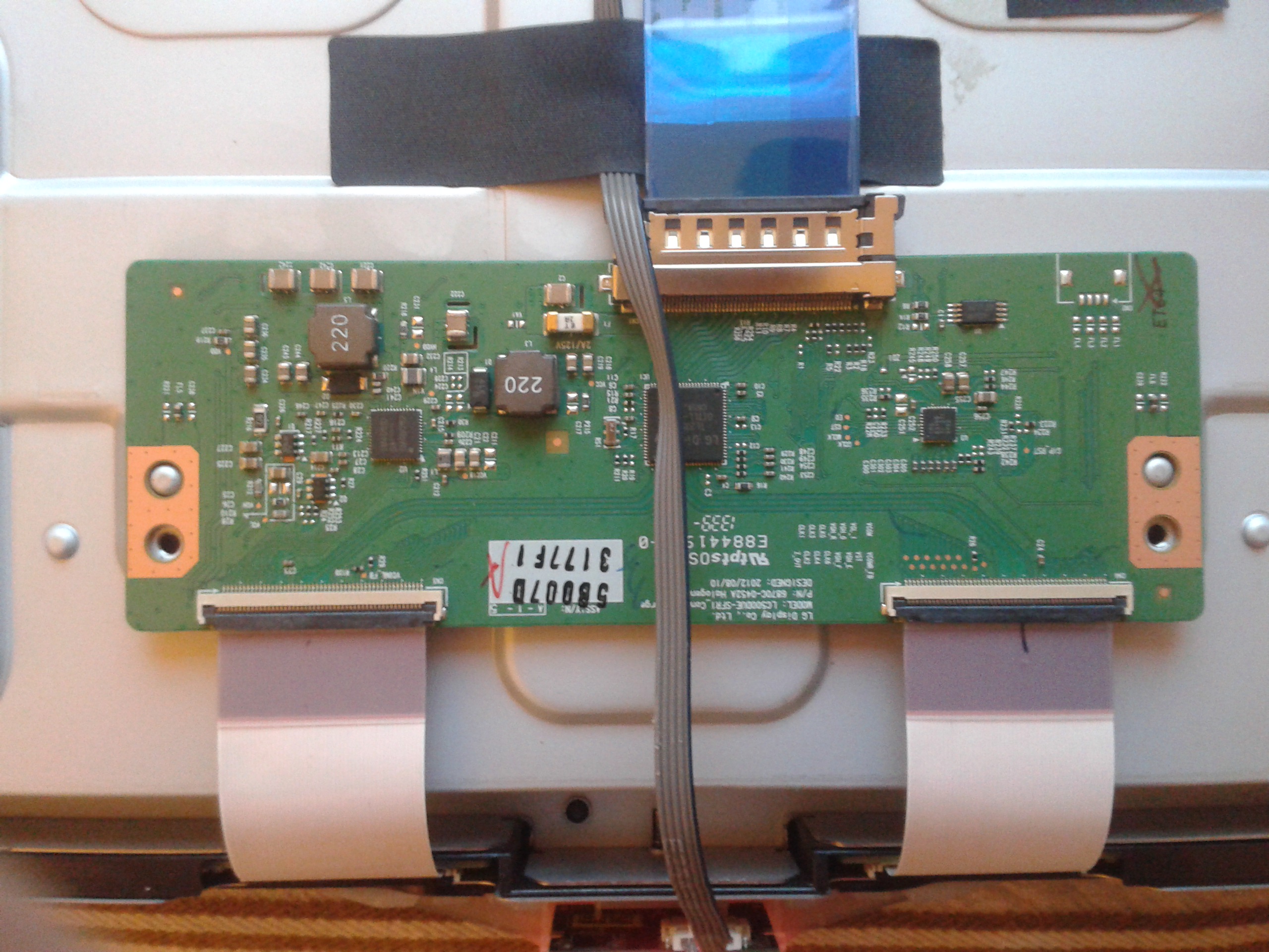

                                  ok so iv disconnected each ribbon cable
                                  (looking at the back of the TV)
                                  right ribbon disconnected still blank screen
                                  left ribbon disconnected half screen white with other half black and purple lines
                                  • Diah
                                    • Feb 2013
                                    • 6365
                                    go deep to the panel taps and check if there water damage or burn before you go to change T-CON
                                      If you look at the T-CON board, you can see bare copper pads for test points that you need to test some DCV readings, the picture is not clear enough for me to read the label for each one of those test points.
                                        is that any better
                                        no burn or water damage
