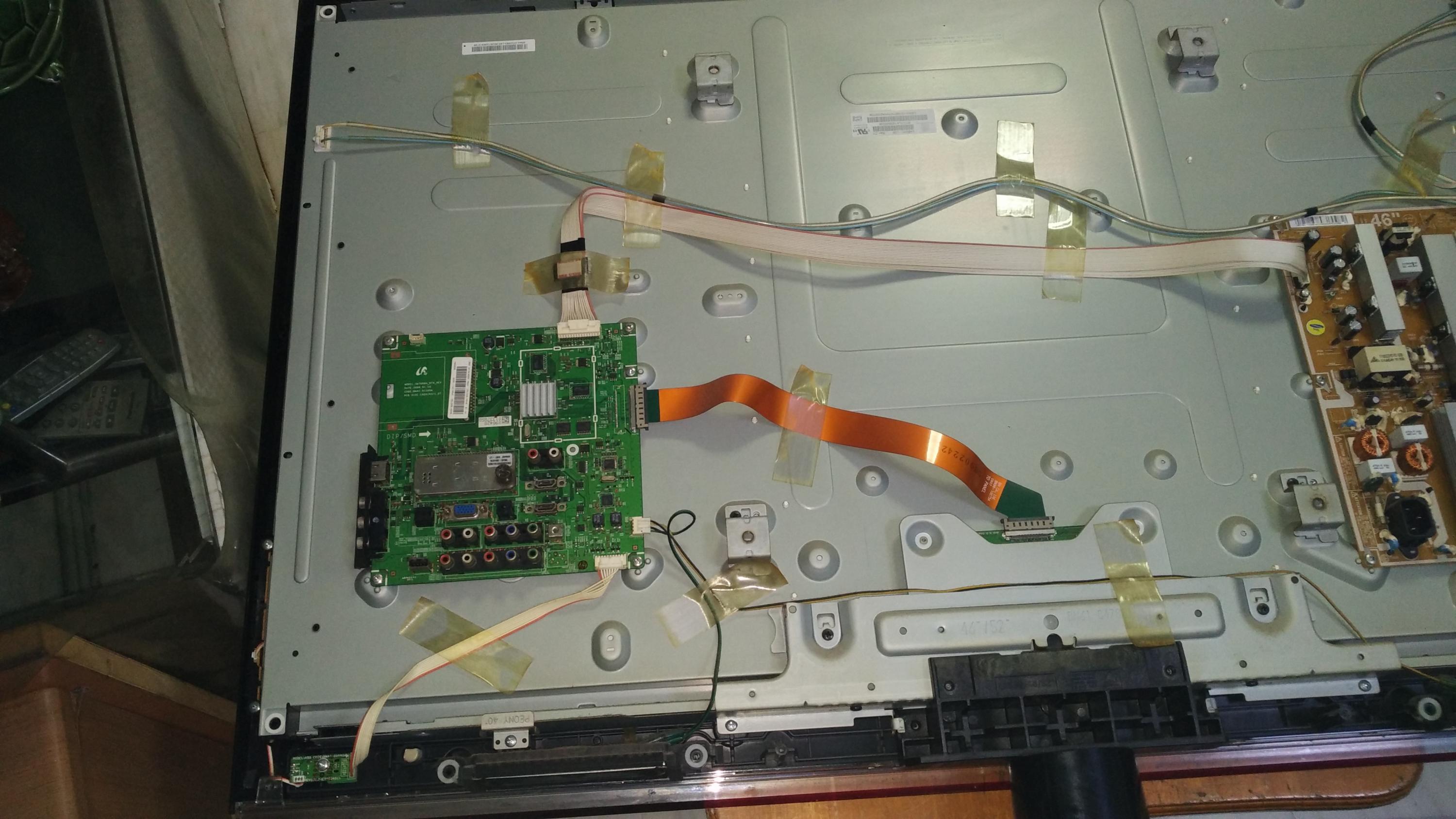

    Samsung LA46B530 4 blinks
    Need some help from you guys here.
    TV only show power led lights 4 blinks when switch on. No video or sound.
    TV model is Samsung LA46B530

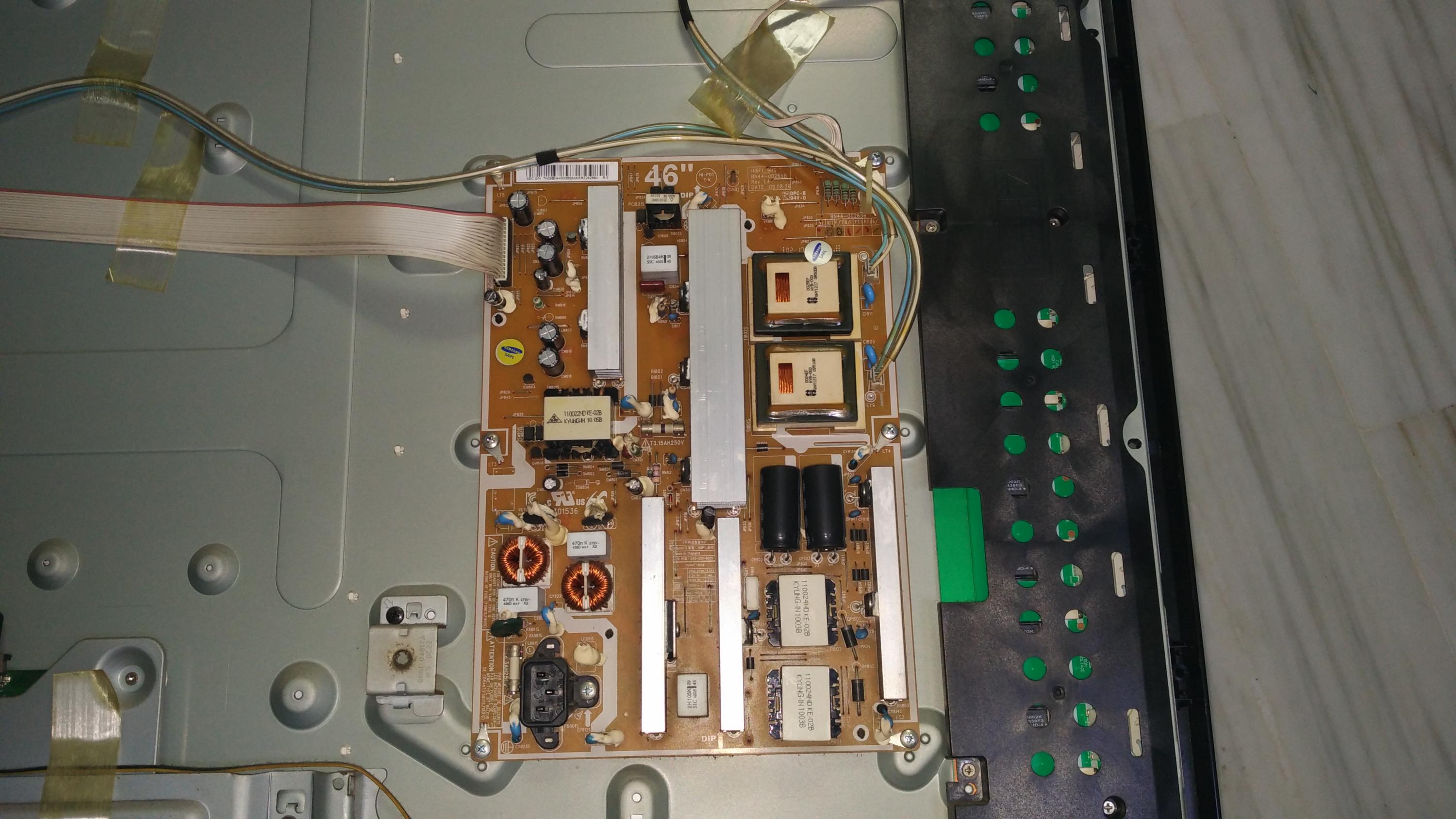

    PS board is BN44-00265b
    When plugged into power but not switched ON
    5v_det : 0v
    inv-on : 5v
    13v : 0v
    5.1v : 5v
    13v : 0v
    sb : 5v
    ps : 0v
    12v : 0v
    FD : 0v
    LD : 0v
    when switched ON
    5v_det : 0v
    inv-on : 0v
    13v : 12v
    5.1v : 0v
    13v : 12v
    sb : 5v
    ps : 0v
    12v : 12v
    FD : 0v
    LD : 12v
    any advice is appreciated. thanks

    Re: Samsung LA46B530 4 blinks
    The white fuse on the middle of the board good?
    Are you sure that you count and check the pin of the connector correctly?
    You are showing PS (PS-ON) of 0V so there is no way you can have the Switched 13V when TV is turned on. Are you sure it is not 0.7V when TV is ON?
    The INV-ON is also not right, it should be <1V when TV is OFF, >2V when TV is ON.
    I also do not see the PWM reading.
    The Power supply-Inverter board combo has pull-up resistors for doing the self test, so if you disconnect the cable between the power supply and the main board, the backlights should come on and stay on the minute the plug the TV into the outlet.

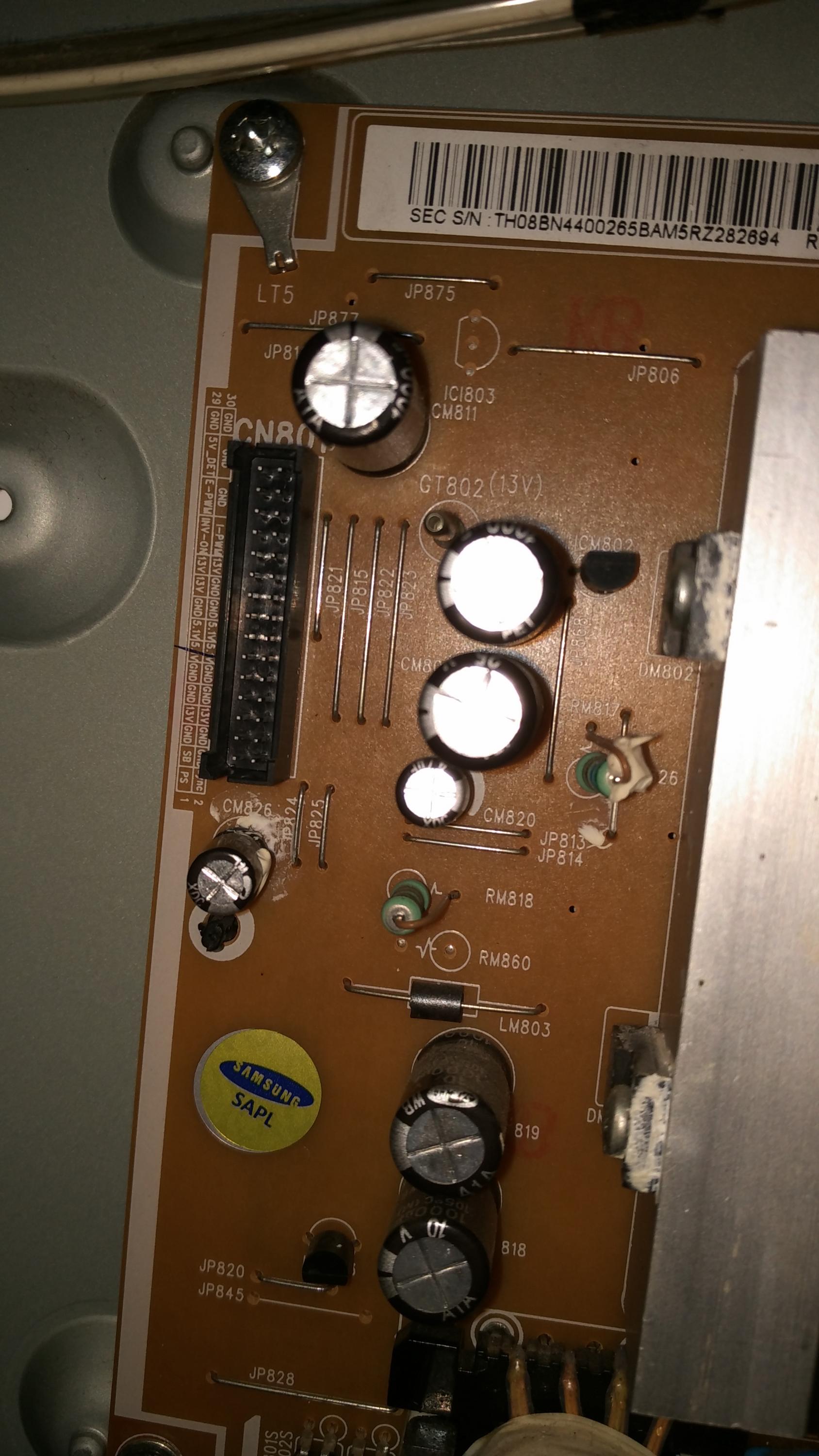

        On this power supply/inverter board, 0.7V is = HIGH and it is the correct Voltage for PS-ON to turn on the power supply, that is why you are getting the switched 13V, 0V = OFF for this board, so your PS-ON is OK, no need to jump the PS-ON with the resistor since the resistor is already in place.
        So now you need to check the INV_ON pin to see what DCV you have when it is not connected to the main board.
        You also need to check the DCV between the two legs of the main cap to see if you have close to 400VDC, you will do all of this without having the cable between the power supply board and the main board in place, but you must have the balancer board connected still.

            The backlights should be on right now when you do not have the cable connected to the main board.
            If you look at the diagram page 1 you will see pull-up resistor RI856 for the INV_ON pin, the output side of RI856 is connected to the RI874, the output of RI874 is connected to the ENA (ENABLE) pin 7 of the Inverter PWM ICI801, there is also a switched transistor QI818 to ground out the ENA signal if the Boosted Voltage from the PFC circuit is too low (your is OK at this point because you are getting 393VDC).
            So right now you need to find out if you do have >2.5V on the ENA pin of the ICI801 or not.
            You also need to check the DC Blocker/coupling cap CI804 (0.68uF 500V) to make sure it is OK (no bulging, the capacitance is still corect, etc.).

                      OK, I just read the SONY training manual (SONY/SAMSUNG uses the same topology for the inverter/balancer circuit).
                      The LD is normally HIGH (>11VDC), the LD will go low if not ALL the LAMPS are ON when HIGH Voltage from the Inverter transformer is present, if the high Voltage is not present then there will be no error signal from the Balancer transformer to produce an output to trip the comparator circuit that will make the LD line goes low.
                      So what we are seeing right now at the LD pin is normal, something else in the inverter section is bad.
                      So we need to find out if the ICI801 (LX6508) is getting the 12VDC on Vin pin 1 to run or nor and if there is any activities at the drive output pins 13, 15. OP will need scope for testing.
                      Also need to check to see if there is any activity in the GATE drive transformer TI8088 circuit, check CI884 capacitance.
                      The CI804 capacitance still need to be verify but OP does not have the tool to test capacitance.
                      At this point needs to get new board.
