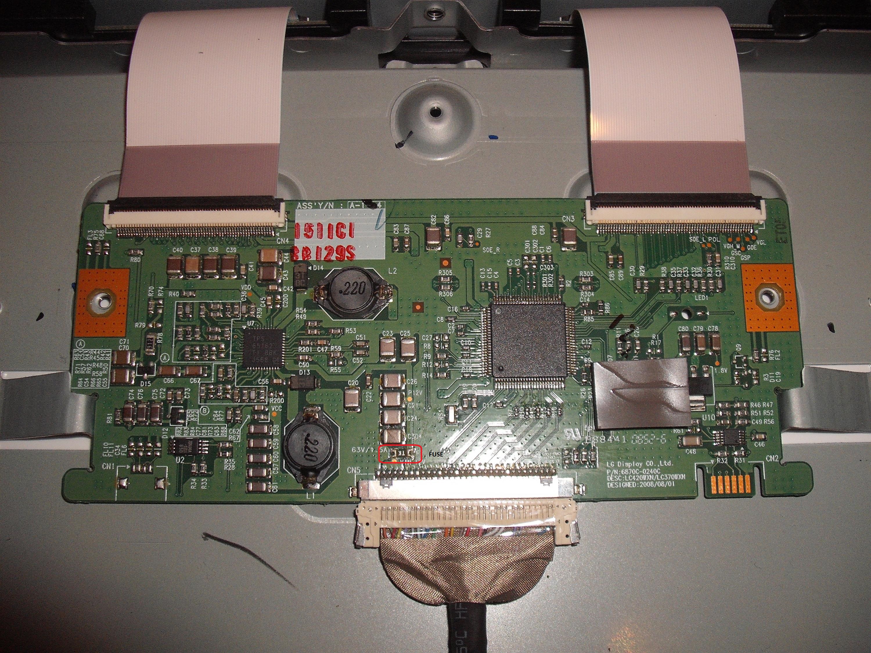

    Fuse marked TK as shown

      The side I took off was clear of the lines but the side still connected had the lines. And vise versa when the other side was removed the same thing happened just different sides.
        Oh I see it now. So to test- I hook black to ground and and positive to either side of fuse?
        • dick_barton
          • Aug 2015
          • 6643
          • Wales
          Re: LG 37lg30-ud Screen Has only vertical lines of color?
          That's correct.
          However it does look like the panel is at fault as suggested earlier.
              does sound like a lcd panel fault now you have done all of the tests
                +1 At this point I must agree.
