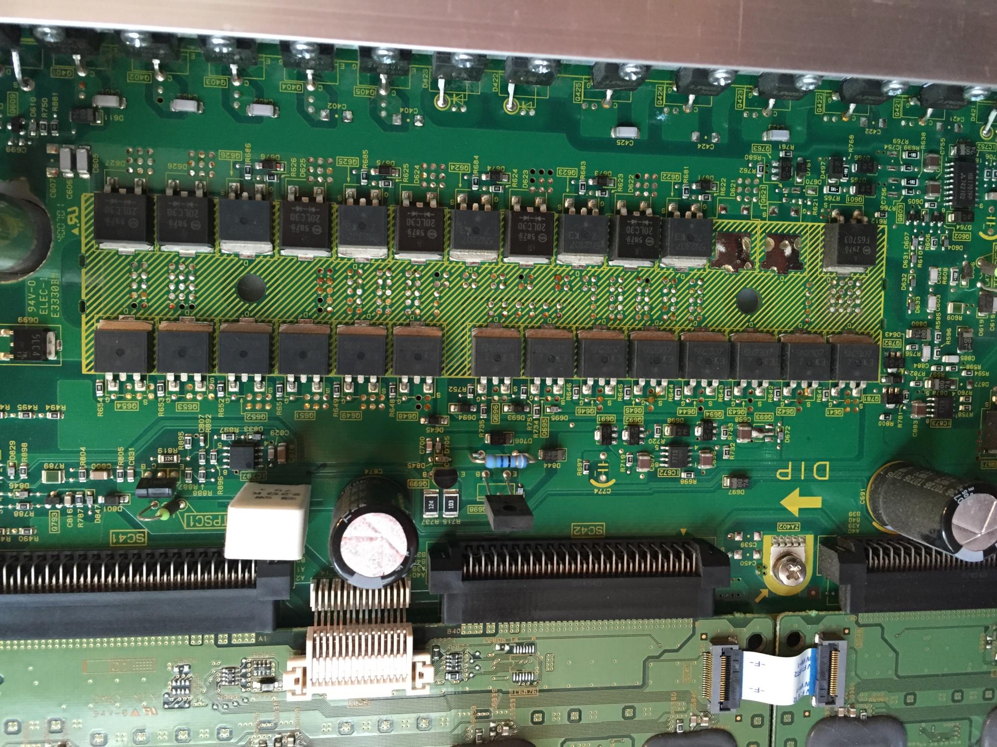

I picked this tv up today with the 7 blink fault.
The sc board is TNPA4250. When I disconnect SC2 I still get 7 blinks.
Connect SC2, disconnect the 2 buffers, 7 blinks.
I check the 2N5307 transistors on the SC board and 6 of them read shorted (meter beeps).
They ones that seem shorted are the top 5 on the left.
Does this sound like a bad SC board?
Service manual says 7 blinks could be SC, SU, SD or D board.
Both of the board LEDs for the SC and the SS are lit, which on other Panasonic models usually indicate they are ok.
Any advice?
