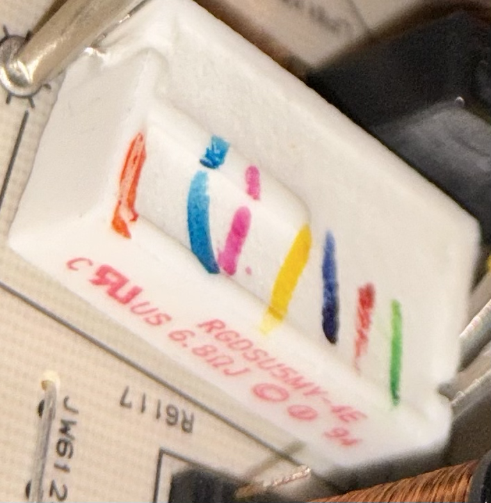

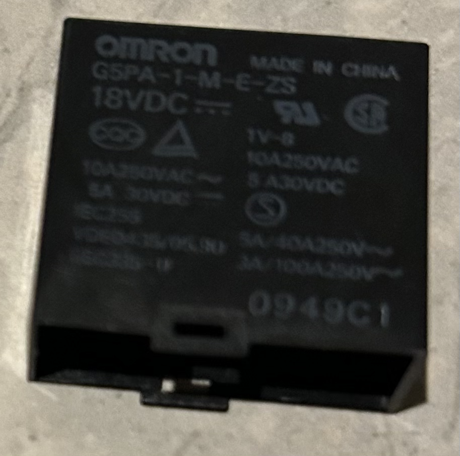

                                  • Tomcat_STL
                                    • Oct 2023
                                    • 2
                                    #37
                                    Re: Sony KDL-46VE5 - no power, no standby or LED
                                    Originally posted by gintama
                                    I suspect the power supply but no time to dissect it.
                                    My 2009 KDL-46W5150 crapped out just as I was trying to re-home it. No Power, No click, No nothing.
                                    I want to thank you for the insight to fix the TV. Mine has an APS-247 Power Supply. Sure enough, the 6.8ohm cement in-rush resistor was open. I had a 50W 6.0ohm power resistor which I jumpered across the open one. The rest of the TV is fine.
                                    Neither the exact relay or resistor appear to be available. Therefore, I bought a new Power board for about $35. Waiting on it to arrive.
                                    Thanks Again to you & budm!
                                      The open resistor on my APS-247 Power Board.
                                      and the offending relay..
