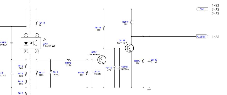

Re: Toshiba 46rv350u No backlight, No picture but has sound
If there is 0V across R8141 then either the opto is not being switched on or it is open circuit or you do not have the 5V supply to that circuit?
