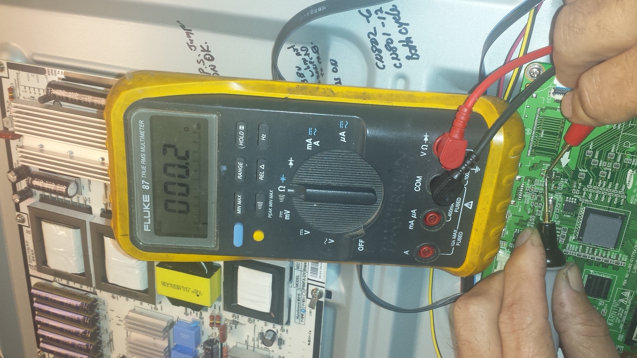

    PN59D6500FXZA Fast Track info incorrect
    To test the BN96-16531A Logic Main PCB, the PDF tells you to short the highest two pins. If you look and ohm check they are shorted together because they are Gnd and they both measure 0 ohms to gnd. With that said I should short the bottom two pins?
    Pins 2 to 4? I have disconnected the cable to the M.B.

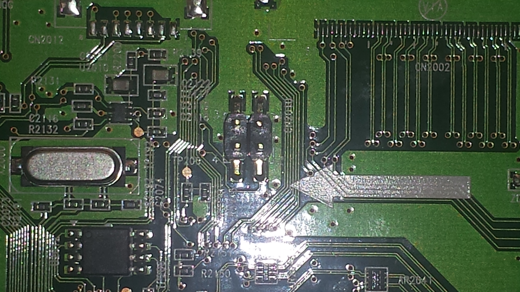

    Re: PN59D6500FXZA Fast Track info incorrect
    Can we see the fast track PDF? You are correct that those two pins on the top row as shown in the picture is tied to GND plane.
      I jumpered pins 2 to 4. CN801 pin 1 PS_On was jumpered to pin 3 gnd.
      All P.S. voltages were good. Vs 217vdc, Va 55 vdc, Vsc-193 vdc and Ve 93 vdc.
      No Self Test Pattern? I would have thought that if all the voltages were good and the Logic board jumpered with the Control cable removed from the M.B. it should have worked. The Samsung video tell you to disconnect the the cable the PDF does not.
      Any Ideas where I went wrong?
          The words says top two the pic shows top to bottom on the left side of the four pins
            Btw for test patters its shorting pins 3 and 4
              I put a Computer M.B. jumper across pins 3 and 4 still no test patterns. Control boars led 2000 blinks every second not indicating a problem with the Y or X boards. I am at a loss. Now.
                On this TV the test patterns will work when the LVDS ribbon cable is connected to M.B. even though no power to it because I jumped the P.S. on. If the cable is disconnected there is no test patterns.
                Opposite of most instructions.
