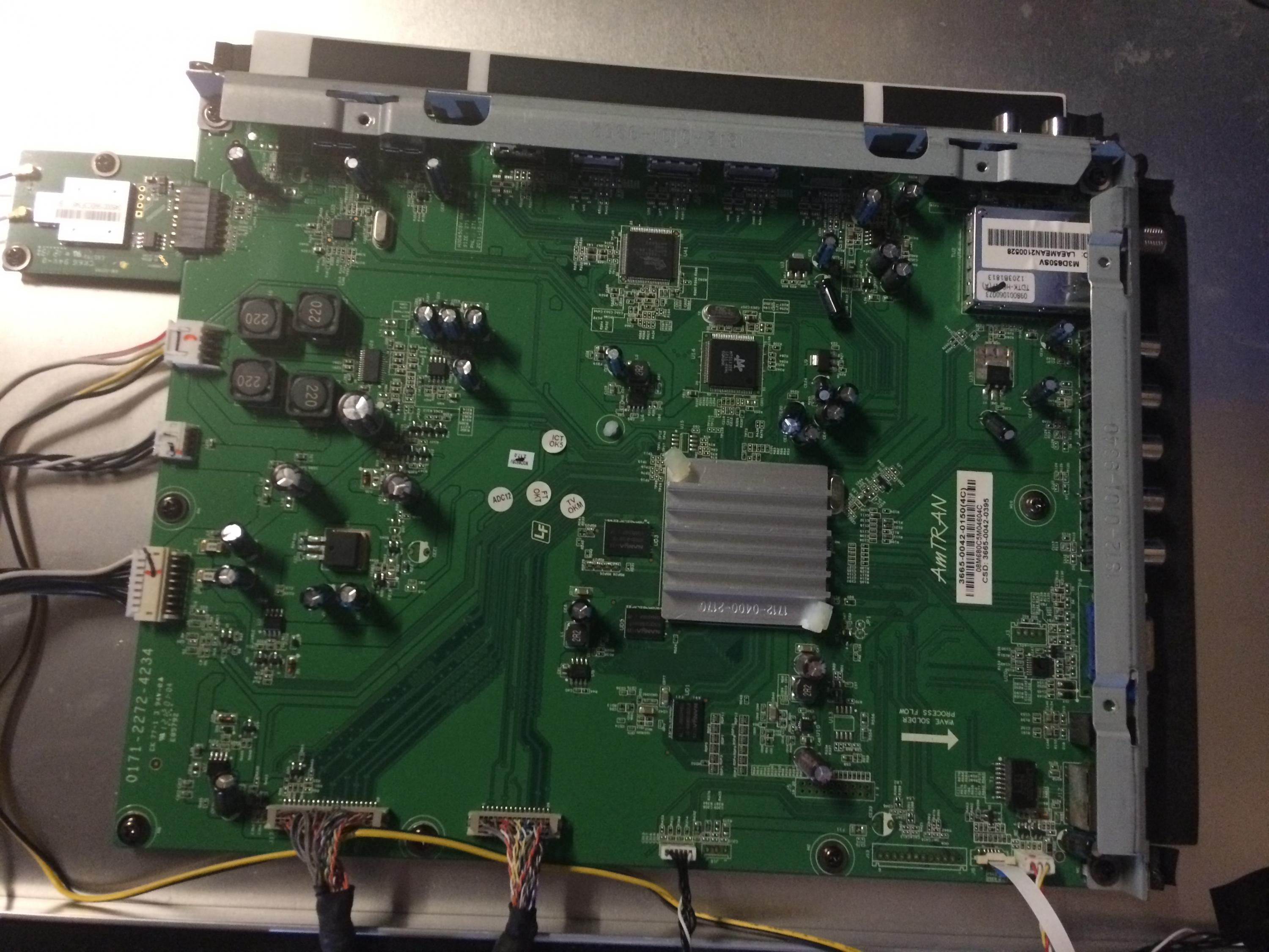

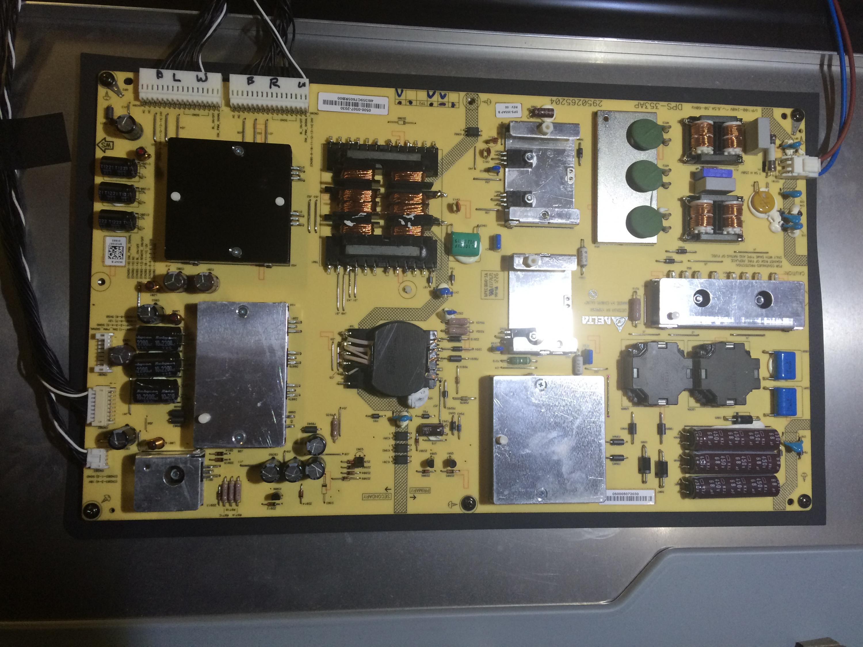

    I have NO POWER OR LOGO LIGHT on the tv and I assumed it was the power board and replaced with a new one and still have the same issue of NO POWER OR LIGHTS at all
    power board-dps-353ap

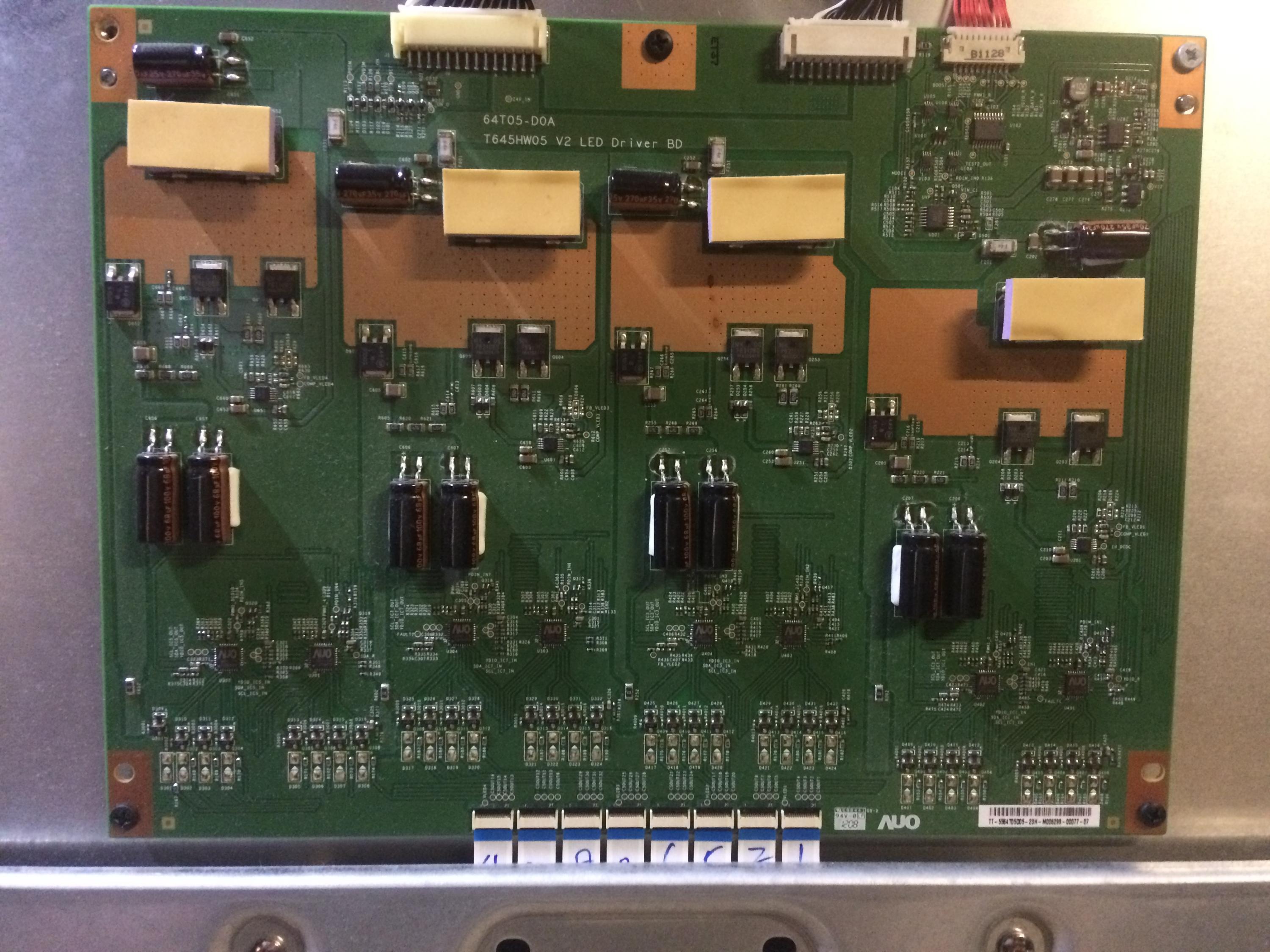

    led driver board- t645hw05 v2
    main- 2665-0042-0150 (4c)

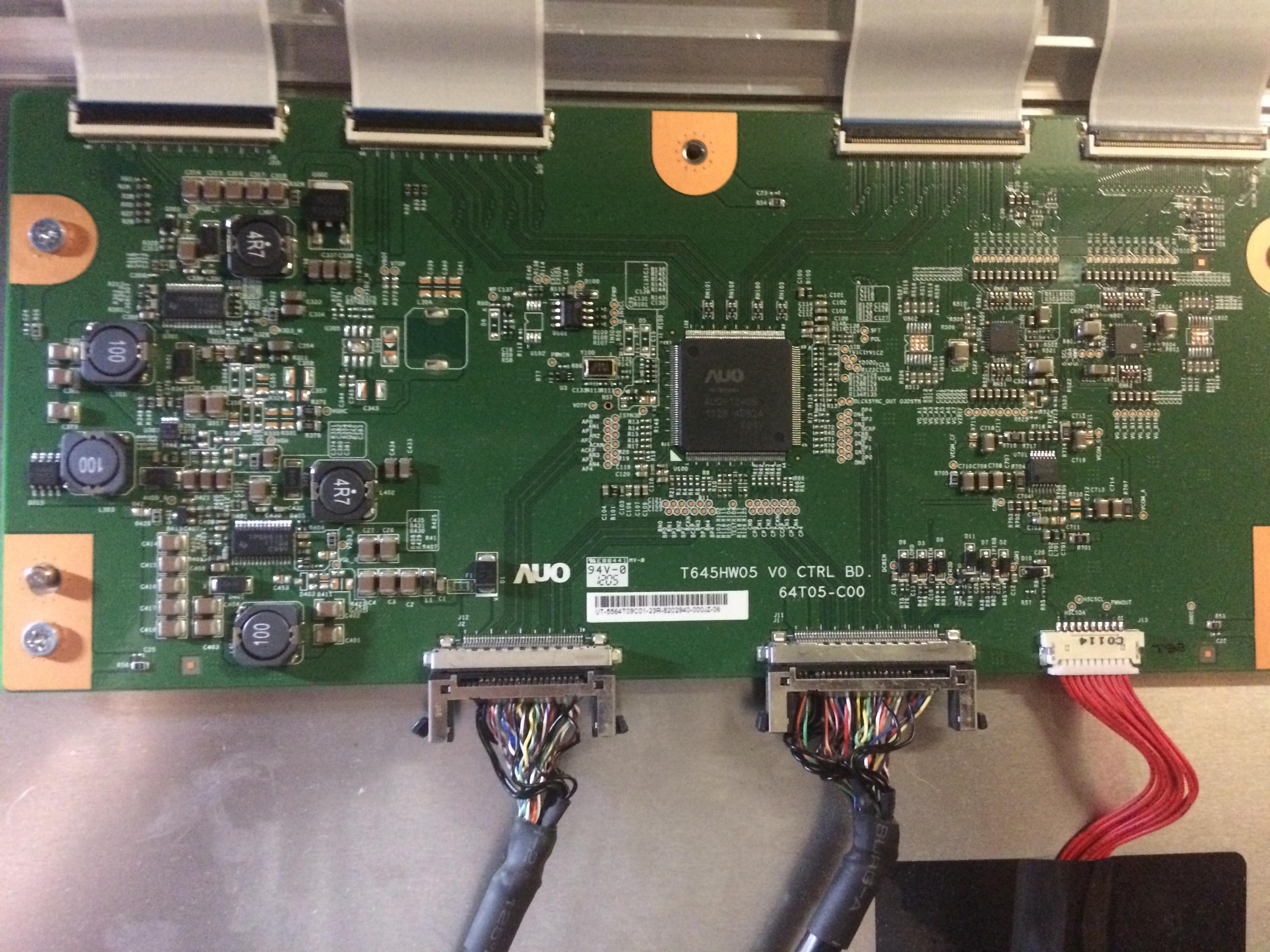

    control board- t645hw05 VO

    What Voltages measurement have you made on the power supply board connector that goes to the main board?

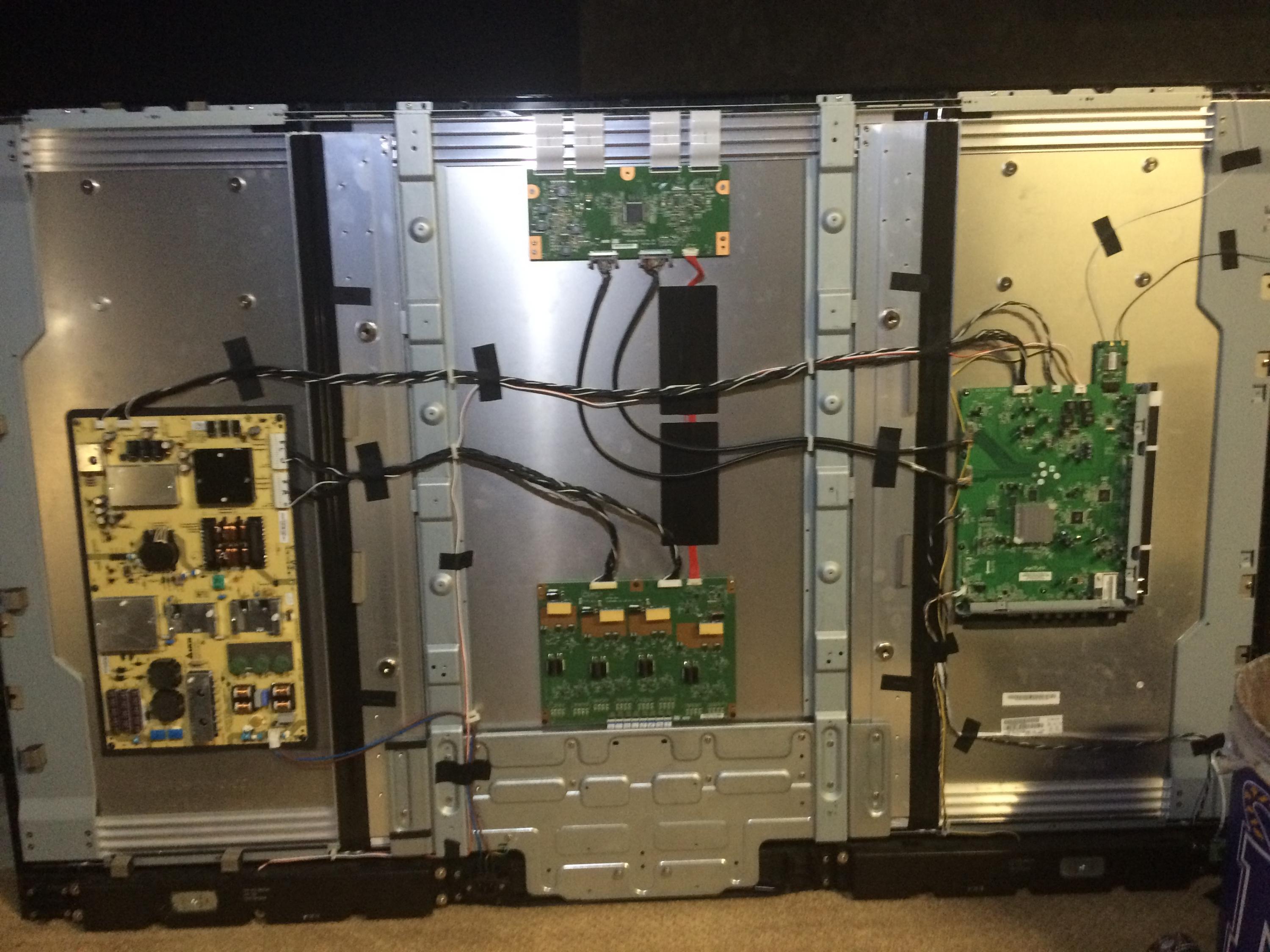

    How about uploading the pcitures of the whole back side of the TV so we can see all the boards?
      Re: vizio m3d650sv power issue.

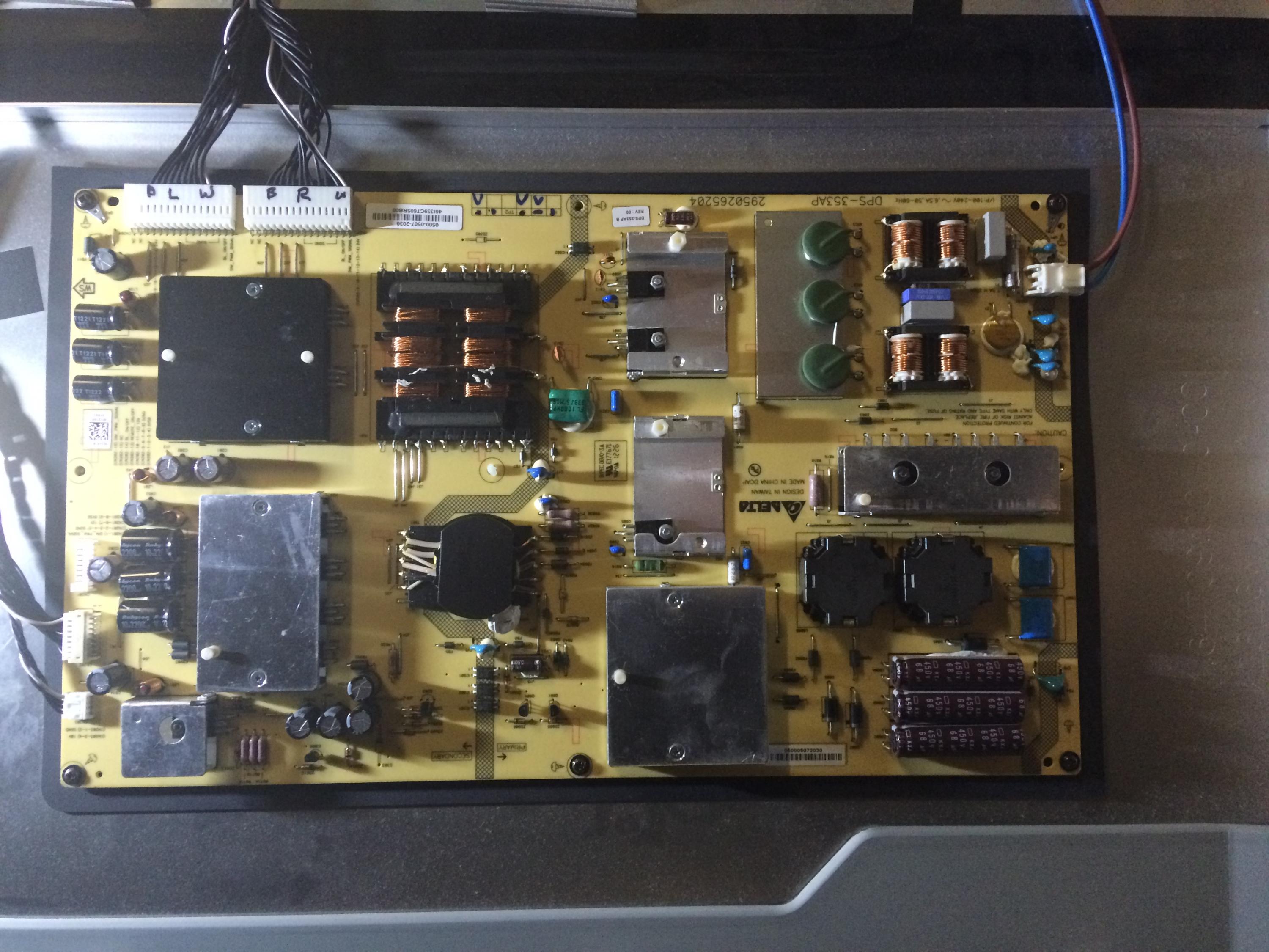

      here are the board pictures of it. like I mentioned it has no power or stand by lights. I replaced the power board to no avail... at a loss here
        If you replace the power board then you should then have at least the STBY Voltage on one of the connector pin of the power supply board when you run the board by itself without having it connected to the main board, did you verify that you do have STBY Voltage?

          What I believe you might be experiencing is a bad main board drawing down the 5 volt line on your power supply. A lot of the time you will not get a good 5 volt line because of a short and or malfunction on the main board. As per what Budm has suggested, you must disconnect the main board from the power supply in order to get a true reading for the 5 volt standby line.
