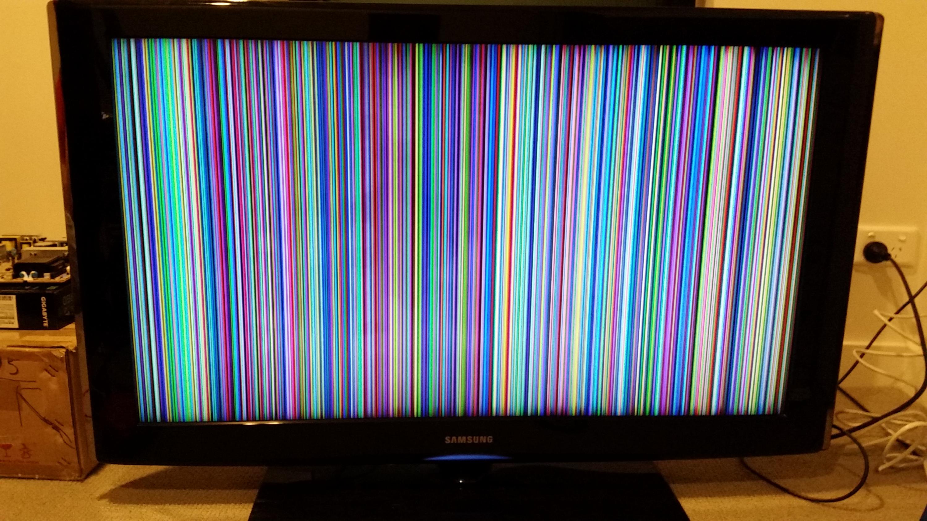

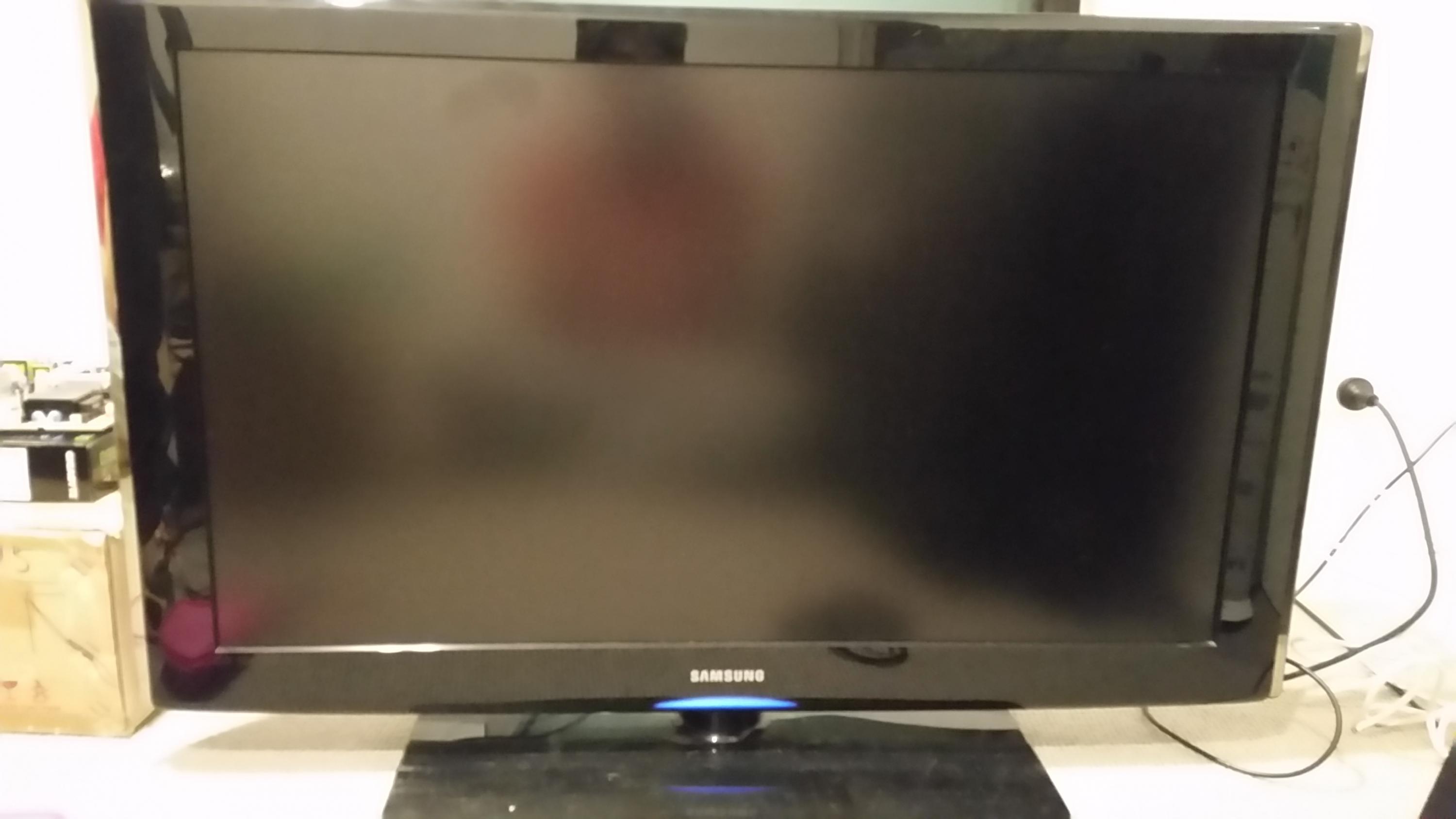

    Have a SAMSUNG LA40N81BDX that behaves in the following sequence:
    1. Power button is pressed
    2. Clicks on like normal, blue light near samsung logo turns on, backlight flickers on
    4. 5 seconds later, back light turns on while coloured vertical lines progressively fill the black screen. The lines are solid.
    5. 10 seconds later, another click is heard and everything is switched off.
    6. Repeats
    I have deduced it to be the main board, rather than the screen/t-con board due to the fact it is switching off and having no response to the remote. Have already changed the EEPROM and already tried heating up the processors with a heat gun.
    Anybody else have this sort of experience? I want to try repair the board to component level because they are expensive/hard to find.

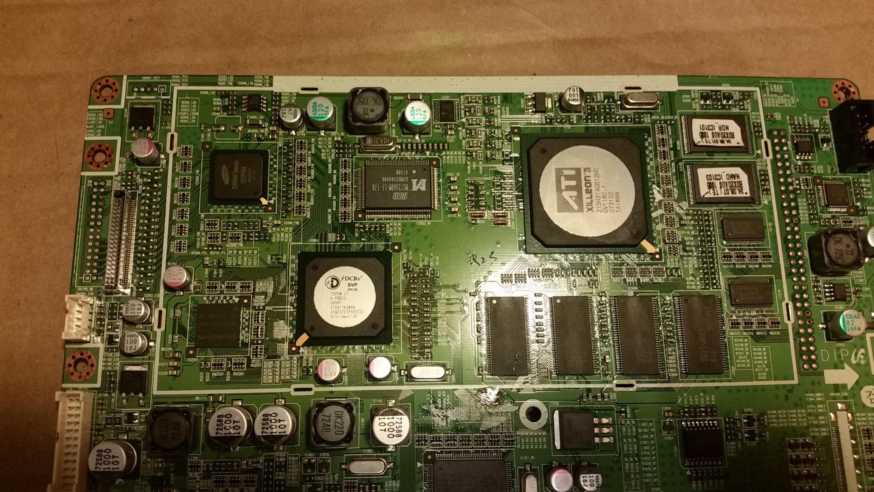

        That would be the Mb Id say normally two 1000uf caps under the cpu heatsink that cause the set to crash after heat up but normally heating that area causes it to fault out.
        • syaoran123
          • Jun 2014
          • 178
          Re: SAMSUNG LA40N81BDX coloured vertical lines appear then switches off
          I heated it while the heatsink was on actually. But i will remove the heat sink later today to see if i can find any 1000uf caps.

                        Ok , as Reecey said. Try to heat the mainboard. I have a similar model with the same mainboard but has a extra board.
                        My tv also had lines when the board cooled down but when i heat it the lines go away.
                        So try to heat the board for a longer period of time and see if it stays on. The problem is most likely bad capacitors.
                        • syaoran123
                          • Jun 2014
                          • 178
                          So I removed the heatsink and this is what i see. Which part do you think is faulty?
