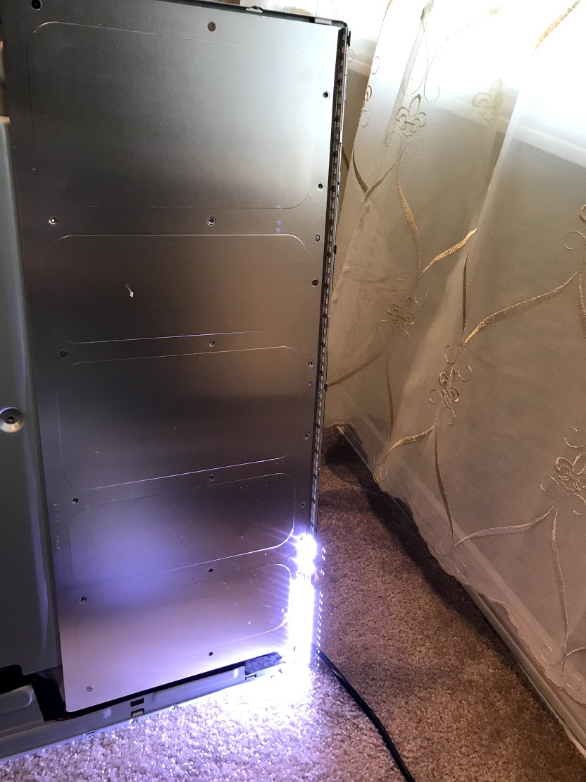

          In the continuing saga: The replacement LED strip came in. I powered it up and looks like only 1/4 of the LEDs turn on. They tested just fine on the lab bench supply, but the TV doesn't turn them all on.
          If i press on the LED strip, i can get them to faintly glow. I've requested a new unit from the eBay seller.
          I also have a second LED driver IC and will try replacing it again this evening.
          -Thomas

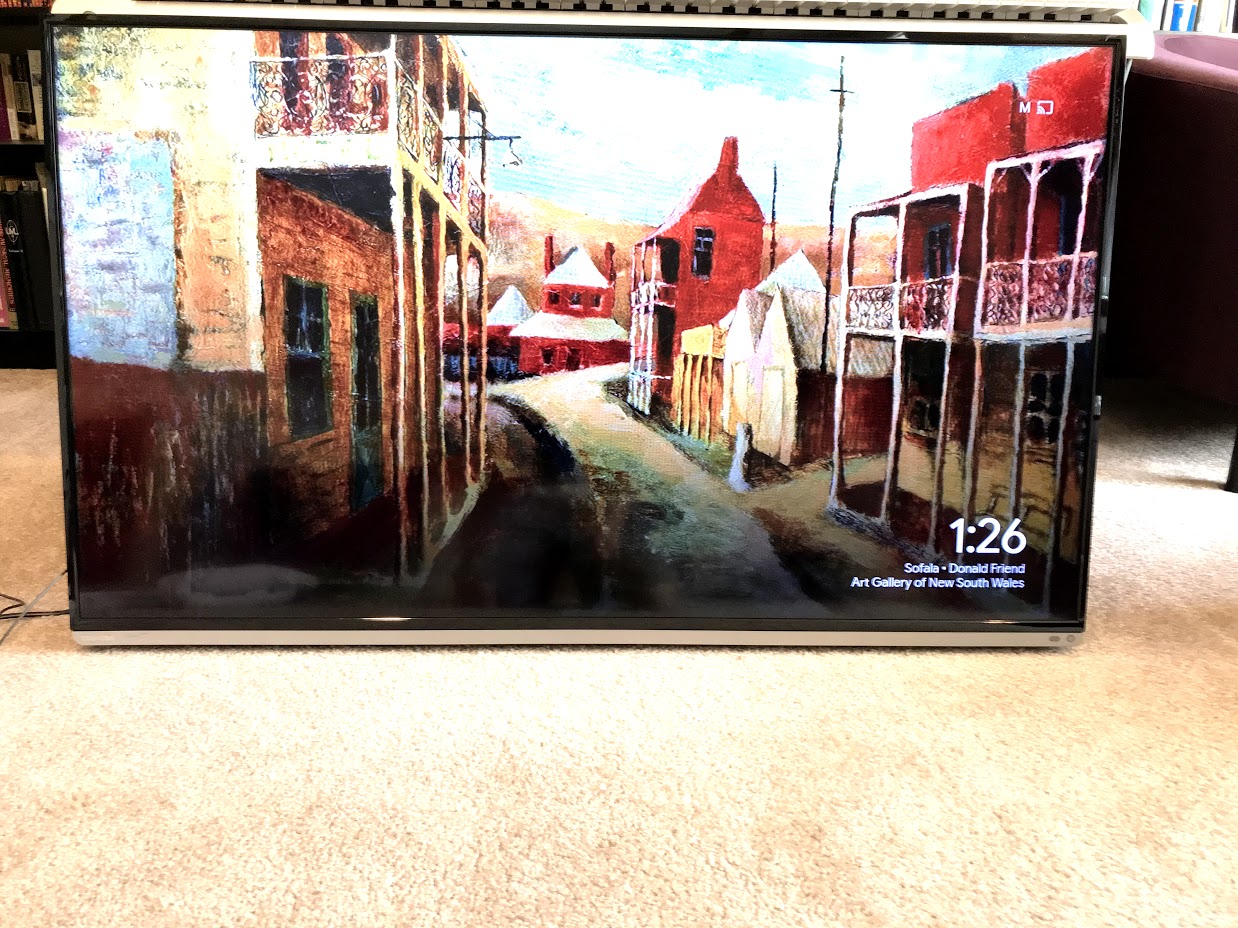

            I started this thread July 2016. I just wanted to give a quick update on the TV.
            I received a second replacement LED strip two weeks ago. i finally had the opportunity to install it today. The TV appears to be working.
            Project Summary:
            - Received free TV July 2016
            - Discovered backlights blink when the brightness is above ~75%.
            - Used TV as-is for over a year as our family picture frame; during that time, I had to reduce the brightness to ~50%
            - October 2017 - Purchased replacement LED driver - replaced - didn't change behavior
            - November 2017 - Purchased replacement LED strip (granted, I should have just replaced the 10 bad LEDs). Replacement unit didn't work.
            - January 2018 - Second replacement LED strip received.
            TV fixed!
            I'll post a long term update on the unit. I may keep it.
            (Or i may end up selling it since i have 7 other TVs in the garage to fix!)
            -Thomas

                    Seems like there are two well documented failure modes for this tv:
                    1) poor thermal dissipation from the LED driver
                    2) a bad LED string
                    For me, it was clearly a bad LED string :/. The Replacement LED string is still operating strong!
                    Best of luck!
