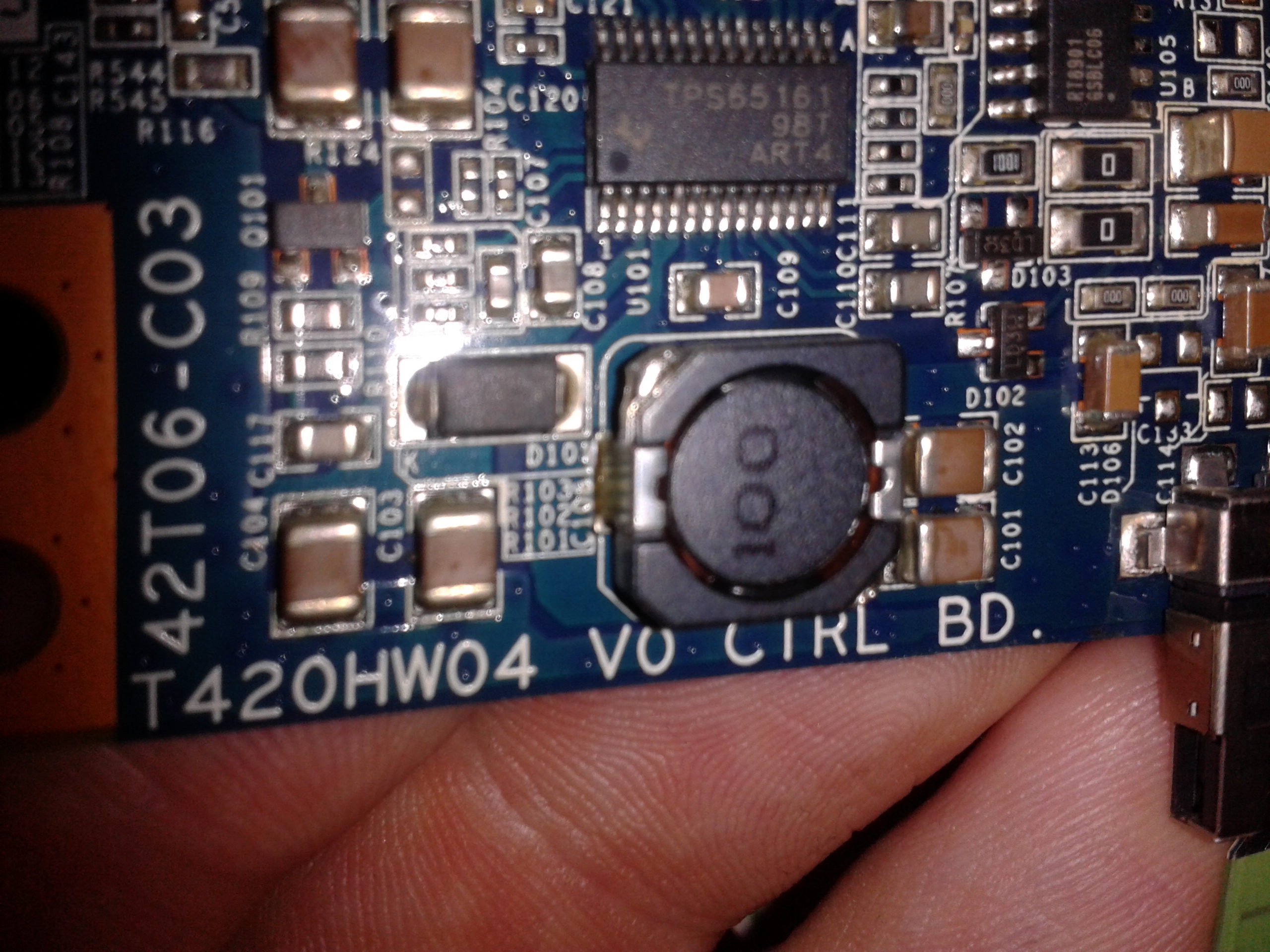

    Hi, i have bleaching (fading to white after a few mins) and from everything I've learned it's likely a t-con as15 chip issue (at least it seems that's what i should replace first)
    I was wondering about a section of the model numbers and if anyone has suggestions for a decent supplier, even a decent chinese supplier.
    My numbers are as follows.
    42T06-C03 - 55.42T06.C16 - T420HW04 V0 CTRL BD
    I was wondering how important is the c16 part and what does it mean? I got the impression it might be a software thing as lts of suppliers don't seem to issue that part, especially the chinese manufacturers like taishun on ebay.
    Does it matter that much and if so how come lots of manufacturers don't list them? Also, what does the c03 part mean?
    Would greatly appreciate any help on this as i don't have the tools to solder a new chip but ensuring i get the right t-con or at least a good one is proving difficult.
    Thanks guys.
    Last edited by mattheweveringham; 07-16-2016, 11:52 AM. Reason: made a mistake sorry, i meant the meaning behind the c16 part and the 013 part, NOT c03.

    Have you images of the board please ?

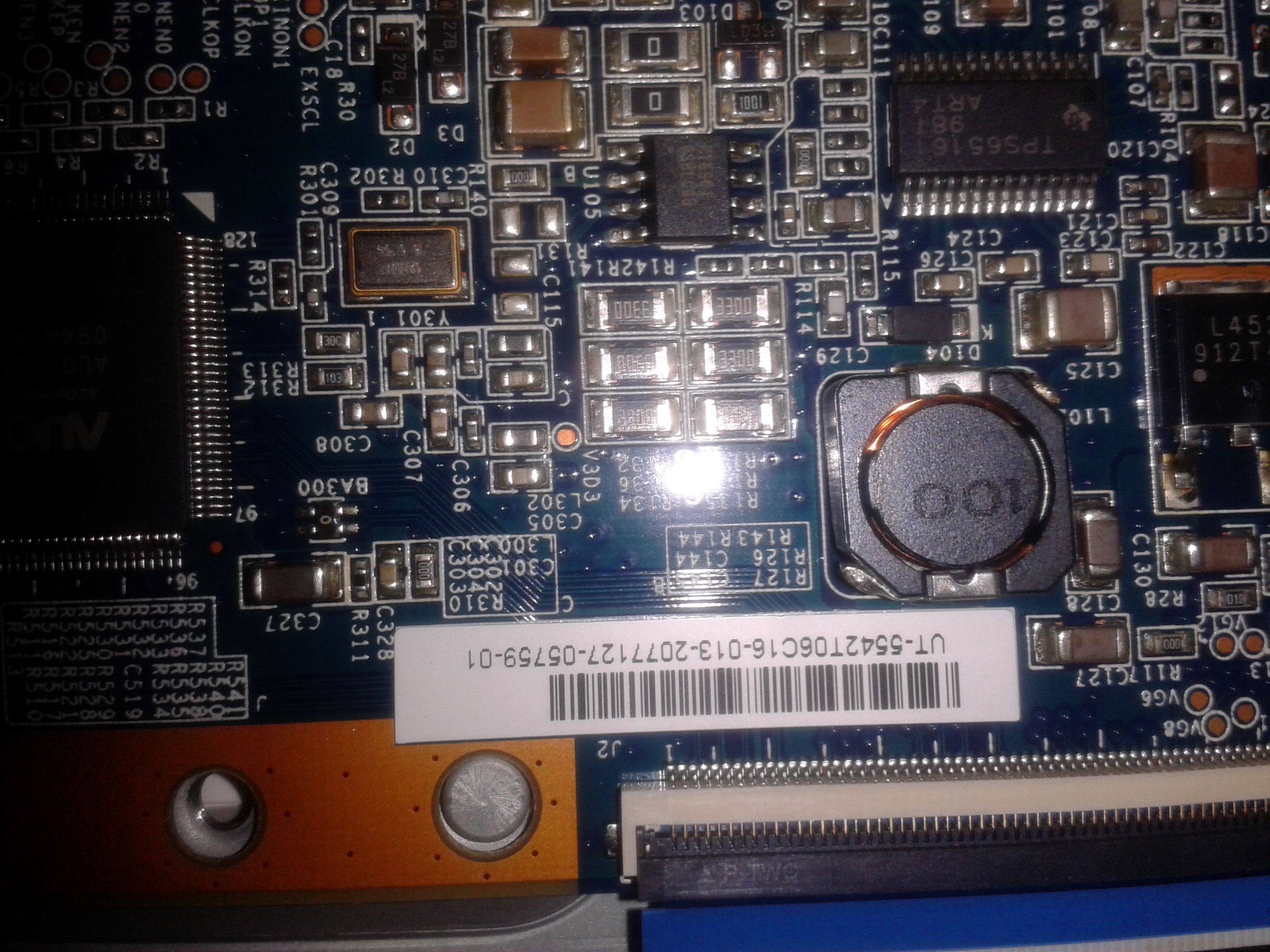

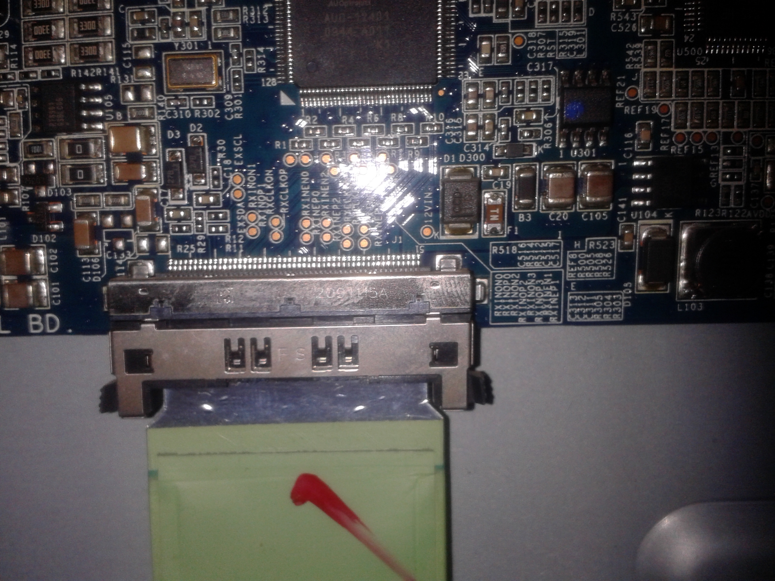

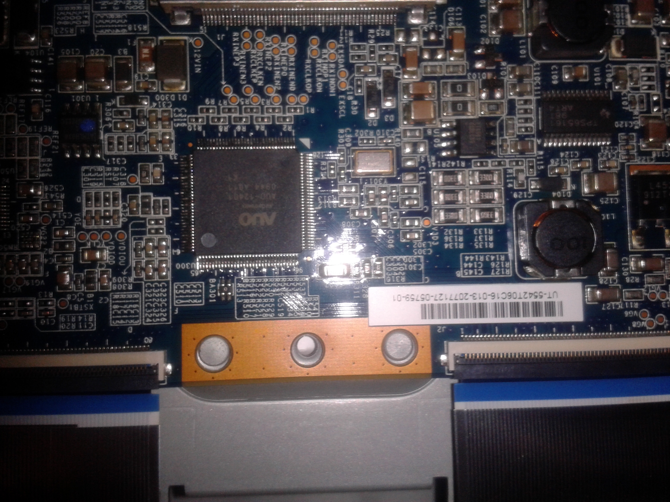

      Are these ok? I know one of the chips is hard to see but i took these a while ago, do you want me to go take some more?

        The serial is on the board is 42T06-C03 T420HW04 V0 CTRL BD
        serial on label is UT 55.42T06.C16 - 013. Was just wondering about the c16 and the 013.

              The part number of this board is shown on the white bar code sticker 5542T06C16 with board type being T420HW04 VO (Sticker part number should match for it to work correctly)Substitute Part(s):
              55.42T06.C19 55.42T06.C09 55.42T06.C15 55.42T06.C20 55.42T06.C14 55.42T06.C13 55.42T06.C12 55.42T06.C17

                If you want a cheap fix then replace the AS15 chip. Don't forget to check if it's a F / G chip.
