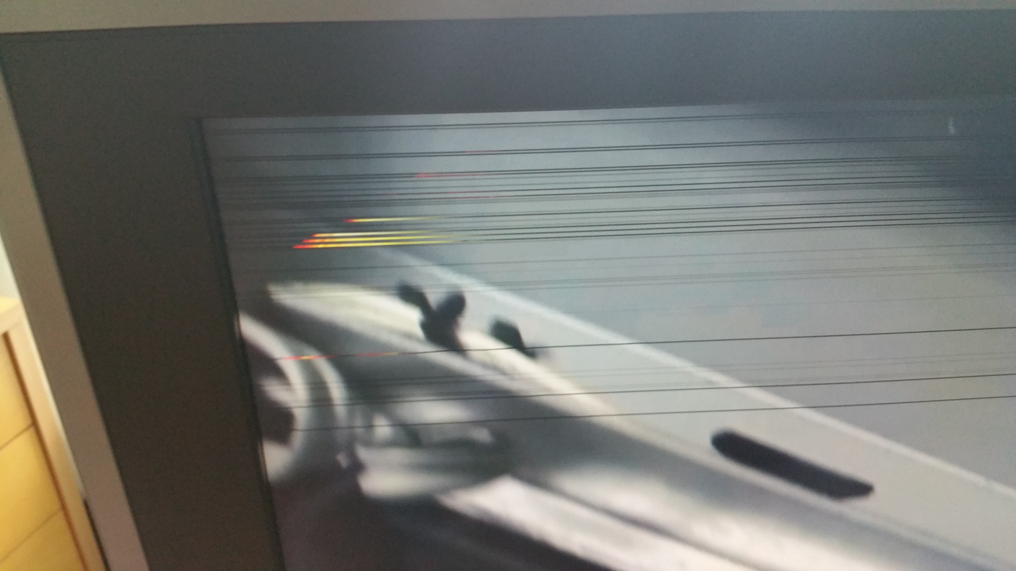

    Hi guys,
    Sorry if this is a little bit vague and currently no photo, which I will add later, I have a TV as in the description with thin horizontal lines in the top 3-4inches and the lower 2-3 inches, can you give me some ideas on where to start looking for issues please..

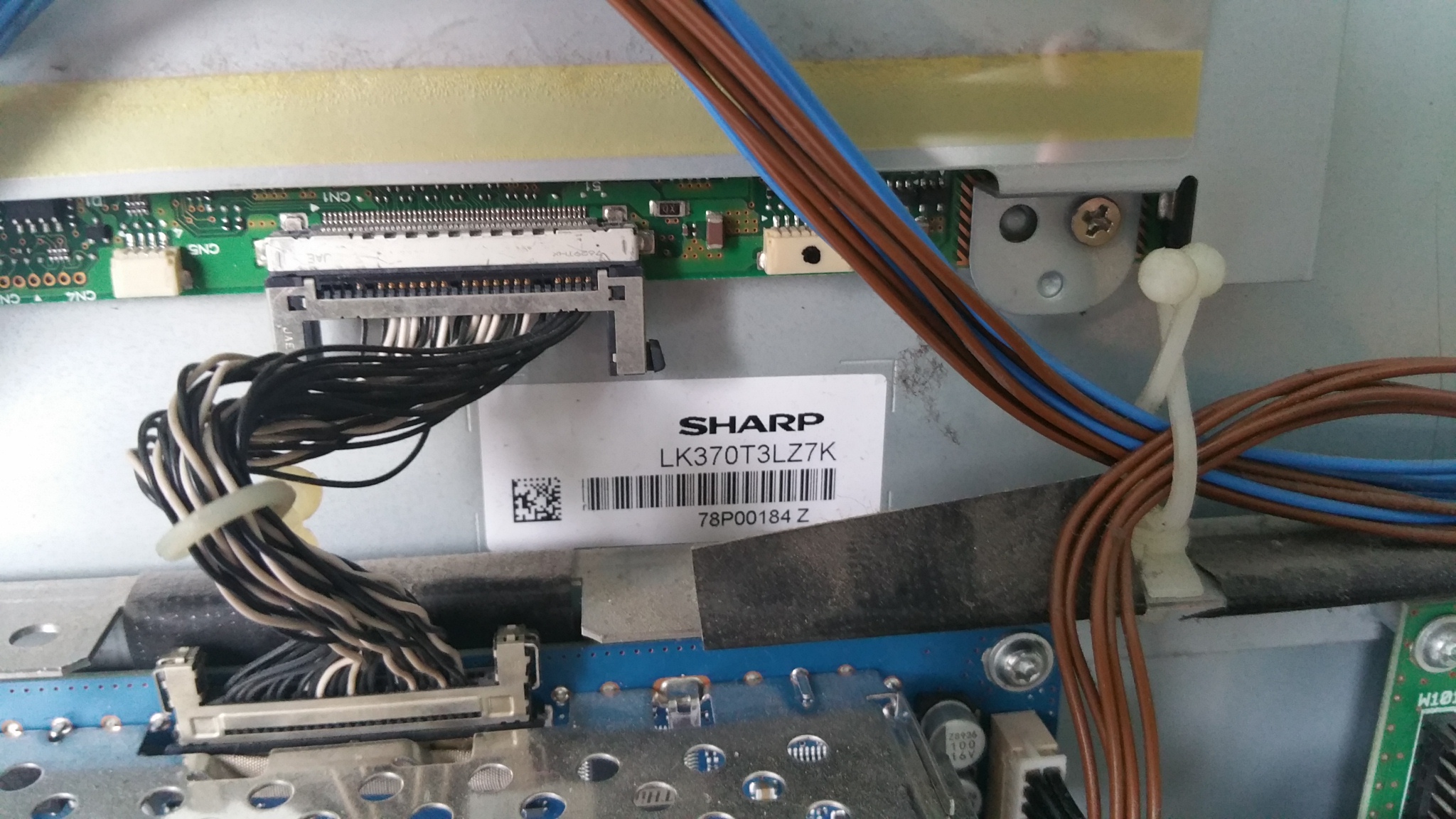

    The Panel is a Sharp LK370T3LZ7K
    T-Con - CPWBX3718TP
    Thanks In Advance..

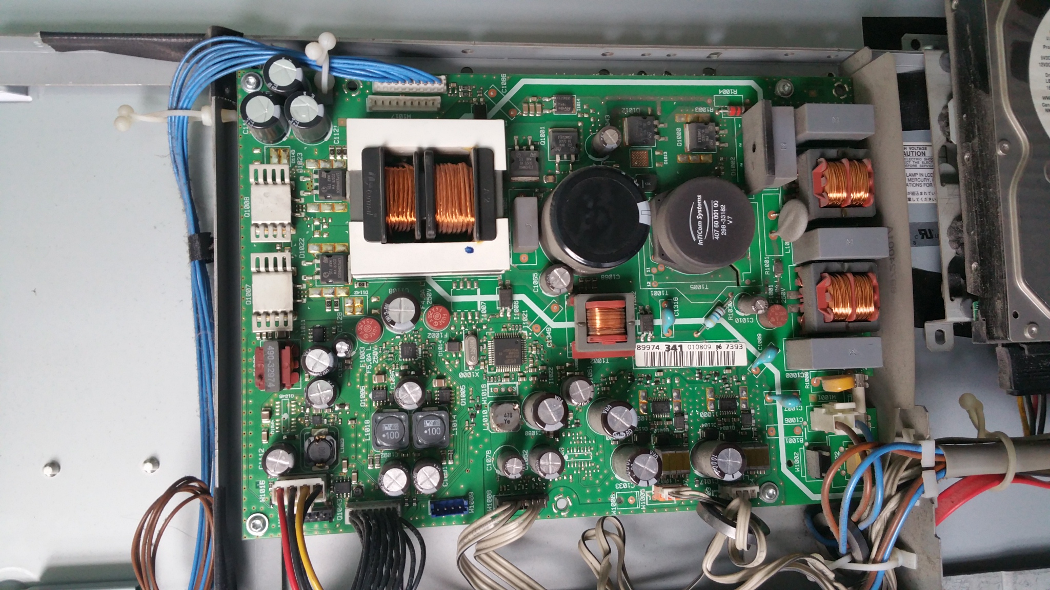

    So just pulled the PSU and did some in-circuit ESR testing, and found that a good number of caps were reading VERY high, 1000uf most were reading over 3000uf...
    So a trot down to Maplins (Only place open), and a handful over overpriced cheap shit caps later, will be re-capping this afternoon and see how it goes..

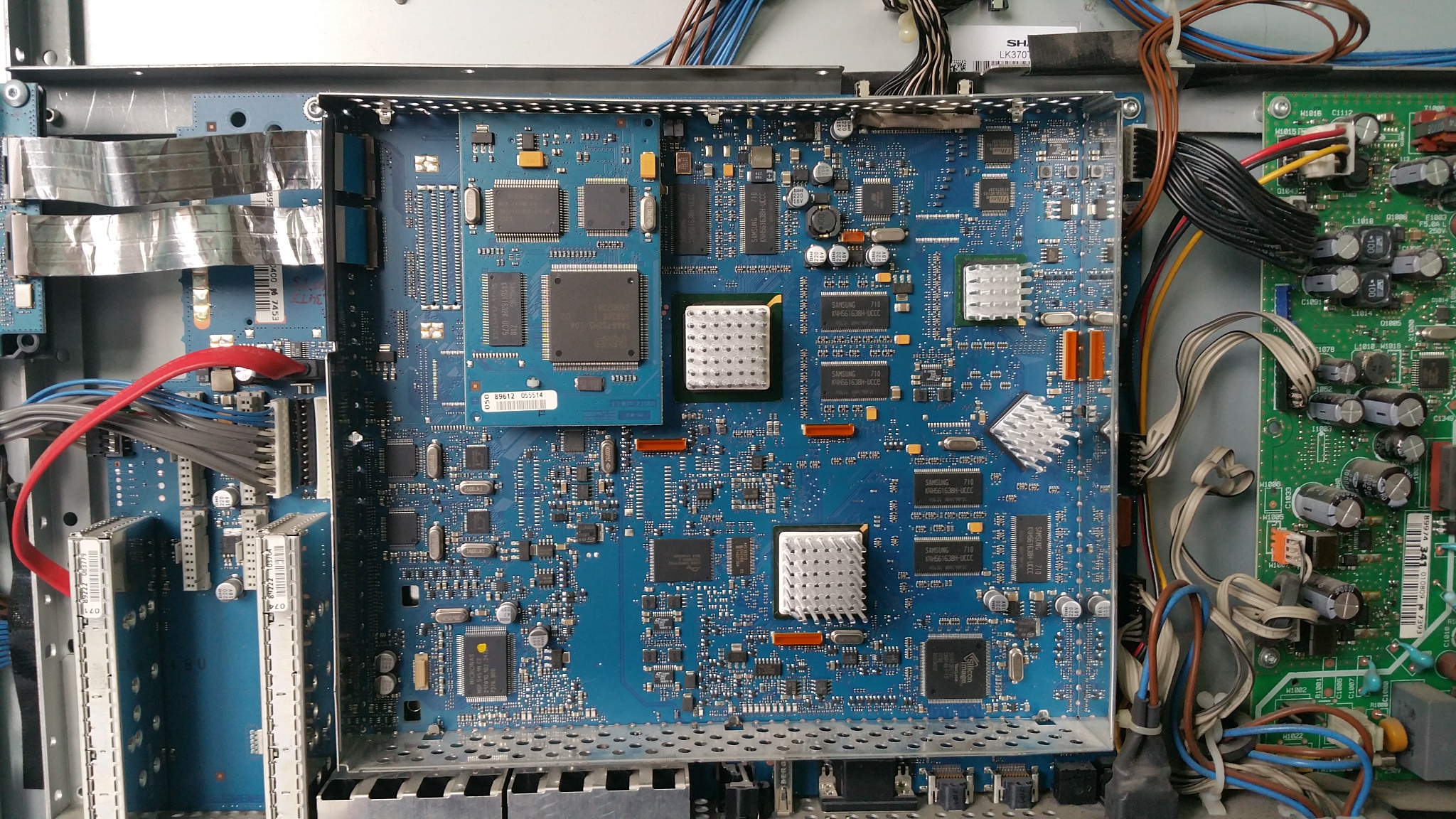

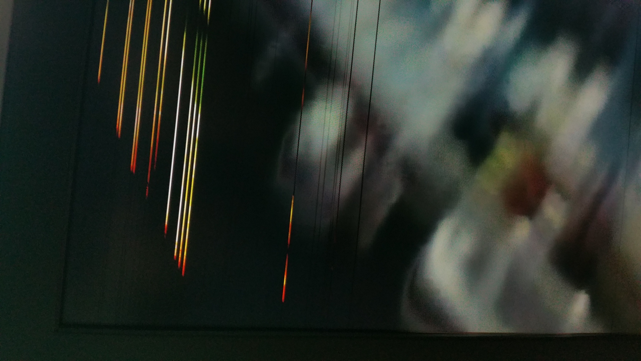

      Here are the pics I promised

        Re: Loewe - Xelos A37, lines
        Looks like a good build quality Tv, however the issue I think is panel failure which wont be fixable
          Ok thanks
            Wait and see what others think.
