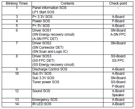

    Just picked this up today. It has 14 blinks. Service manual only lists up to 13 blinks but I've messed with enough of these panasonics to suspect the SN board (y buffer).

    14 blinks it the error for IR LED or A board. try to disconnect the remote sensor board, maybe it's not the A board.

      14 blinks on these is Psu shutdown, doubt the Ir board even causes and error lol

        Surprisingly I have the same Tv here (Uk model) has 14 blinks, 4 shorted fets on the SN. Im replacing all 6 30F131 type transistors and all the screws used for the SN board with ones that have ground washers.

            this was from the manual;
            I've never had one with SOS14. so... good to know this if it will be the case.

              Check Maxxarcade on youtube he had the same set 14 blinks was SN
