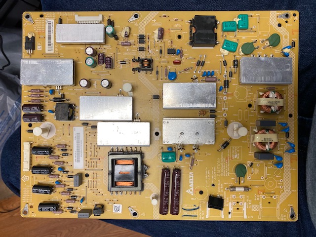

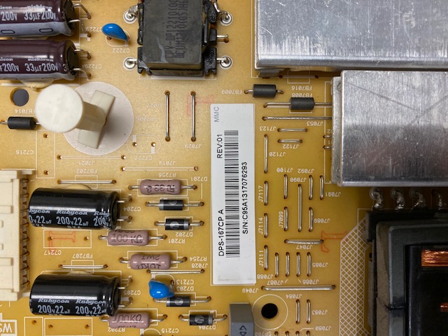

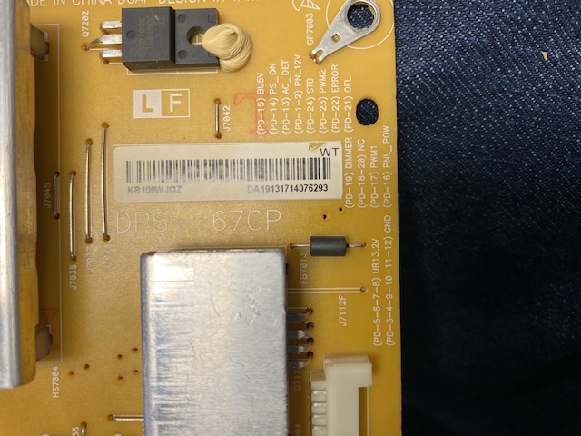

                                        • gette
                                          Sharp 70 - Delta DPS-222BP - 2 Long 3 Short
                                          by gette
                                          Hi...
                                          Very handy and tech newbie here trying to learn to fix my TV that died after a lighting strike
                                          SHARP LC-70LE732U
                                          Delta DPS-222BP
                                          Icon Flash 2 Long 3 Short
                                          Power PWB Failure
                                          Power supply error 2 (*2) D+3.3V error
                                          D_POW
                                          Digital 3.3V failure Flashes fast 3 times
                                          DET_D3V3 (33pin) failure (L). Digital 3.3V is not applied.
                                          If error is detected during start-up or operation, the power is turned on again by polling.
                                          Above is what manual states not what I confirmed, but would lie to but not...
