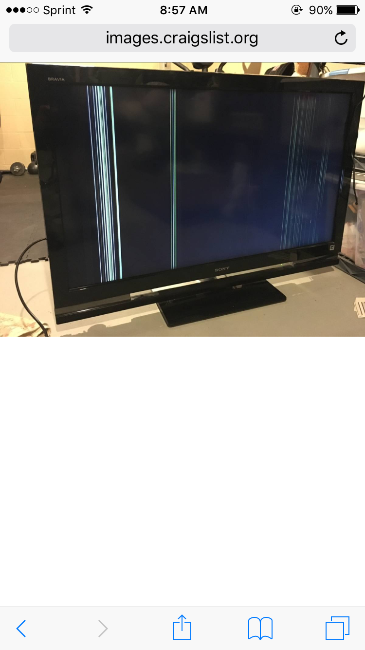

    I have the opportunity to buy this tv for $20. The owner said he replaced the tcon board but did not solve the problem.
    Would you guys say this is a panel failure?
    Re: Sony KDL-46W4150 vertical lines
    Lines is always panel. Address drive failure not fixable.
