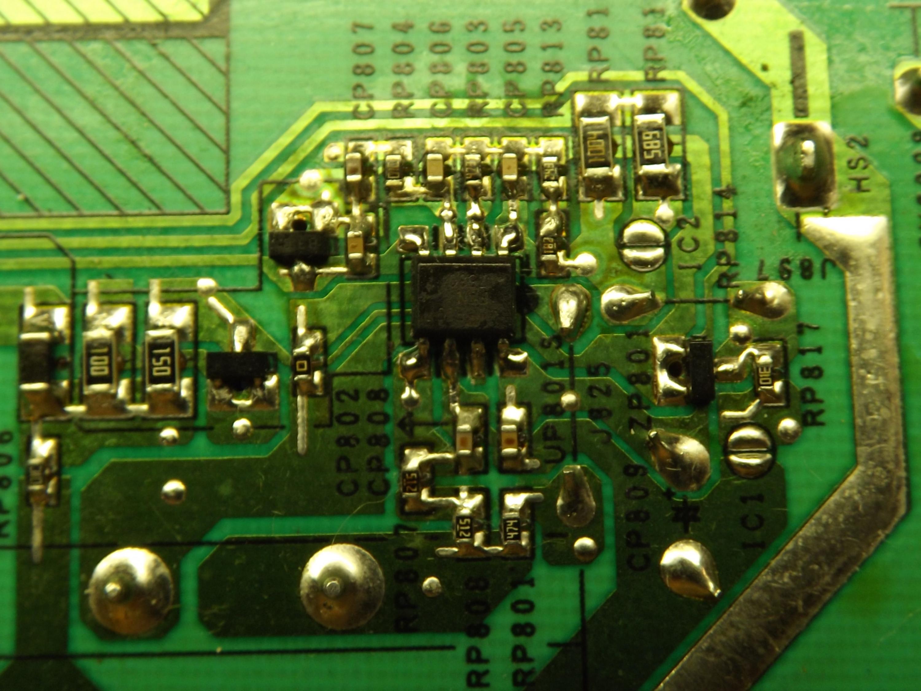

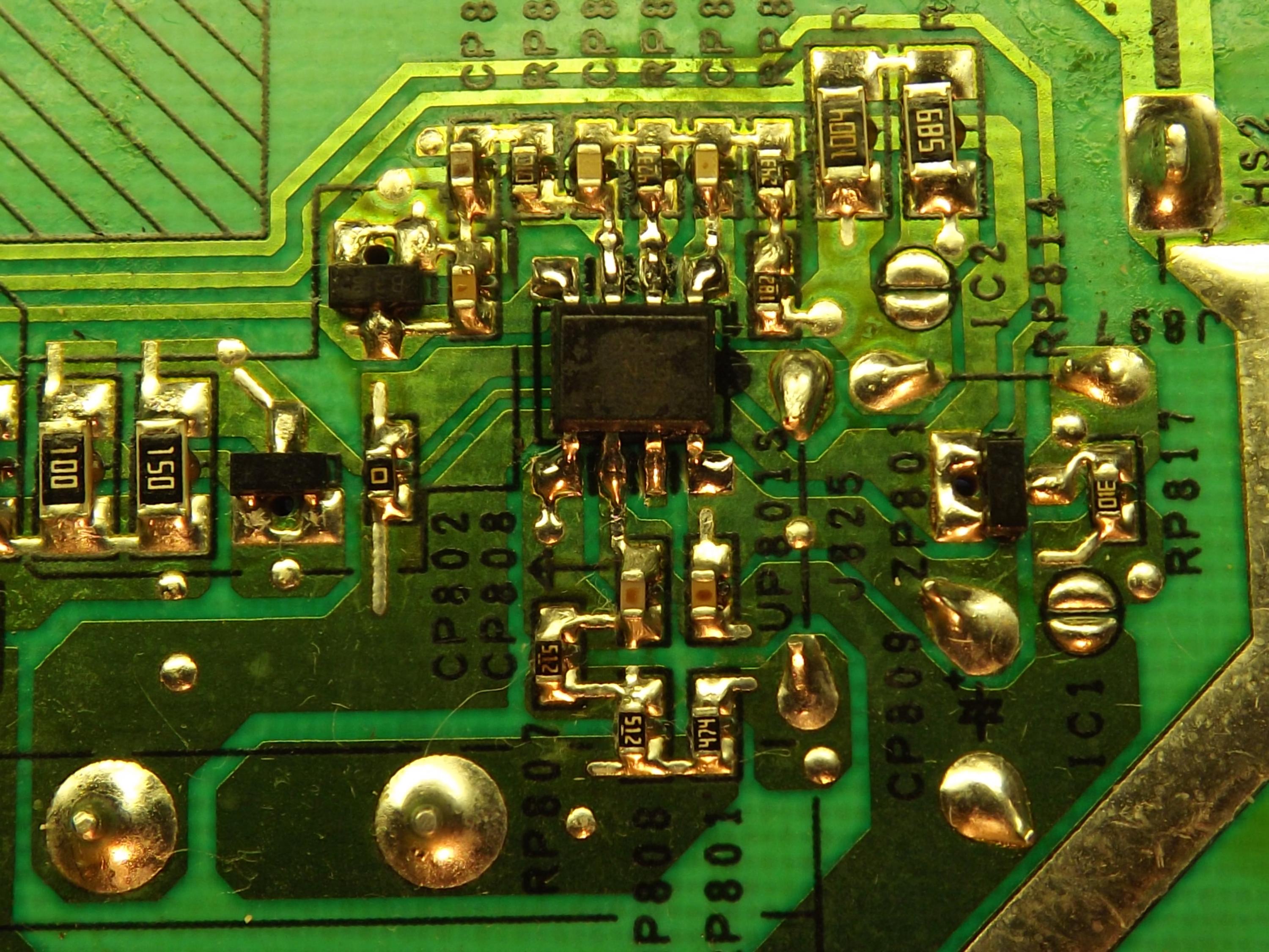

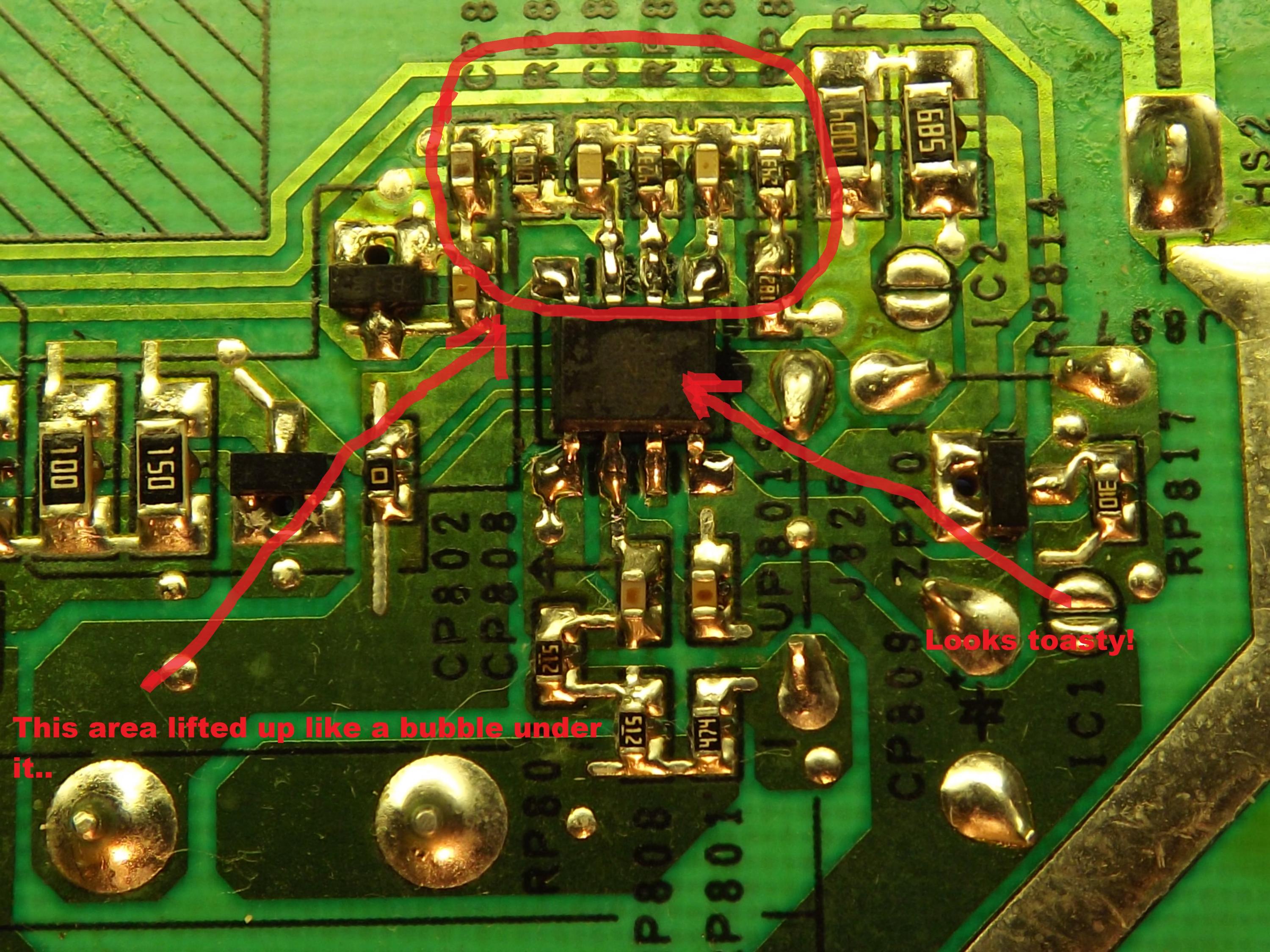

            Well guys i put a used Fan7530 in my board and now im back to a direct short as soon as i plug in the power cord,60 watt light bulb glows brightly!..
            I doubled and triple checked for solder bridges with 15x loop and even R&I Fan7530 twice to make sure...
            With Fan7530 REMOVED and board plugged in i have NO short.
            My inexperienced tv mind can only think of a few things...
            1...i got Fan7530 too hot with the hot air station removing it and fried it.
            Or
            2...now that i got a good Fan7530 in there something else is shorted.
            Or
            3...I did have a section of the board top layer and traces lift from heat next to Fan7530 when i was removing it, but it went back down after it cooled....Really my first time using a hot air station and of course i removed about 10 similar Fan7530 sized ic's from a cheap dvd home theater board without any board bubbling problems when i was practicing!! Go figure!
            So really all i know to do is...
            1..get a NEW Fan7530 and try it.
            OR
            2..put back in my old Fan7530 and see if i still have a short
            Or
            3..Put the used Fan7530 back into the parts board and see if it still works(parts tv worked but had cracked screen.
            Thats all i can really think to do..
            Any suggestions guys,... Before i write this one off...
            I cant even find a replacement board for sale,..everywhere says out of stock..One or two sites had them for $100 but aint no way i'd spend that for one!!..SJ when they had them in stock were $60 or so,even then i dont know if it would be worth it for a little 32'' tv!...well maybe but no more than 60!..i would rather go about 40-50... i suppose that would be worth it..

              Check the mosfet that is with the fan7530 if it is shorted. There is a possibility, that the fan7530 is bad and actually holds the mosfet on all the time. The fuse can only blow if there is something major shorted in the primary rail. So how do you figure, that you have a short? Do you go by the dim bulb tester, or do you actually measure a short with the DMM?
                Re: Samsung LN32b460 No Backlights...have sound and picture
                Just using Dim bulb tester...60 watt bulb glows full bright as soon as i plug in.
                Bulb does not glow at all with Fan7530 removed.
                Before i put in Fan7530 tv worked with no shorts,just no PFC ramp up

                  i just pulled the mosfet and all combinations are open except .49v (diode test) between source and drain the one direction.
                  In circuit the mosfet had a reading in both directions from source and gate.. other combinations seemed normal
                  I cant remember how that mosfet tested in circuit before back when i didnt have a short.

                    Your Mosfet is good. Unplug the PSU, make sure the main filter cap isn't charged, then see if there is a dead short on it, or check the bridge rectifier. If no dead short is there, check all the diodes for good measure. If one reads funny in circuit, take it out or lift a leg and measure it again. If you find nothing again, remove the dim bulb tester from the PSU and plug it in straight to the outlet. Either it works, or you will find out soon what part is / was bad.
                      #30
                      Ahh...i see what your saying...maybe there is no short and the tv is trying to start up with the backlights now, and since i only have a 60 watt bulb in the dim bulb tester thats why it glowed so bright...i only plugged it in for a second a couple times,quickly unplugged...
                      Thing i noticed before but failed to mention is the tv seems to turn on as soon as i plug it in,which doesn't seem right to me,but if thats what its doing than yeah the dim bulb would glow bright if tv is pulling its full amps now..
                      Let me put the mosfet back in and give it a go without the dimbulb.
                      When you say test for a dead short on the large filter cap,...would that be checking between its leads?
                        #31
                        + lead to - lead on the cap. If it shows steady low resistance, you have a short to ground.

                          thank you!..Im getting about 18 ohms on the leads of the cap...Mosfet is still removed..I will put it in now and retest the cap
                            #33
                            We have lift off!!! Heck yeah!!.. I removed the dim bulb tester and the backlights are on and working!!... Thanks so much guys!!..
                            I only left it on few a few seconds,because of that under rated mosfet i have in there...not sure if i should leave the tv on very long until i order and get the correct mosfet installed..but yeah its working!!
                            Thanks Capleaker!... i didnt think about the the 60 watt dim bulb glowing bright because the tv is now pulling its full amps to start up the backlights.
