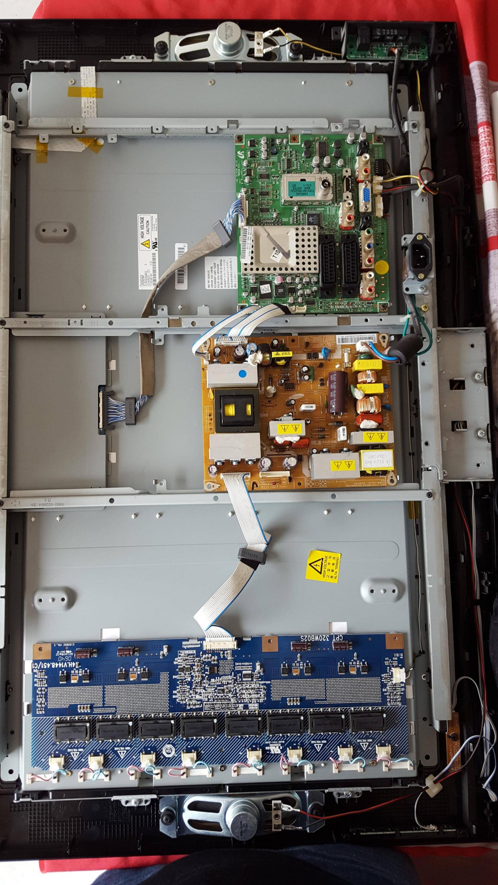

    Samsung UN40H5003 boot loop every ~8 seconds
    by eigma
    Hi, I rescued a Samsung UN40H5003AF (H = 2014 FHD) from the curb. Symptoms are: standby (red) light comes on, stays on for 8 seconds, flickers off, then comes back on, and the cycle continues.
    Service manual: https://www.electronica-pt.com/esque...is-u8la-71272/
    SMPS board: checked voltages, all seem normal (A13V = 12.8V, UD = 3.3V, PWM_BLU = 0.77V, PS_OnOff = 5.5V). Remove 10p cable to main board -> backlight comes on. I think this means SMPS board and backlight are good.
    Main board: BN94-07592P / BN97-08922R...
