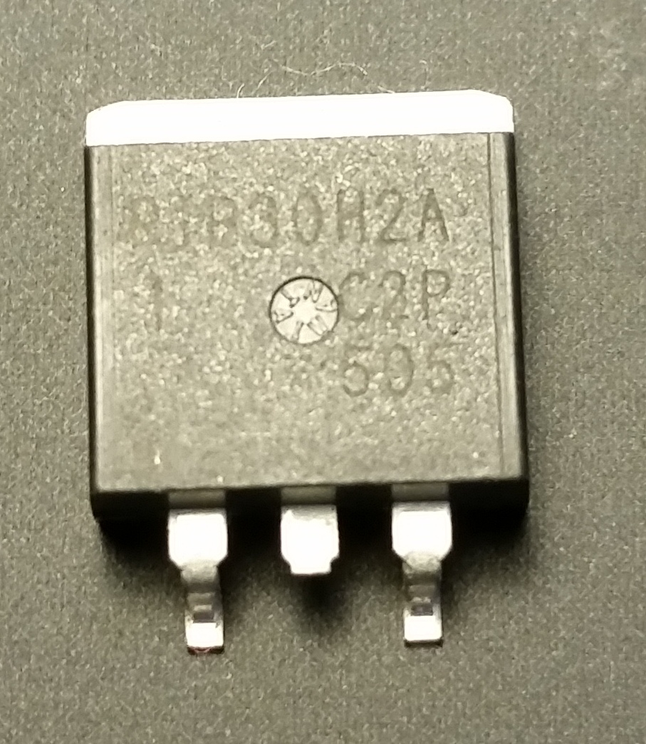

    The ones I've been getting of a Chinese ebayer have been fine and ive been keeping the originals and they look legit under magnification. The same was not the case for the Toshiba bits.
    these are the RJP30H2 I've got and working well. Note the exposed copper on the cut corners. I find the original 30F131 also has this but the fakes are tinned and smooth.
    I've compared these to the original ones I've pulled and they match up well including the ground feint ridge on either edge

      Thx TW2005 , good to know. I will check my big box of RJP30H2A , see if the corners are cut.
        #83
        Re: Panasonic SC Board - BAD 30F131 IGBTs
        Mine are all cut off on the corner but no copper. So all my RJP30H2A are fakes....
          Maybe but if they work I would not get too stressed. I'm just noting what I am seeing does not mean I'm right though, just a theory.
          Compare an original to it and see how they compare
