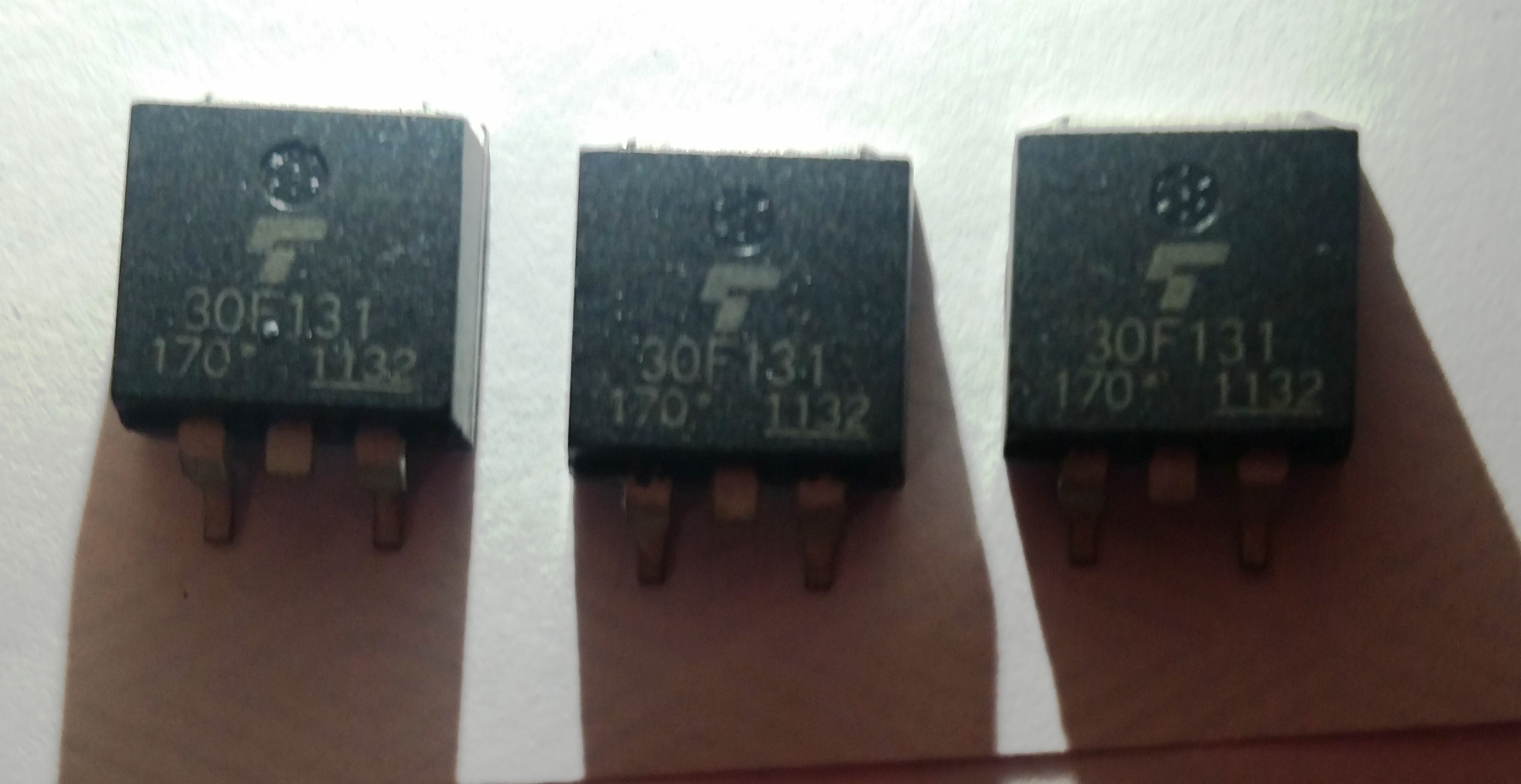

    Full refund from UTs on my order 50x30F131s. UK buyers Panasonic B1JBDN000004 (30F131) are in stock from sparedparts + chsinteractive (Charles Hyde) expect to pay £3.50+ each and they should come in a nice Panasonic parts bag.
      #42

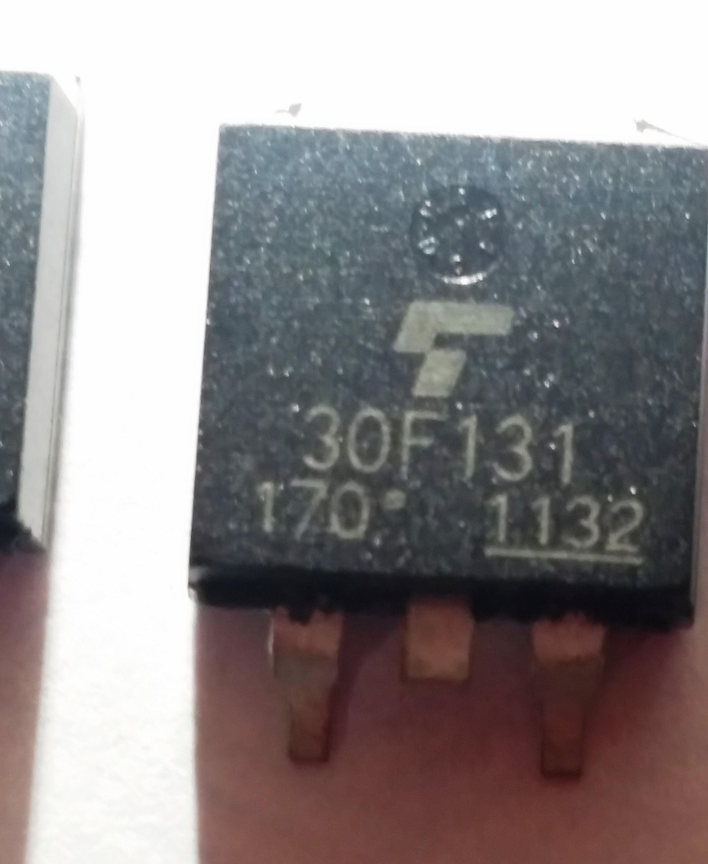

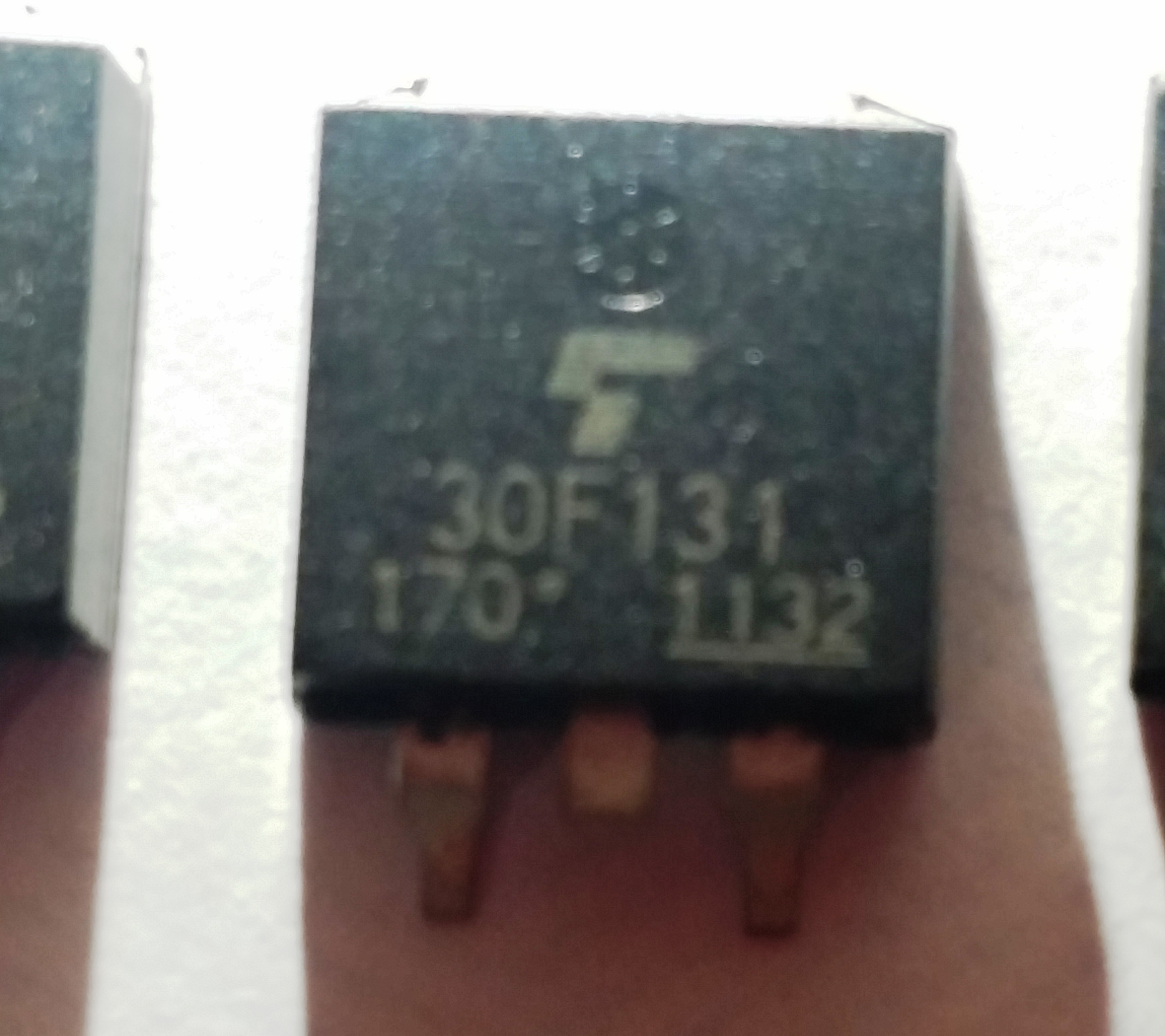

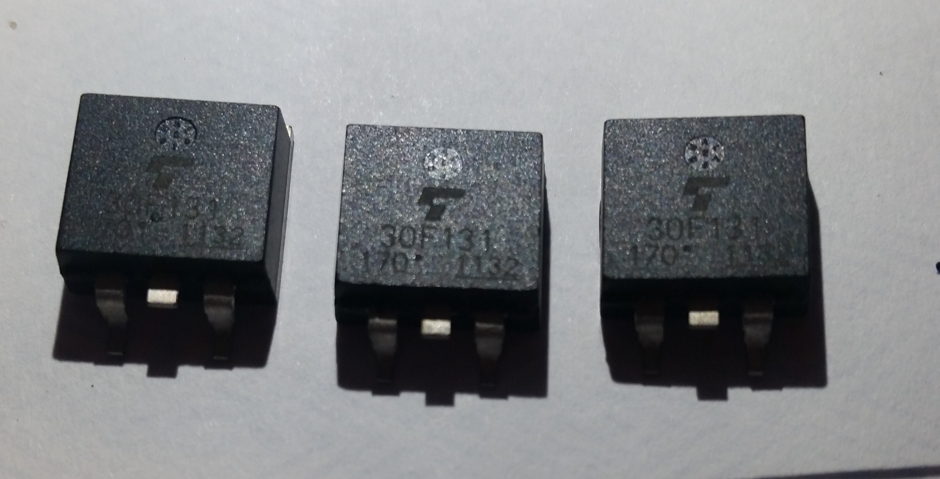

      Re: Panasonic SC Board - BAD 30F131 IGBTs
      Toshiba japan have requested images of the product. Will update if they respond to these images.
        #43
        Well the refund failed to show back in my account so am now claiming through paypal and sent the IGBTs off to Toshiba for them to look at with notes of were and when they came from.

                              hi everyone i couldnt reply to previous comments,buy with a move to larger workshop batch1412 batch 1117 all fake under rated igbts they been re etched
                              some 1412 batch are good but the fakers have copied the batch numbers i test my igbt on diode test using postive probe just tickle the gate and then check on diode drain and source should read 1.8v on diod,or better still using variable power supply stick 4.8v on the gate and you will get the igbt saturate,i sold so many kits for panasonic i mkae sure all mosfets are ok but now it seems gt30f131 are getting hard to get i even had some direct from panasonic out of spec i am looking to add eqivulent igbt anyone any idea i was going to try fgd4536 no idea if it works seen this igbt on lg plasma can anyone shed any light
