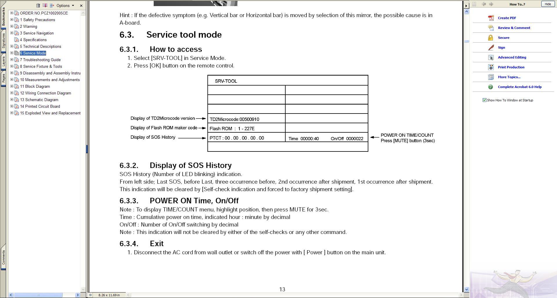

    Dear tw2005.. here you are the snapshot

      Re: Panasonic TC-P55GT50 12 Blinking lights?
      yes, that is all I've ever seen. Still not understanding your point about having to clear codes. Nothing there says you have to clear anything
        its procedure of repair to clear error code after repair the faults, i don't know where are the problem.. if you ignore this step after repairing.. its up to you.
          you need to reset ( Clear ) the error code at service menu, other wise will not working as usual,
            Fair enough. No I don't worry about it and it's never been an issue for me.
            I guess if you do a self check which I think restores back to factory you'd want to save the settings first on a SD card so they can be restored for the customer.
              So I tried to get into the service menu yesterday but found that once it popped up I could not navigate the lists. The remote or TV buttons did nothing - what am I missing?
                Did you read the information. Use numbers 1 , 2 , 3 , 4 ok , etc
