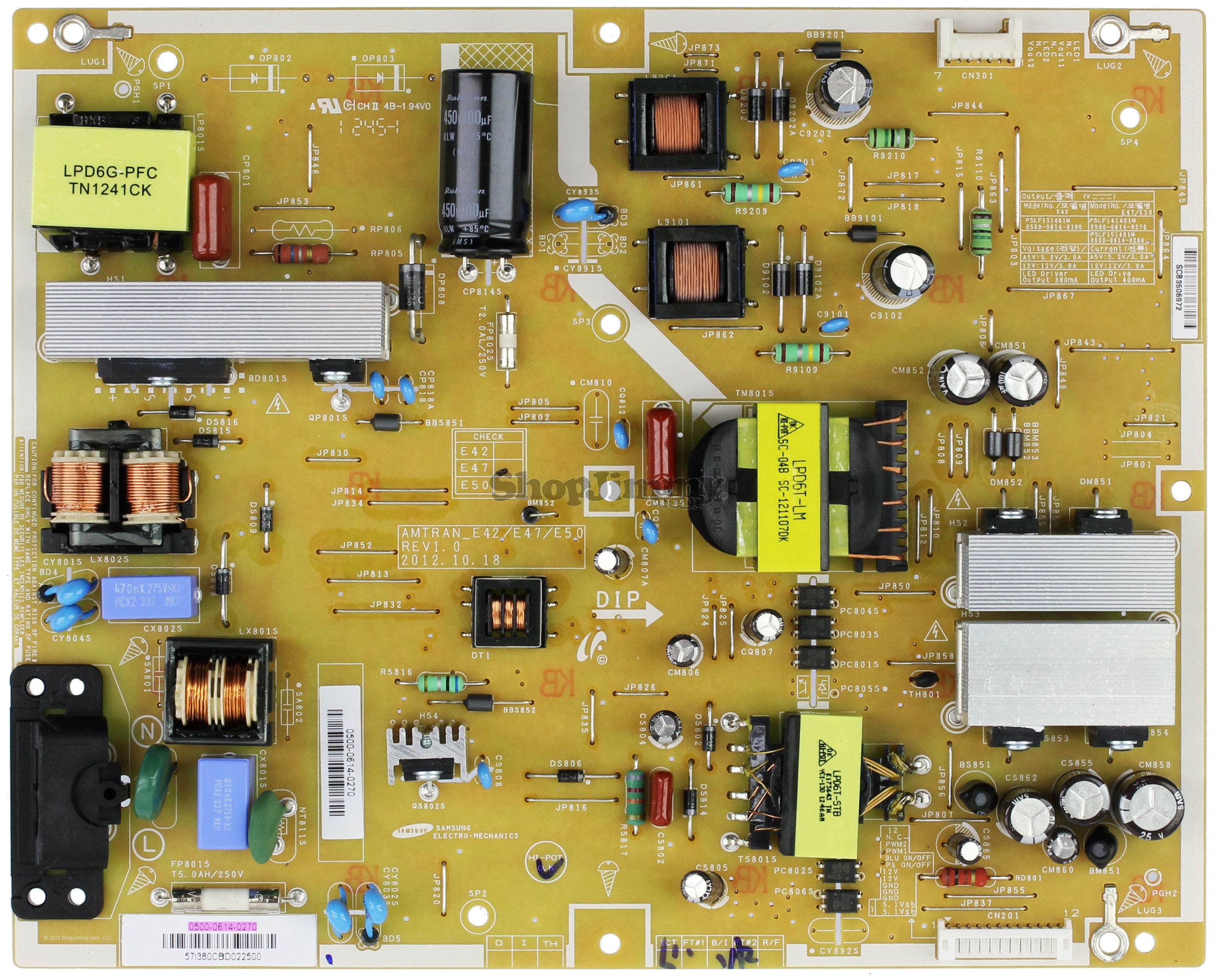

    I recently ordered a complete repair kit for this tv through shopjimmy.com it came with both the power supply and main board with all of the connects such as the control panel, ir board, and wifi board. but to no avail there is no change when i hit the power button you can see the power light come on and slowly fade out. No picture or sound. Has anyone had a similar issue?

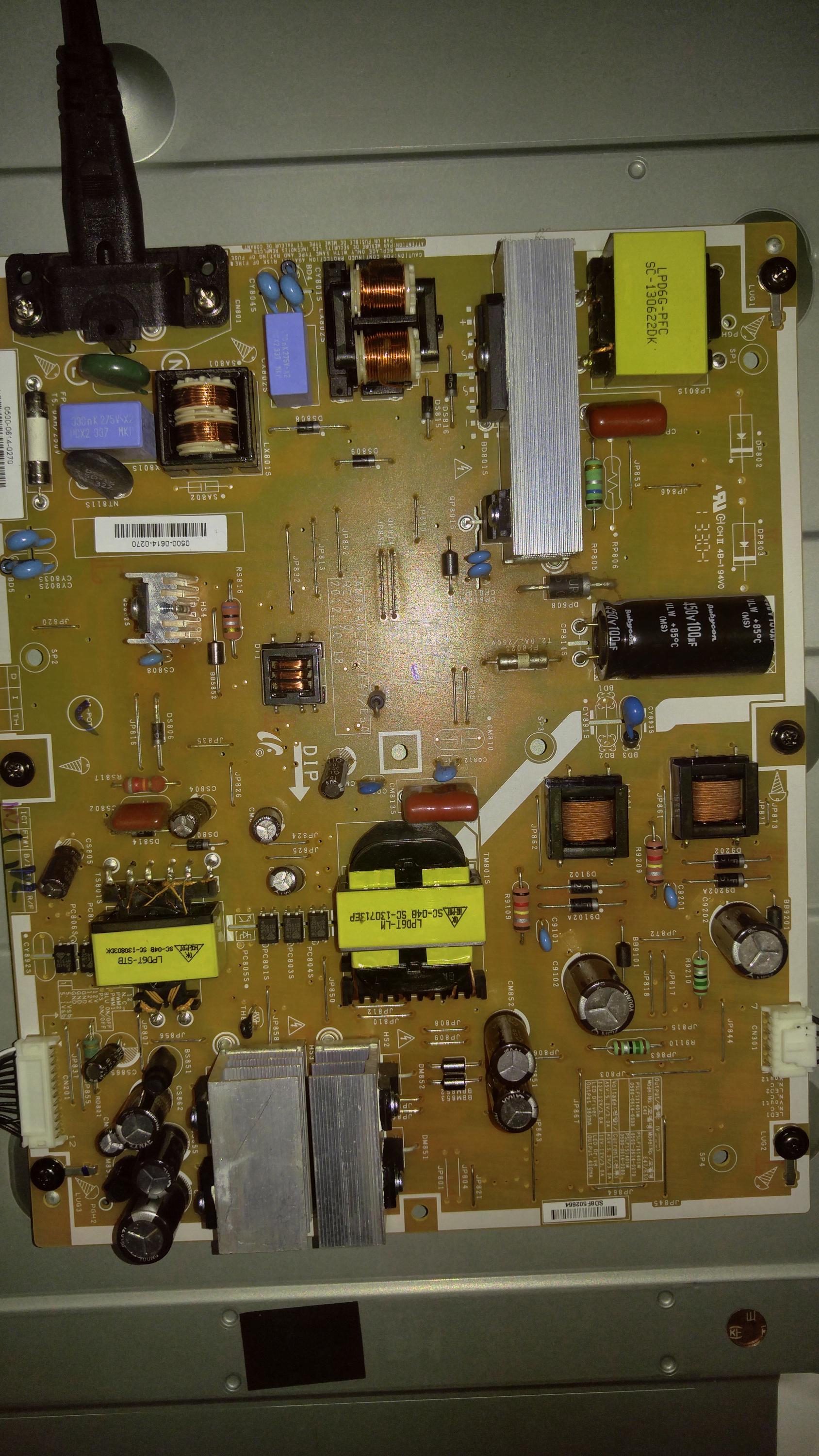

    Re: Vizio E470I-A0 Power led comes on then slowly goes off
    Ok I tested the voltage of both the power supplies before pressing the power button and after. this was the results.
    Off
    5.28
    5.28

    Shop Jimmy power supply:
      That's the way this TV operates the "ON" light. It powers on, then slowly fades off. It does this even with a perfect TV. What do all your numbers mean? Do you think we are psychic and can tell what you mean?
      My 55" Vizio also operates the "ON" light the same way.
      Do a flashlight test. You probably have a screen with info on it. Your problem is a bad LED (or two, or three, or four, or...) in the backlight. If the flashlight test is successful, then crack open the panel and replace the bad LEDs.
      • SLK001
        • May 2014
        • 264
        Oh, by the way, all your voltages are within specs. The model power supply that you have does NOT flag a fault with dead LEDs for some reason. This is why the flashlight test will confirm a working TV, minus the backlights.
        Sorry, but you spent all that lucre on all the wrong parts. Four or five (or even less) $0.25 parts will end up fixing your set. Well, at least you now have spares!

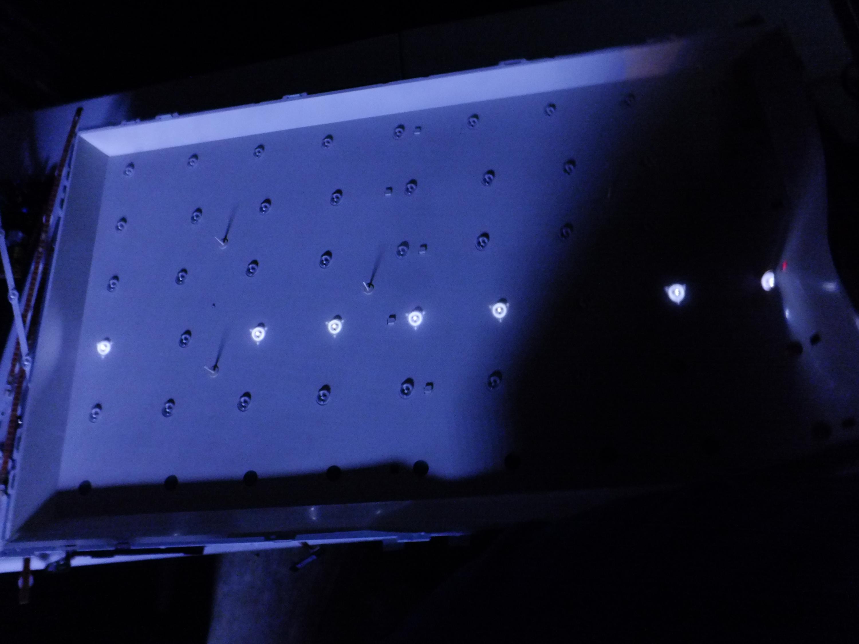

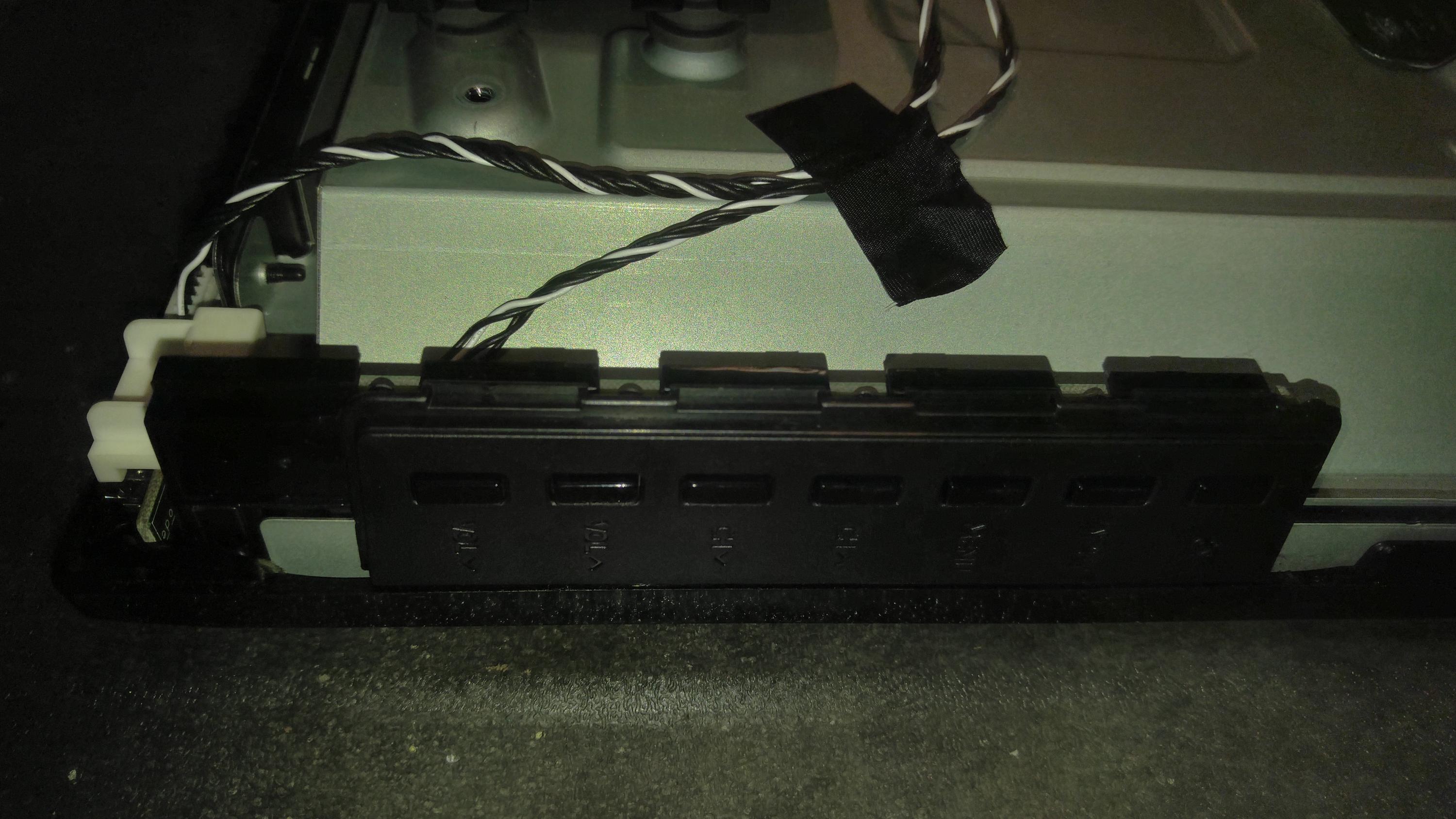

          I just got done working on a Vizio E470I-A0. I can tell you exactly why the Power led comes on then slowly goes off. It is caused by bad LEDs in the screen. Don't bother replacing any boards because you need to take the panel apart and replace the LEDs. In my TV there are a lot of them burnt out on every strip. They normally burn out because someone has turn the light up to high. I recommend never higher than 75%. Same thing happens when someone turns the volume up too high, they burn out the audio amp.
          So I replace my LEDs with a heat gun. Soldering iron will NOT work.
          As you can see from my picture I am testing 1 strip and 2 of the LEDs are burnt out. I will not be fixing this TV because the screen is cracked but when the TV will not turn on I have to find out why. Now I know my parts are good.
          So to everyone that has this problem, check for burnt out LEDs.
            Good LEDs or bad LEDs, this is the way the power indicator LED works. Depending on the power supply version, the TV may work with the backlights out. A "flashlight test" that shows info on the screen will indicate a problem with the backlights.

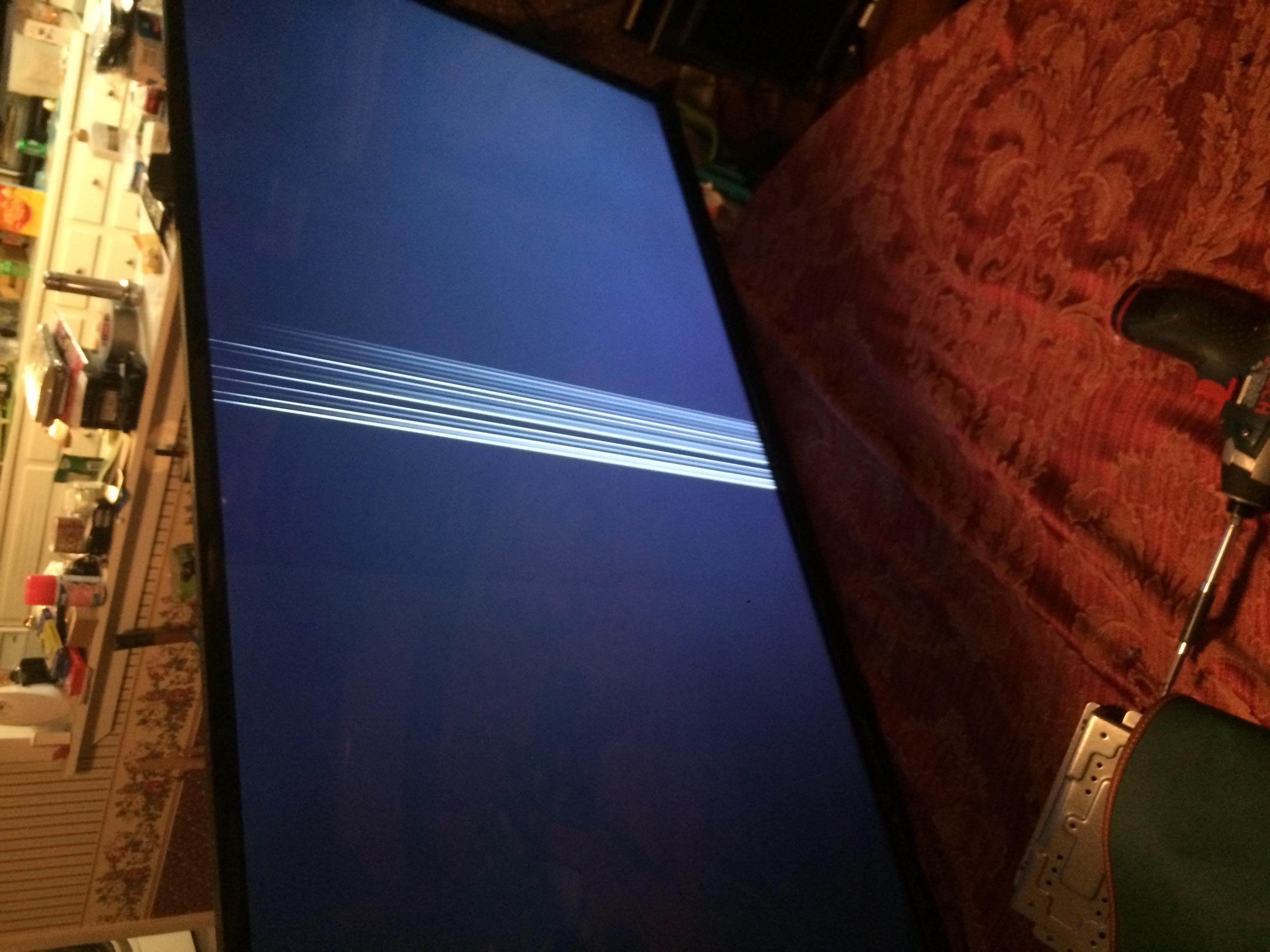

                • Jimmy60
                  • Jul 2014
                  • 17
                  Hello All;
                  I just replaced the full set of led strips in one of these being very careful with the screen disassembly and reassembly. I was not able to verify anything on this set except that voltage was being supplied to the backlights and they were not coming on. Feeling confident that this would be the only problem I proceeded with the replacement of the LEDs. Gonna attach a pic of what I have now and ask you what you think?
                    Bad Panel. Not worth fixing. Save parts for the next TV.
                    But you could try the trick with the rubber hose pressing on the tab bond of the screen. Budm has a post describing how to do this.
                      Sorry Jimmy,but that panel is damaged,either by handling the screen too rough or it was a pre existing fault.
                      You can try and inspect/manipulate the ribbon v]cable that lines up with the fault but am almost 100% sure it's a goner.
                      Take it as a lesson learned and move on to the next.
