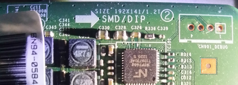

                As mentioned looked at BN97-05375B 0078 main board very closely.
                Am wondering if CN901_DEBUG (photo attached) is the EEPROM Reset is on this Main Board?
                Appreciate comments
                Ken
                  Re: Samsung main board BN97-05375B 0078 EEPROM Reset?
                  CN901_DEBUG is for UART communication, it is used to upgrade firmware factory level.
                  The art of fighting without fighting

                    hello fellow peers, scholars, and potential saviors...
                    ..after much searching for particulars about my problem with no luck, I thought to hijack this thread because the last post is just the segue to where I have wandered...
                    I have connected my PC to CN901_DEBUG out of desperation because of a firmware upgrade gone bad ( last thing displayed after reaching 100% was something like "unit will now power off for three seconds" ) - interestingly I discovered the need to set terminal baud rate to 38400 and the output is;
                    *MAIN
                    COLD Start
                    watch dog enable
                    LAST Power on
                    Start B Power Detect
                    Release MIPS
                    Hello A1
                    00442813
                    unsupport compress
                    set sound mode error1!!
                    Clock NG
                    ( then 'power up jingle' plays, STBY LED 6 flashes, then start again from *Main )
                    -essentially an infinite bootloop, minus backlight or sign of logo pixels, every 18 secs
                    -pauses after "COLD Start" while M_E_SDA shorted to M_E_SCL
                    -pauses after "unsupport compress" while M_E_SDA shorted to VCC or GND
                    -different board# than OP, but pictured holes/silkscreening/ICs are a match
                    -data on thumb drive used was since verified 100% against re'loaded FW from Samsung
                    -backlight illuminates when powered up, main board detached from PS
                    Would anyone venture to guess if there is recovery mechanism built into the initialization environment, much like found in routers - or is that just too impractical (fantasy) ? - only reserved for devices costing a fraction of what these command
                    Should I presume the flash is corrupt and not just the eeprom ? Or can the latter have such a dramatic effect ?
                    I'd really prefer the satisfaction of solving rather than board swapping - especially since there wasn't any 'problem' in short time since adopting it, that is until a fateful desire to update - if I can even be referred to the appropriate forum/resources, that too would be kind

                          I concur that it requires a total boot to have the required functionality to perform eeprom regeneration, factory reset, enable ex-link port, etc - so whether caused by bad flash or fatal eeprom glitch, the problem can only be solved externally ( or with factory procedure/inside information ) - I will report back anything I learn that might help others - meanwhile thank you both for replying to me
