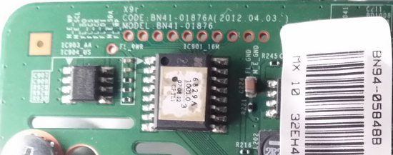

    A friend has a Samsung LED TV model UN32EH4003FXZA that has an Over the Air Station Search Loop (keeps repeating Chan 14 and can Not get out using Mute>1>8>2>Power On).
    After much searching we found "UnBricking TV by EEPROM Reset" https://wiki.samygo.tv/index.php5/Un...y_EEPROM_Reset
    The Samsung TV Main Board Sticker is BN97-05375B 0078
    L6 C 08/08/2012 20:56
    We are trying to determine where the EEPROM Reset is on this Main Board?
    While "UnBricking TV by EEPROM Reset" does have photos for many different Samsung TVs we could Not find any similar to the BN97-05375B 0078 board.
    We also searched using "BN97-05375B 0078" and found "Samsung BN94-06008X (BN97-05375B, BN41-01876B) Main Board"
    http://www.shopjimmy.com/samsung-bn9...eh4003vxza.htm
    Should mention we have done a number of searches to try to find the Samsung LED TV model UN32EH4003FXZA Service Manual but have found Nothing to date.
    Appreciate any Help!!!

    IC901 is the eeprom.
    Eeprom software: SAMSUNG_UE32EH4003W_24C256_IC901.BIN - 32.0 Kb

        Hi victor_cj,
        Thank you for identifying eeprom as IC901 and eeprom software link!!!
        Please excuse my Bad English "We are trying to determine where the EEPROM Reset is on this Main Board"
        Should have said "are trying to find the 2 jumper holes so we can do the eeprom reset.
        This video may explain it better "samsung smart TV D5700 eeprom reset, bootloop, boot schleife, factory reset" https://www.youtube.com/watch?v=DDzOSdfA41s
        Except could Not find the jumper holes that he used (video ~ 1:40 to 2:25 minutes).
        Thanks again for your help!!!

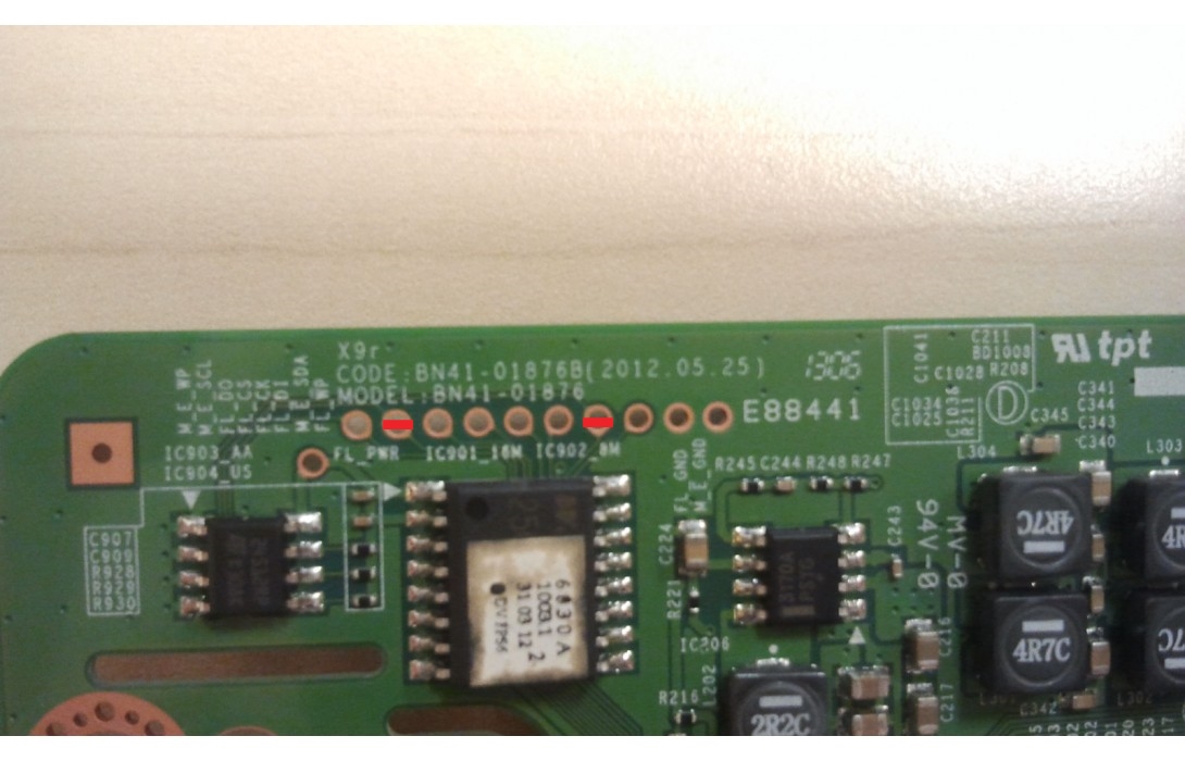

            • victor_cj
              • May 2015
              • 90
              • Romania
              Re: Samsung main board BN97-05375B 0078 EEPROM Reset?
              The holes marked with red must be united.
              M_E_SCL and M_E_SDA.

                  • KenOlson
                    • Jun 2011
                    • 81
                    victor_cj,
                    Thanks for posting photo of which holes to connect!!!
                    Does anyone have suggestions/tips when do a board reset?
                    Ken

                                    • victor_cj
                                      • May 2015
                                      • 90
                                      • Romania
                                      Originally posted by KenOlson
                                      Is 20 seconds the recommended time for Samsung LED TV eeprom reset?
                                      12 seconds is enough.
                                      There have been situations when the problem was caused by BGA connection from Scaler or flash nand memory with bad blocks.
