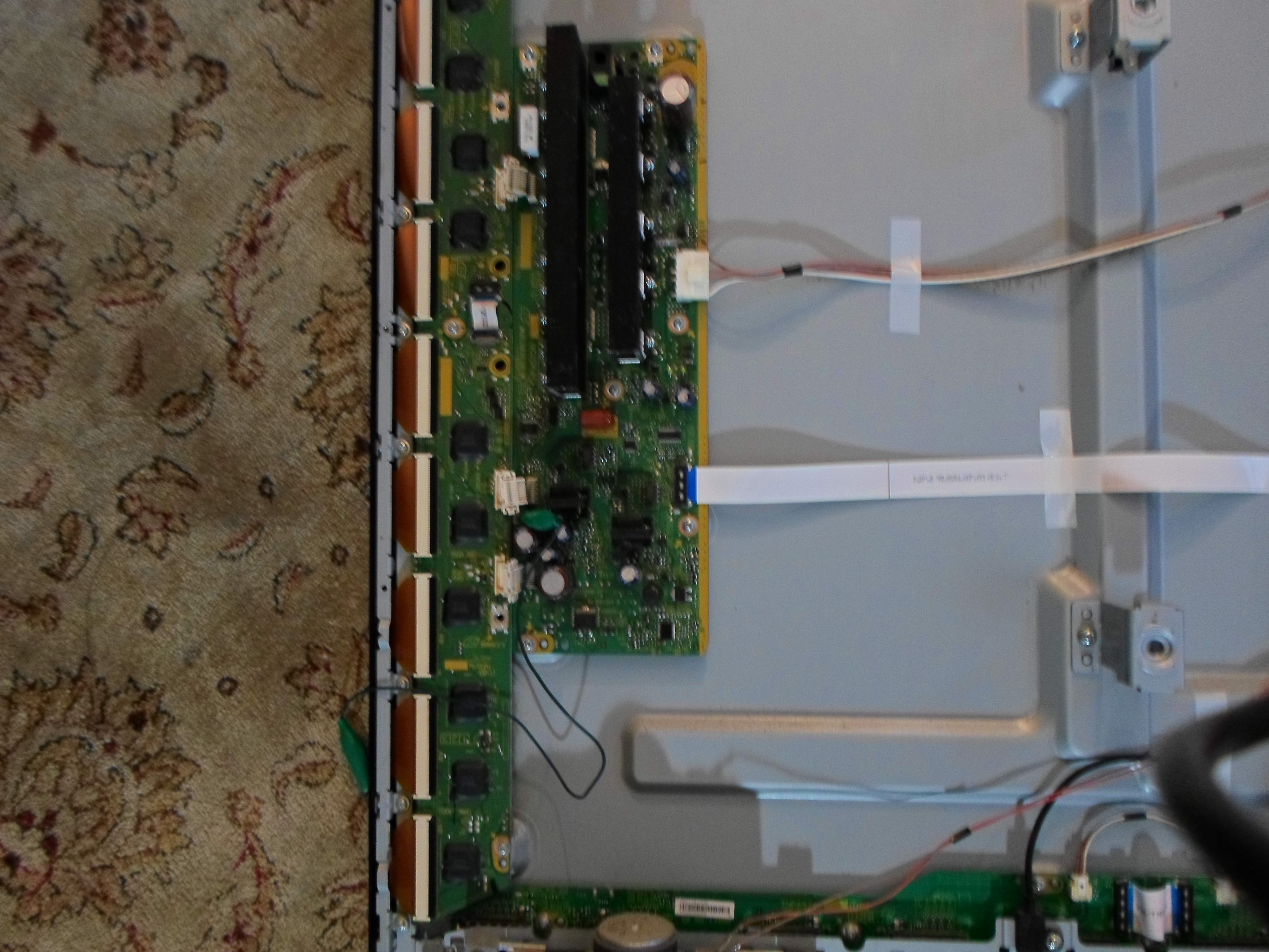

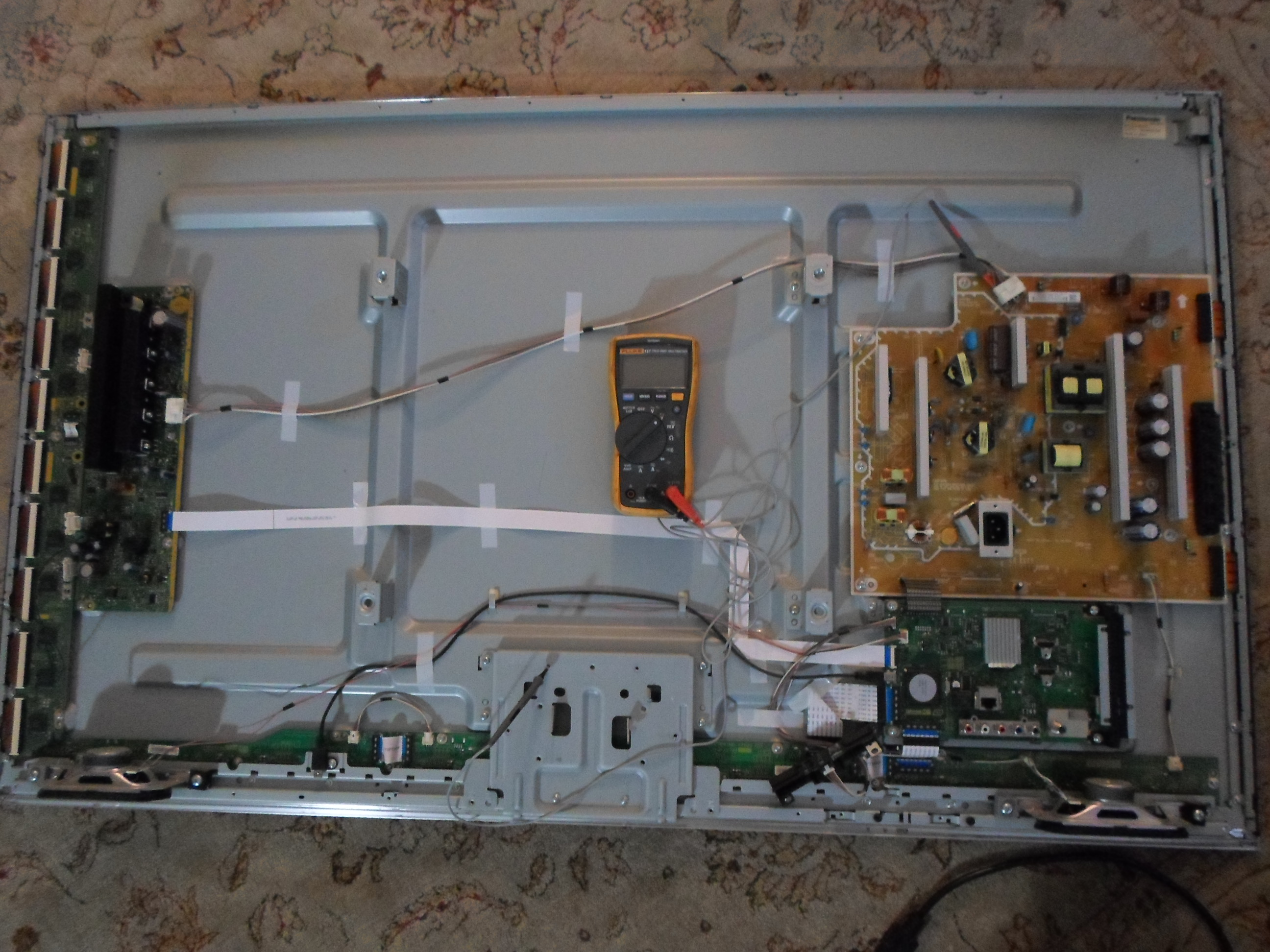

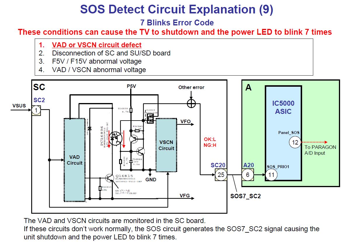

    I got this TV from someone who said it would not turn on, and had the 7 blink code. When I brought it home, it turned on and worked with no problems. I tested it for a while OK, and gave it to a friend.
    A few days later the TV started the 7 blink code again. All signs pointed to the SC board. I replaced the board and the TV worked again. But it was still intermittent for a while, and now won't come on at all again.
    I did the process of bypassing SD and SU, same 7 blinks. I have the normal 5V and 15V voltage on the SC that are part of the voltage check on startup..
    The Vsus is where the problem seems to be. With the SC disconnected from the power supply, the Vsus comes up steady to around 208V. With the SC plugged in, it comes up to around 208V but fluctuates rapidly until the 7 blinks start (It only gives it a second or so for the test before shutting down).
    I'm thinking maybe the power board Vsus is breaking down under load.. Any ideas on how I can troubleshoot this?? Thanks!

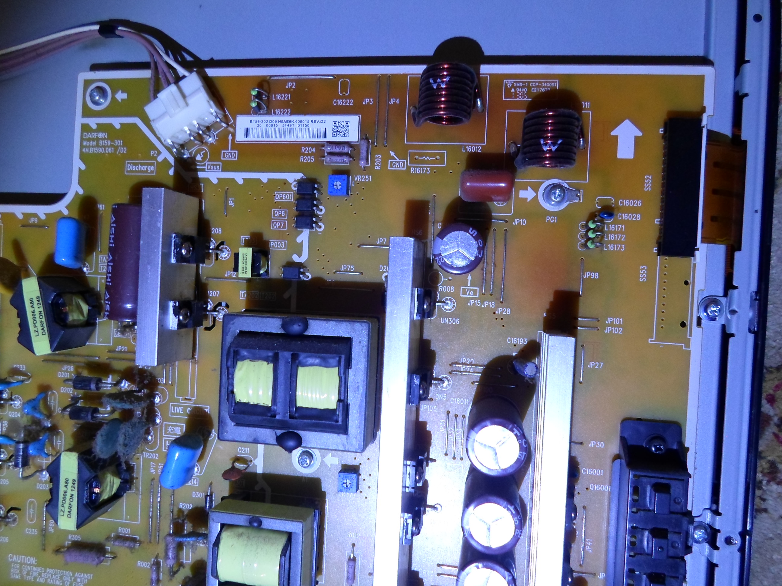

    EDIT: Last pic, may be hard to see, but board is discolored from heat around Vsus circuit..

    Seems like SC is shot again and is loading down the Psu. Have you checked the SC for short circuit ?

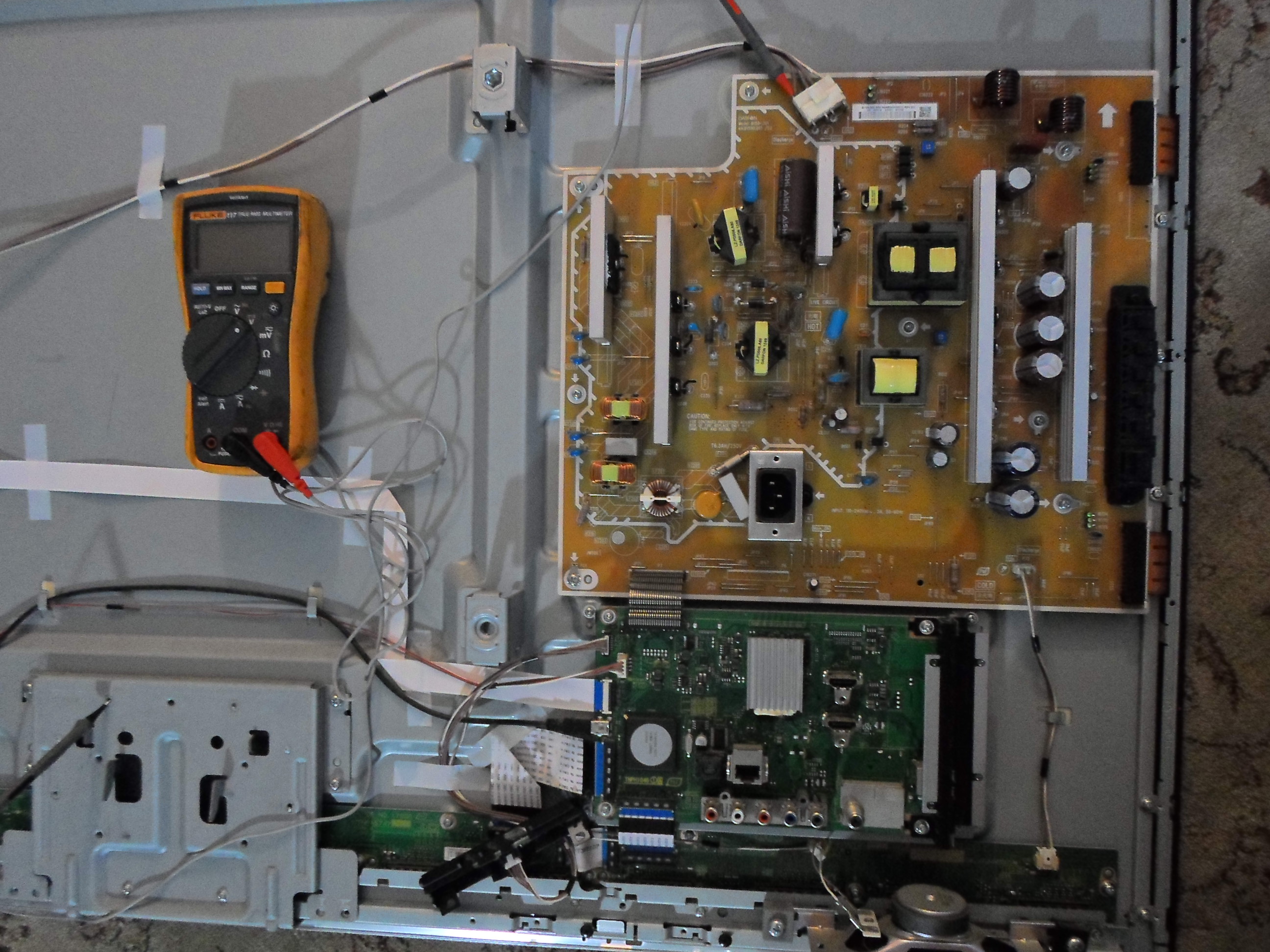

      There is nothing obvious.. the test points in the TM that are checked:
      Vsus to GND = 15.00M
      VFO - VFG = 0L
      F5V - VFG = 55k

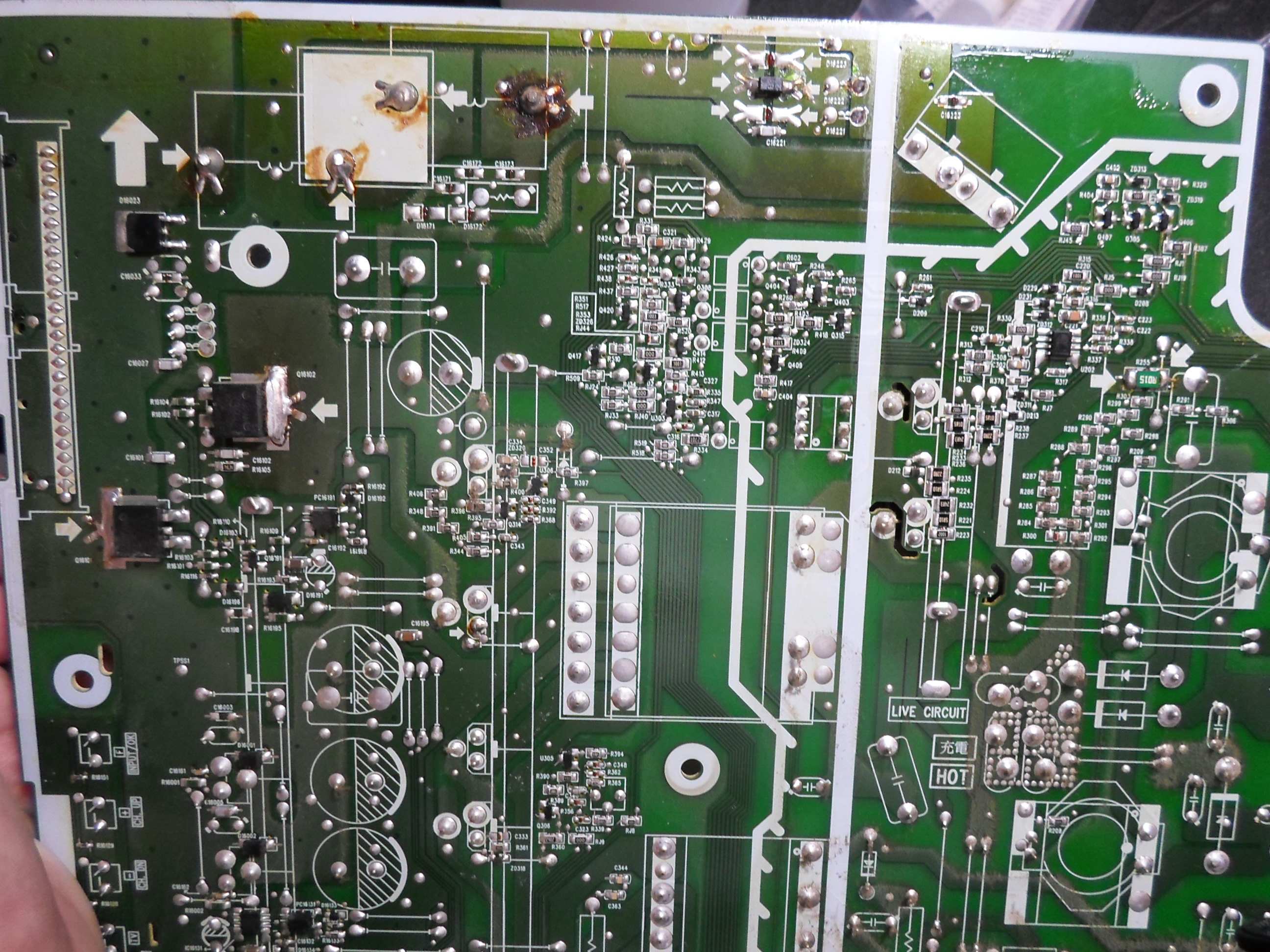

        I was hoping maybe a bad solder joint on the power board.. What's the likelihood of the SC board being intemittent initially (enough where the previous owner could not get it to work at all anymore), then it works fine for me for a while, then problem repeats.. And then repeats again after replacing SC board?? Does the heat damage on the PS board tell anything?
        Attahced is underside of where board was discolored..

          That really brown inductor leg looks really suspect. I'd cleaning that up desolder and apply fresh solder

            7-blink implies floating-supply issue--commonly associated with buffers.
            Remove buffers, link SC50 and re-try. If set runs--buffers are faulty.

                I am thinking it's the PSS. If the voltages going to the SC are erratic then the SOS circuits are going to trip once they're out of limits

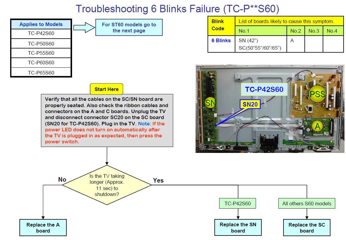

                    Reading the SM again I see this, exact symptom to what I just posted above... Keeps pointing to SC board.. What's the odds the 3 of these are bad, and intermittent at times before??
                    Also there is no sticker that I can find on the panel (MC127FU6A11), where can I find the proper voltages to test? Not seeing in the SM or TM either..

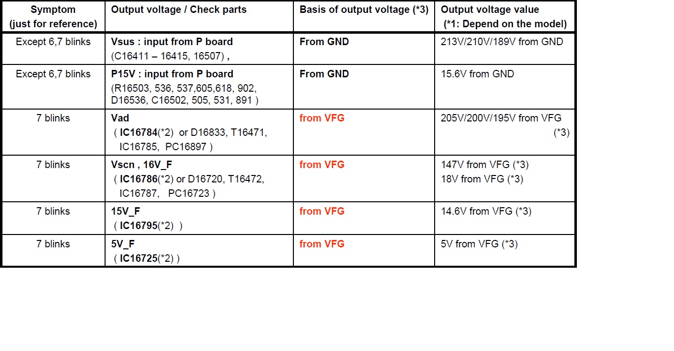

                    Vsus = 207V
                    VFG = -195V
                    VAD = 200V
                    VFO = 148V

                      It could but since you disconnected the SC20 and it stayed on for 11 secs and went 6 instead of 7 I think not.
                      2 SC boards both 7 blink with Sc50 jumpered, would think it points to SC but you said the volatages were erratic on Vsus . Is that the case or s it just the meter not refreshing quick enough?
                      Can you find any Transistors shorted on both SC boards?

                              So you need to give me the gnd point s for each of these.
                              207V Vsus is not an issue, t's ball park
                              Vfg -195V with respect to what? On the 2011 set to gnd -160V
                              VAD if in respect to Vfg the I get about the same, to gnd 40V ( could be + or minus I forgot to check)
                              Vfo 148V, no idea and I'm not going to tr and find a test point for that one in case I short something out.

                                VAD and VFO I believe were floating ground, the rest to chasis ground.

                                        did'nt you say sc50 jumpered it fails too? That's with the SD/Su disconnected yes?
                                        Just going through some other docs, all those volatages appear to be normal.
                                        VAD - Vfg 200V
                                        TPSC1 - Vfg 147V (Vfo)
                                        F20V - Vfg 18.6V
                                        F15V - Vfg 14.6V
                                        F5V - Vfg , 5V
