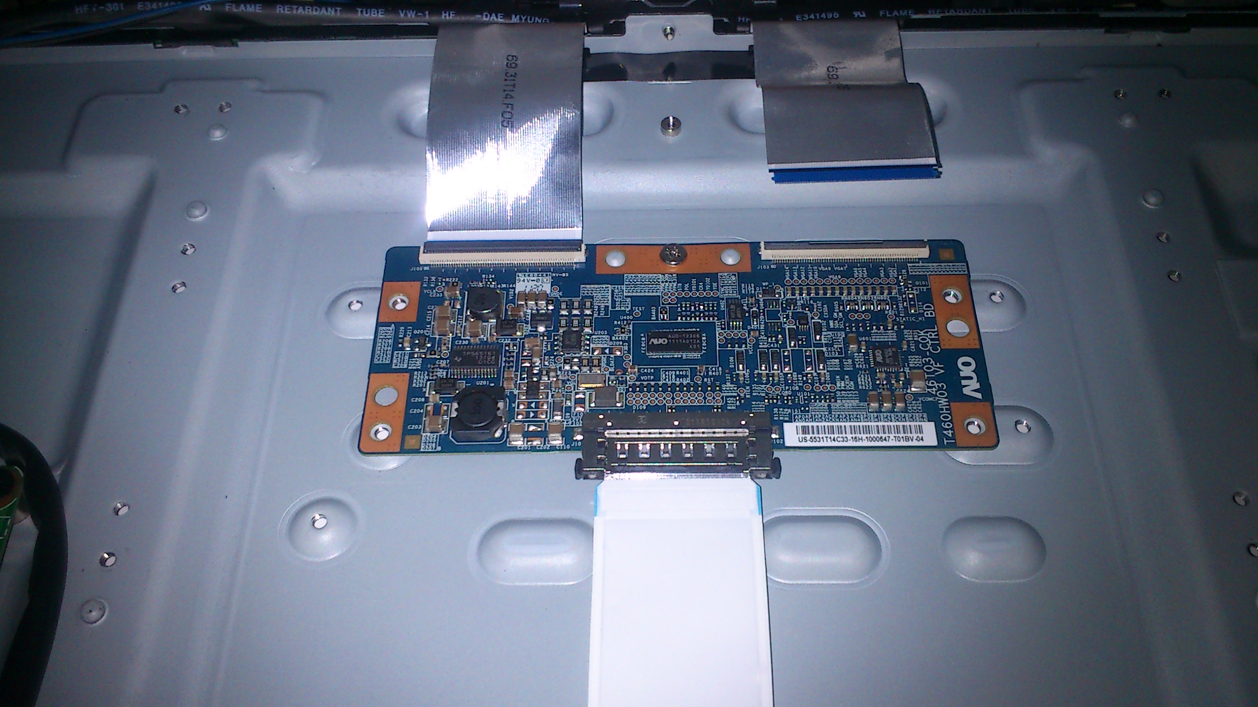

    hi everyone can someone tell me which board has the problem . i think it may be the t-con .i would like some help please. thanks
    Re: lg 32lv3550
    That is a good one.
    Did you try re-seating the cables? Try having just one cable between the T-con and the LCD panel connected one at time?
    Good Visual inspections of the boards?

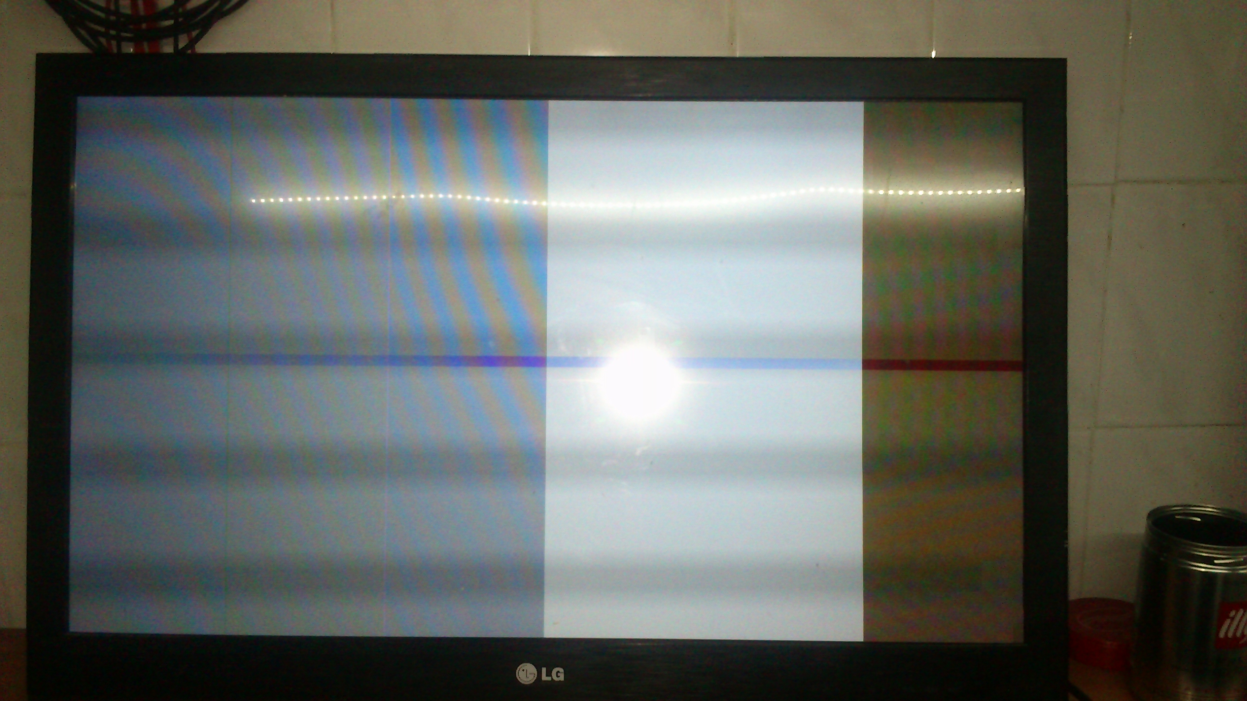

      i tried re-seating and with one cable switching them and this is what it looks like

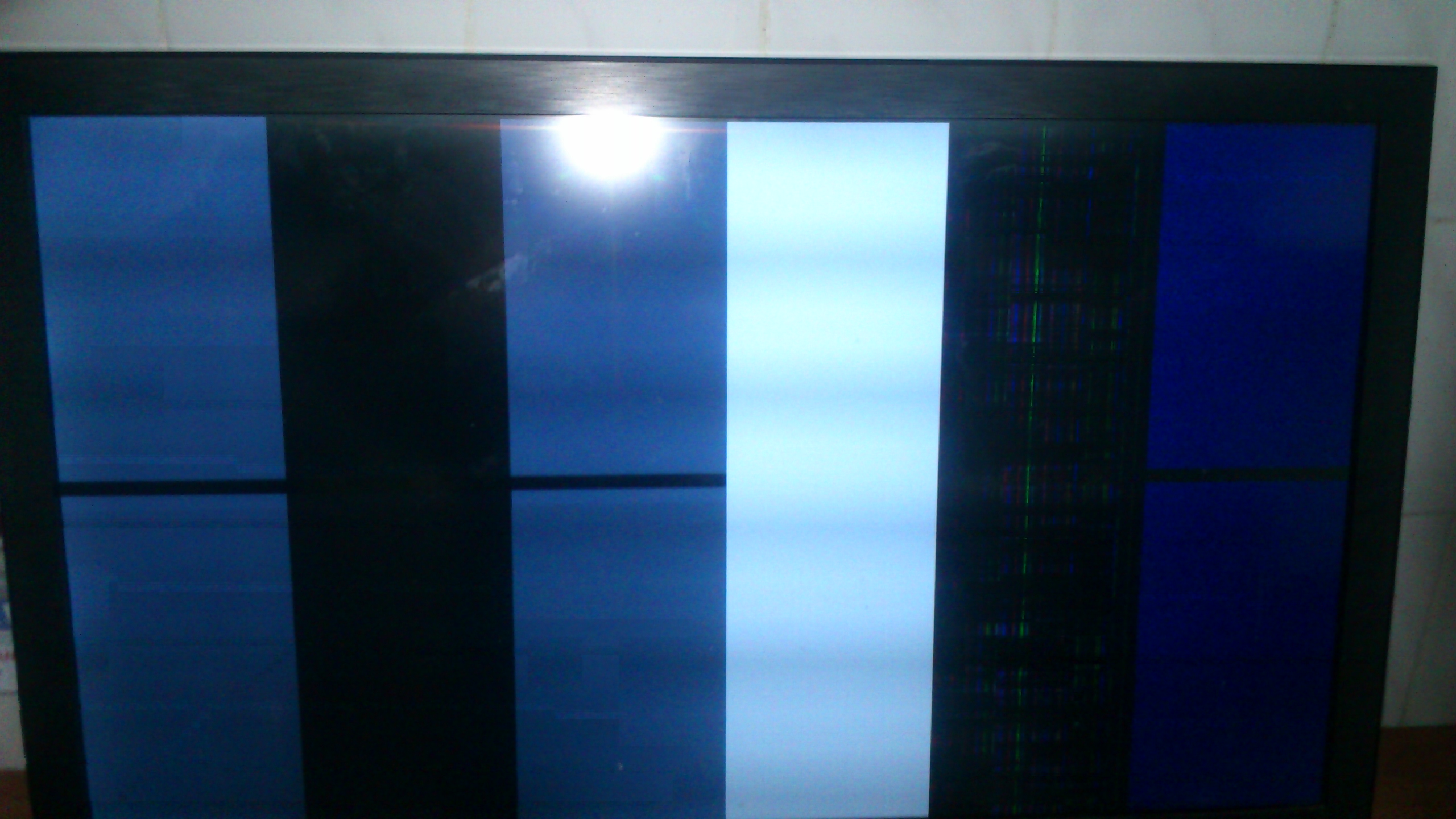

        Plug that one back in and remove the other see if the pattern changes.

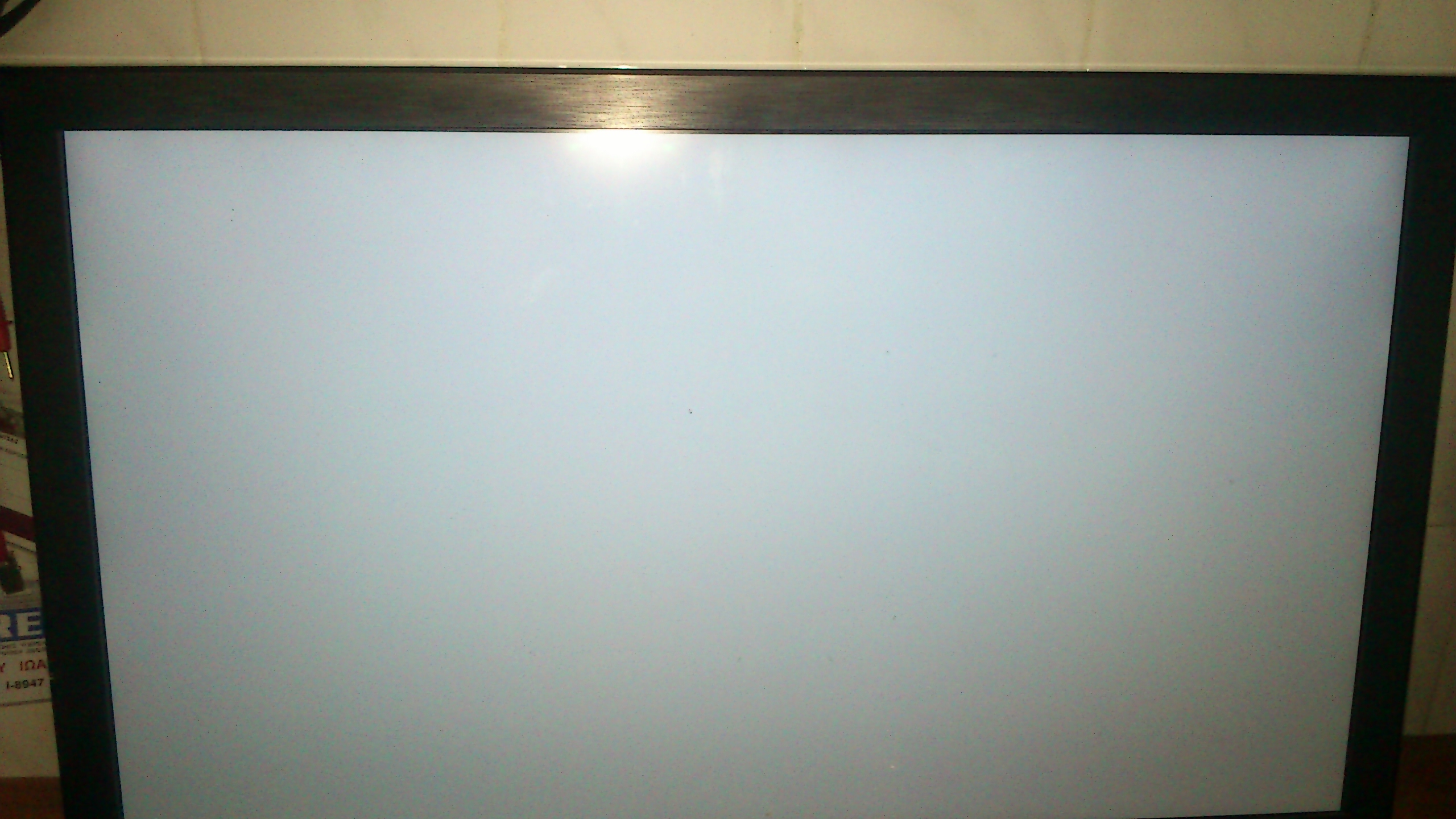

          it changes thats what i did i switch them the 1st is with the lines and one ribben is out the 2nd i switch them and it looks white any Idia .thanks

            Faulty Lcd panel, possible that you have a water damaged screen. Most likely not fixable.
