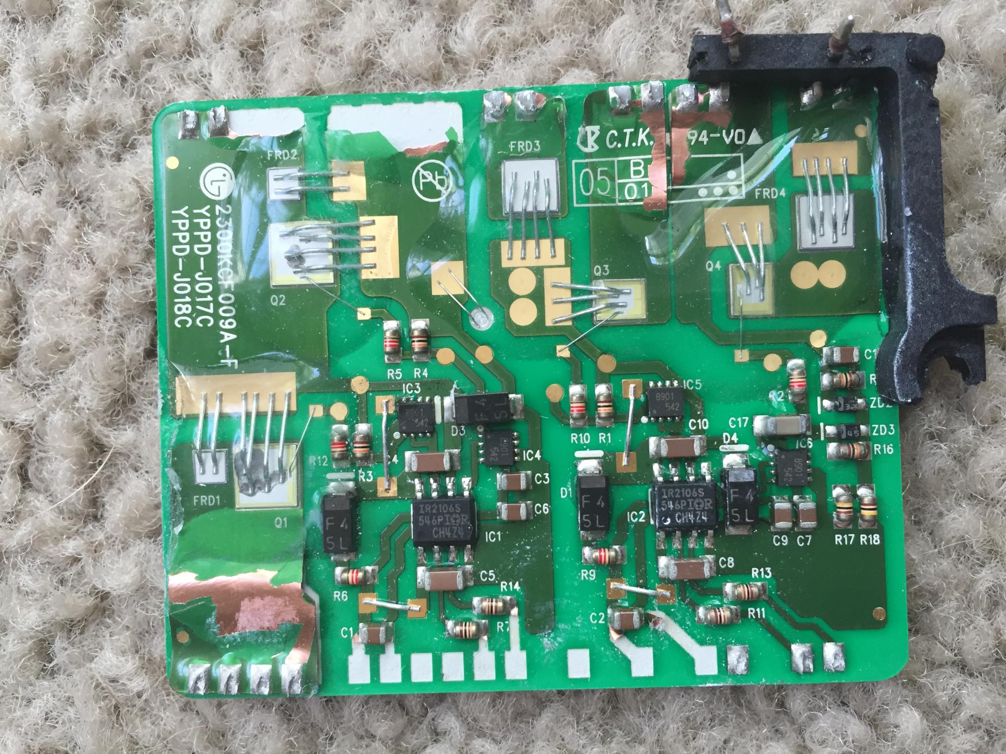

    The seller is sending out another zsus, told me I don't need to return the old one so I guess I can try to fix it.
    I watched a YouTube video on the repair but it didn't show how you get to it. Do I unsolder the heatsink from the board? Seems the only way as there are screws from the bottom but can't be accessed till the whole thing comes off.
      Re: Lg 42pc3d weird picture.
      Easiest way, takes 20 seconds max--IF YOU ARE NOT WORRIED ABOUT THE IPM--
      Neanderthal Method--
      Take large flat-blade screw-driver and break IPM from board, using screw-driver as lever.
      --Then desolder each pin stump one by one.
      --Board will not be damaged unless you are foolish and use a sharp ended screwdriver that digs into board, the IPM pins pull off the IPM print carrying the plastic strips each side.
      Motor-Mechanic method--If you want to Re-Use IPM/Repair it.
      Take two 4" pieces of 22mm copper water-pipe and flatten them. Screw the two flat copper strips produced together one on top of other, making a sandwich, the sides closely mating.
      Hold in clamp-wrench approx the middle and heat with blow-torch till solder will tin the edges where the folded copper pieces meet, Then heat till flame glows green and apply to all the IPM pins on one side at once--the pins will nestle in the groove made between the two coppers, add some solder making sure all pins get some, leave for a few seconds for heat to soak through, then carefully lift that one side out from board. No Force is needed.
      Re-heat and do same other side.... Takes about two minutes (With MAPP-Gas, bit longer with Butane)
      Clean up the board as usual, HOT iron needed as the heatsinking effect of the board/print is something fierce with these multi-layer thick copper print boards, and the main reason its such a huge chore to remove one with standard issue tools!

          I just used the somewhat brute method. First I tried to unsolder it. Hoping it would fall right off but I guess not enough solder was removed.
          Then I used the screwdriver.
          The video I watched showed the guy replacing Q1 and Q2. They both have dark spots in them.
          But I'm pretty sure this IPM is un repairable.

            May well have been repaired--But, NO NEW IPM's exist--LG Never sold 'em separately!
            ALL the IPM's Everywhere are recovered from used boards....
            Your 'new' IPM could well have 20,000 hours on it--and be on its last legs due to Black-Pad Syndrome....
            eBay has these IPMs for about $25. Including shipping.
            Alastair said no new ones exist. These are labeled new, of course they are from China...
            Lol.
              Yup--Ive bought those, VERY careful examination will show minute traces of heatsink compound, witness-marks from screw mounting--but more importantly--the id mask near the transistors/big diodes has turned pinkish/purple instead of being white like that at cooler parts of the circuit....
              Ones Ive bought did work however....
              Be aware--these fail in two ways. One you know. Other is where they become intermittent and give a flickering/grey picture. Sometimes this preceeds self-destruction and short-circuit...
              All because the substrate is -gold- plated causing black-pad over time heat-cycling....

                  Thanks but like you said, still used. Installing one seems easier than repair on one as the guy did on YouTube.
                  Can I use the same thermal compound as I use on CPUs?
                    #29
                    yes--any good thermal-paste will do, just dont make it too thick or come into contact with the pins--Some of the grey type over time can conduct at the high voltages on IPM's...
                    Good S/H is about all there is--Unless you can find an unused new complete X--They do exist but obviously--Expensive....
