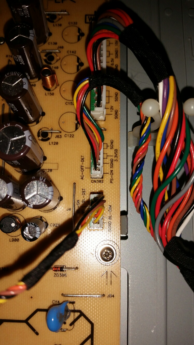

    TV was broken when I found it. No backlight, sound, or picture. BL_ON stays low regardless of power state. Disconnecting CN303 (the cable that includes BL_ON) shows 5.3V for BL_ON on the power board and BL_ON never changes state on the "A" board. BL_ON is 150 ohms to ground on the A board, which I'm assuming is not a short. All 15V, 12V, 6.5V, and 3.3V secondary voltages are present. The replacement board ordered from a business online does basically the same thing (difference explained in the questions below). Arrived in a heat-sealed plastic bag but the board was pretty dirty.

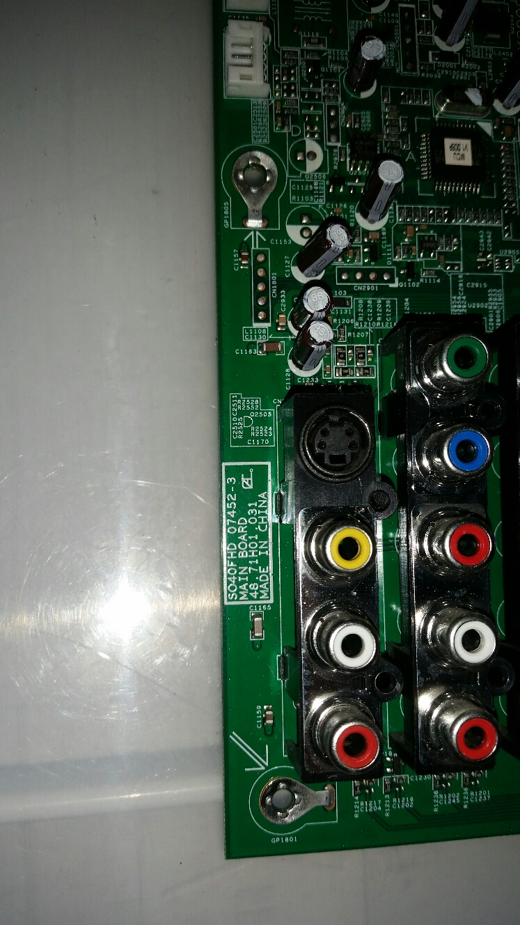

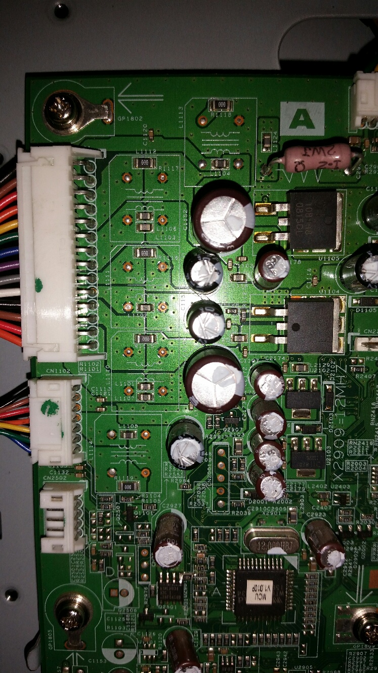

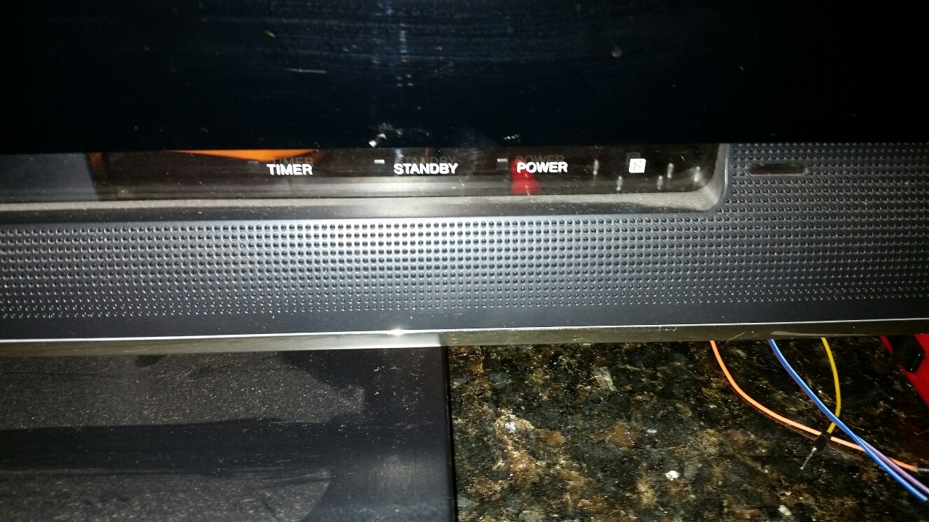

    Hello BadCaps! This is my first real TV repair so I thought I would ask the experts before returning a replacement A board I just bought. It seems to hang at the same step as the original A board, which makes me think I might have dropped the ball somewhere while diagnosing. The troubleshooting flowchart in the training manual (see attachments) points to only one culprit though (namely the A board), and looking at the test voltages I can see that the BL_ON signal at the "A" board is the hold-up. I assume it has to start HIGH on power-up and then be pulled LOW. The G board is supplying 5.3V to BL_ON but the A board is pulling it low no matter what. If there is any change in voltage when toggling states with the power button, it's too fast for my multimeter. As a last resort today I followed advice I found somewhere online and toggled the TV to ON, waited a bit, unplugged CN303, and then jumpered BL_ON (from the G board) to SYSGND on the same connector (CN303) to see if I could get the backlight to come on but no dice. I assume SYSGND is what they meant by "ground", though I doubt it matters.

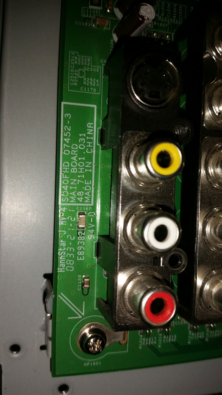

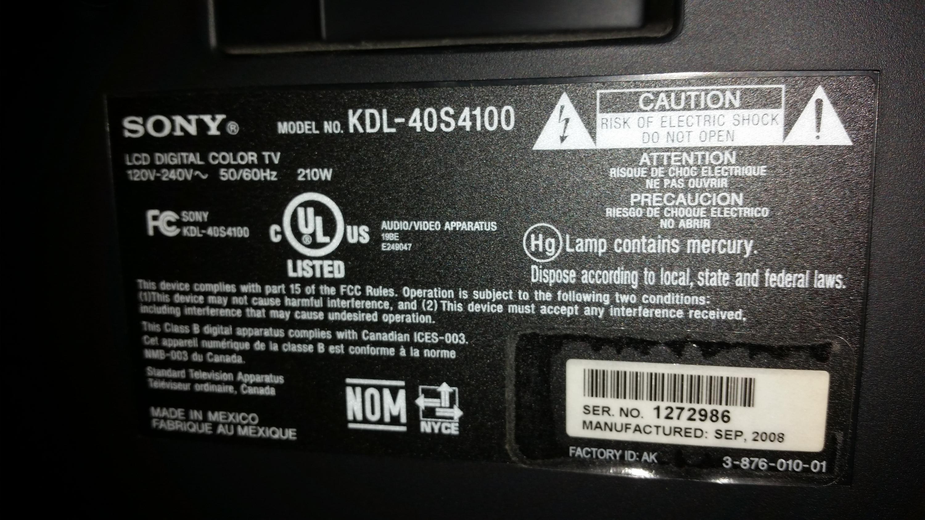

    The particulars:
    Sony Bravia 40S4100
    48.71H01.031
    1-857-092-11
    Serial No. 1272986

    CN303 disconnected, tested at A board:
    BL_DET 3.28 3.28
    BL_ON .05 .05
    BL_DIM .04 .05
    GND 0 0
    CN303 disconnected, tested at G board:
    BL_DET 0 0
    BL_ON 0 5.34
    BL_DIM 0 0
    GND 0 0

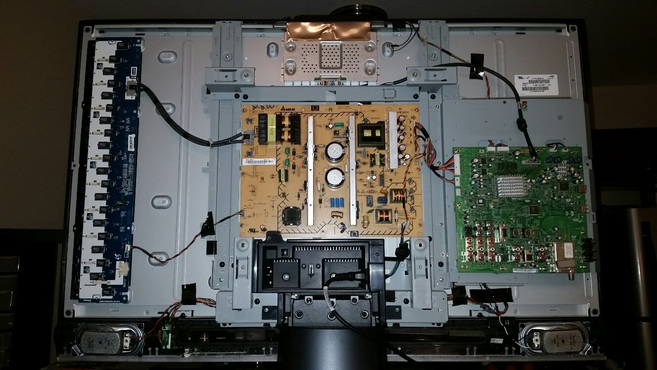

    1) TV is plugged in, nothing apparent happens. I assume I should be seeing a standby light. See the attached picture "front indicators"
    2) I toggle to ON using the buttons on the top of the TV. The green power indicator lights up immediately, not in ~30 seconds (as a number of sources and perhaps the manual suggest) and the relay clicks/pulls in. Nothing else seems to happen even if I leave the unit on for an hour. This model does not have blink codes.
    3) I toggle the power state to OFF using the power button on the set. The green power indicator on the TV turns off immediately. No other lights come on. I hear a relay click.
    4) I unplug the power. 30 seconds later I hear a relay on the G board click. I start to feel uneasy, as this is an odd number of relay clicks in a full power cycle . If I plug in, wait a few minutes and touch nothing, and then unplug, one relay click. There was no warning sticker regarding voodoo (lawsuit waiting to happen, Sony) but I've come too far to turn back now. Maybe voodoo was making it work in the first place and some got out? Probably one of those "cheaper to just buy a new TV" repairs. Anyway...
