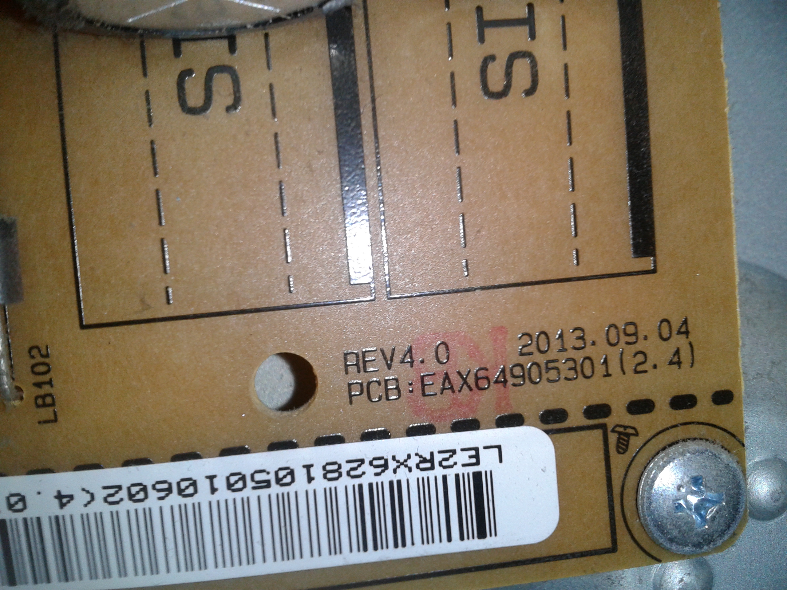

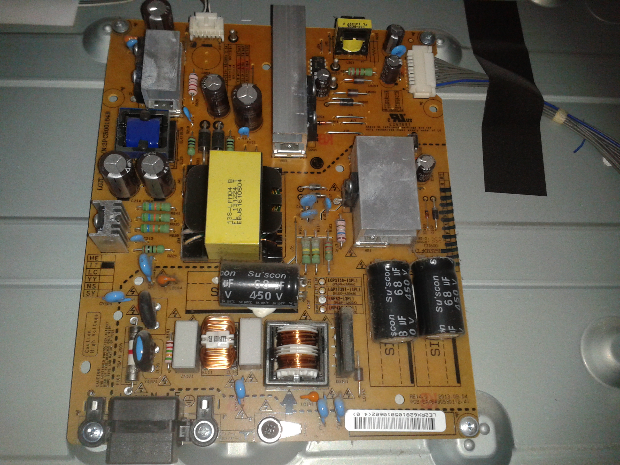

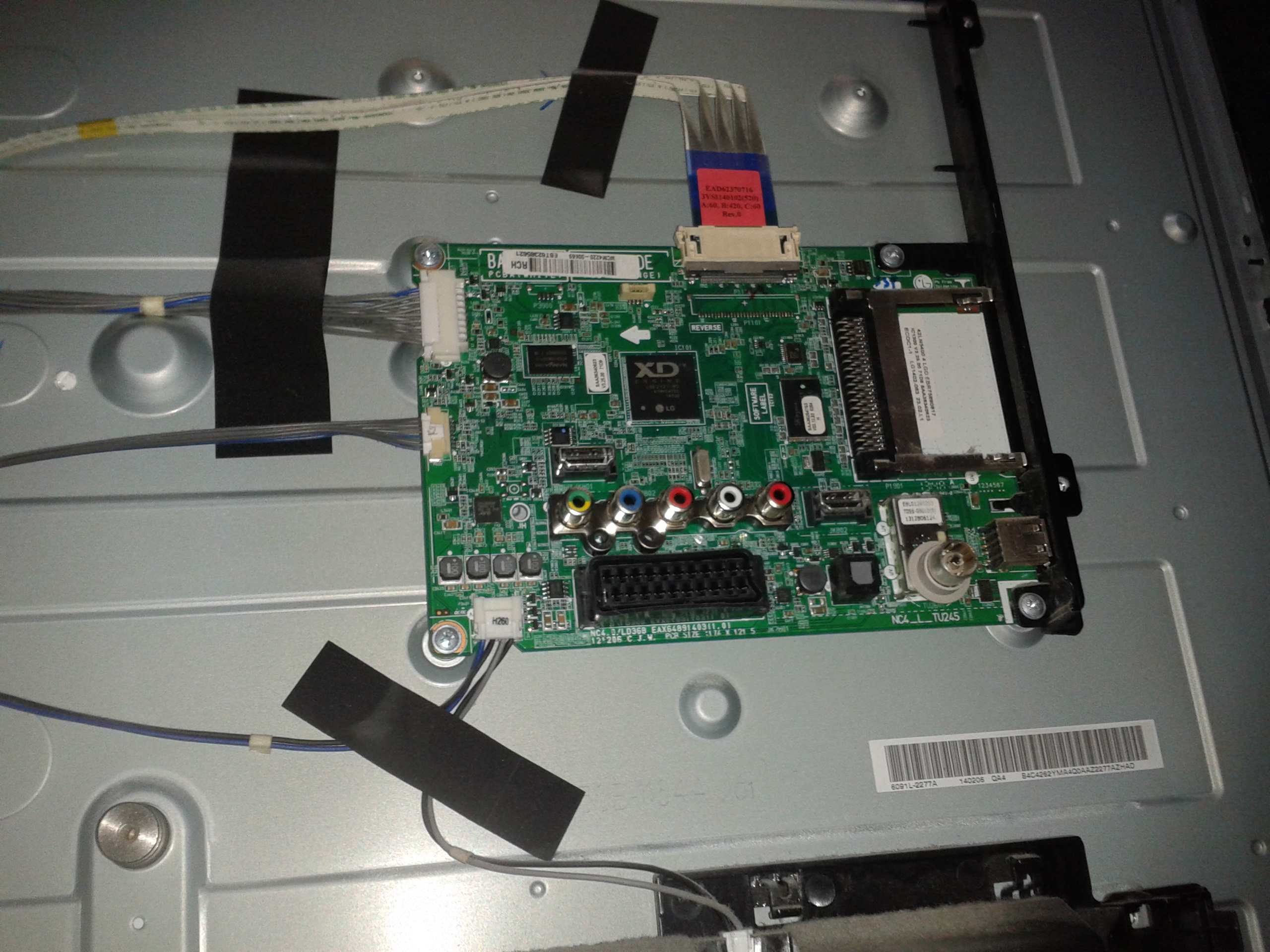

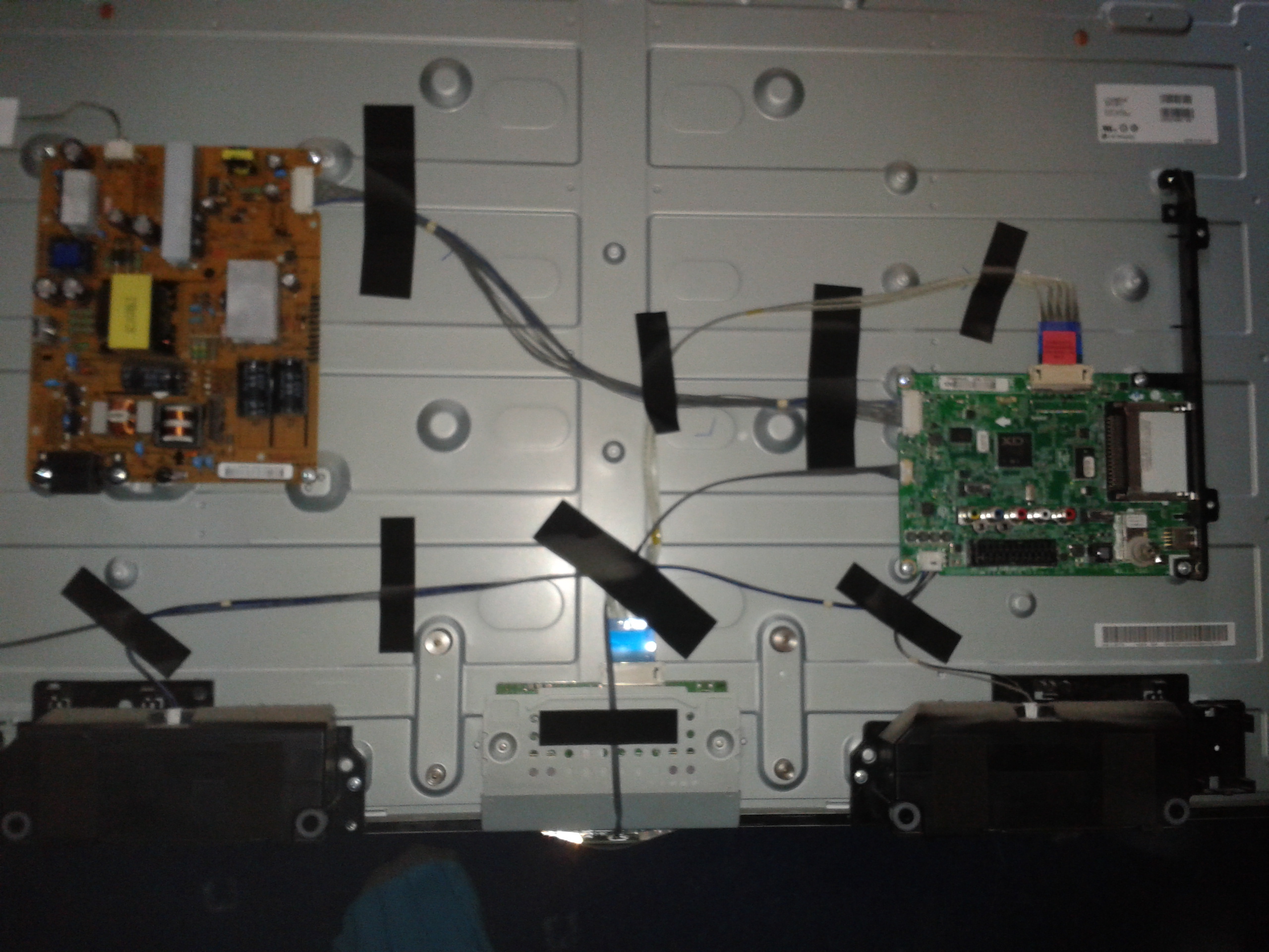

    Posting pictures of the back of your tv showing the boards with clear pictures may help you more with fixing your problem

      Hi, took some images the best i could don't have a decent camera

        interesting fault, from the point quoted you have 3 or more LEDs Open. other could do this if the dimming IC you will find it at the bottom of PWB had bad soldering or some SMT parts related .. would be nice if you post photo of the bottom of PWB and tell IC No.
