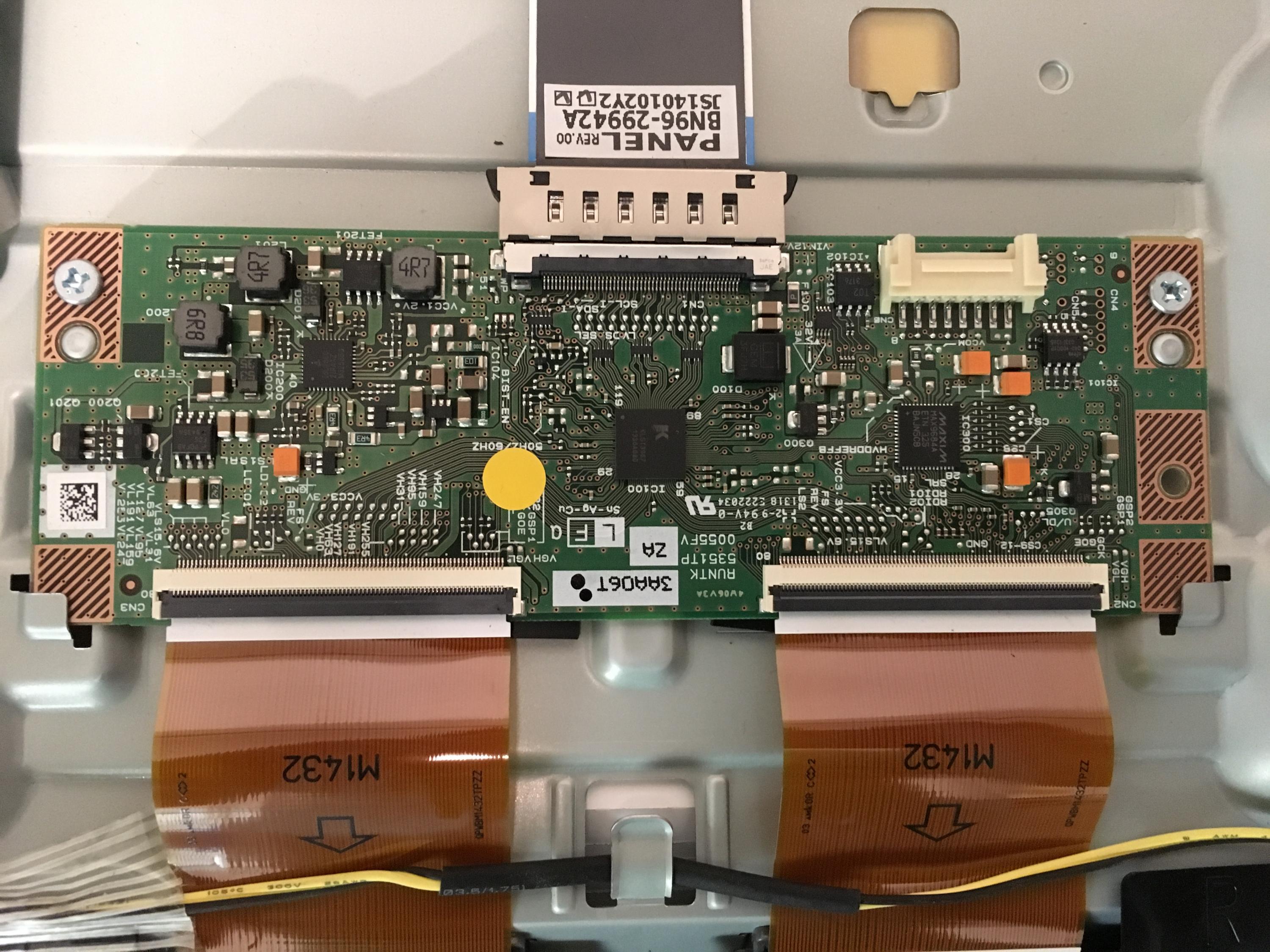

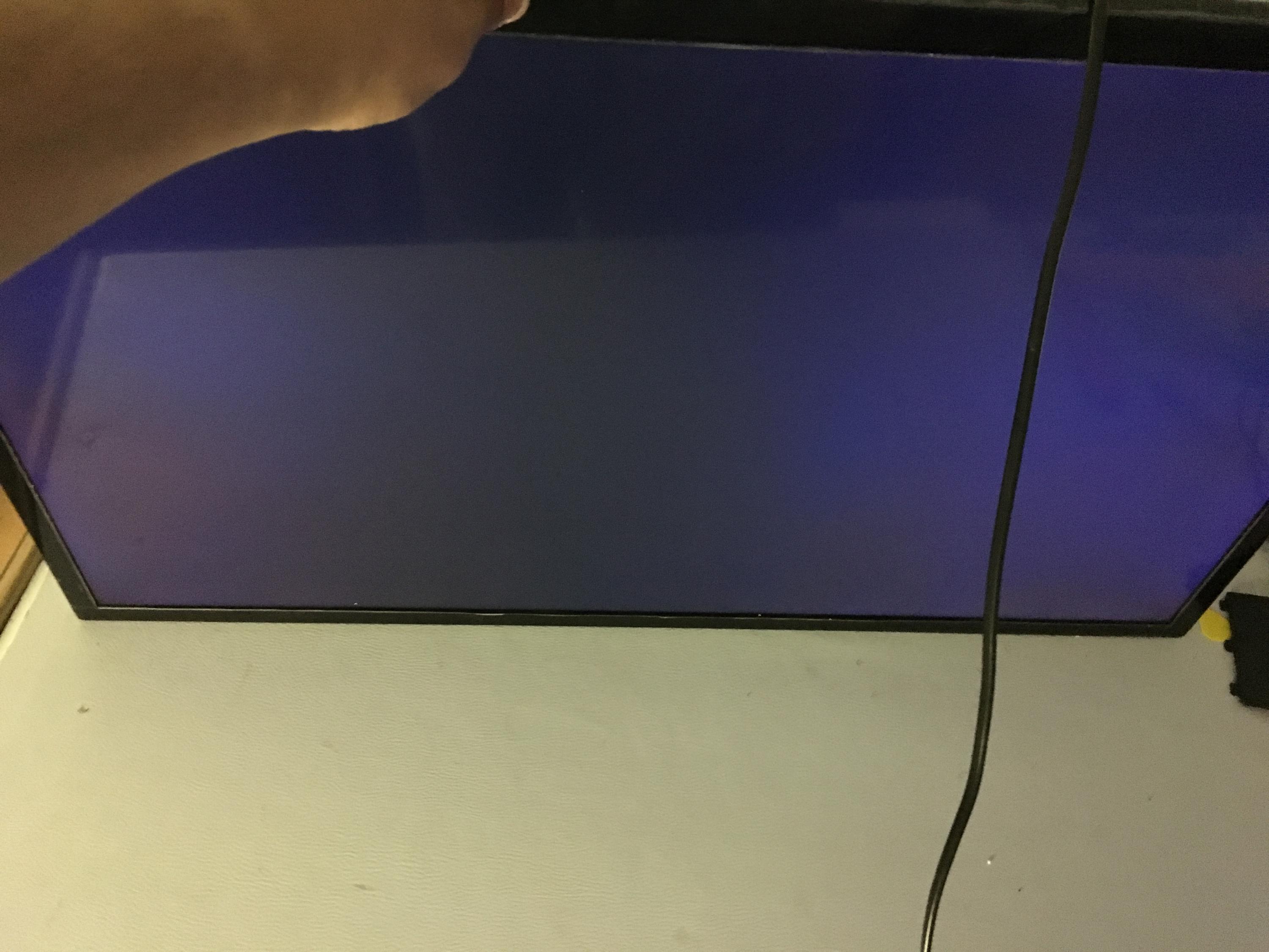

    Hello, i got this smart TV that turn on and dont have picture.
    Model: Samsung UE32F5500AW
    When turn on backlight is turn on, and all other function work but no picture.
    I check voltages on PSU it have 13V and 5V
    Tcon board have 13V on some parts, some are 0.2V
    Any ideas?

    What do you get if you only has one ribbon cable between the T-CON and the LCD panel connected one at a time?

      Re: Samsung UE32F5500AW no picture
      I get the same thing, only backlight turn on.
        I have the same Tv same issue and Ic on the Tcon is failed. Will link thread.

          Check this out, test Ic200 against the schematic. I have mine on order should sort it:
            On the Tcon board there is a fuse F100. Have you checked if it has blown open circuit. There are also other points on the TCON board you could check.
            VGH, VGL, VCC1.2V, VIN12V
              Hey i check some pin on ISL9860
              pin 39 (SWOUT) - 0V
              pin 12 (GHC) - 0V
              pin 13 (GHD) - 0.2V
              pin 20 (PHASE2) - 0V
              pin 30 (PVIN) - 13V
              pin 8 (DRVP) - 0V
              So i guess that it has no output.
              Fuse F100 - ok
              VGH - 0V
              VGL - 0V
              VCC1.2 - 0V
              VIN12V - 12.9V
                it does look like IC200 is the problem then.
                    Same here deffo common on these. Heat from under the board to remove and replace the chip. Also dont forget to heatsink the replacement to help improve reliability.

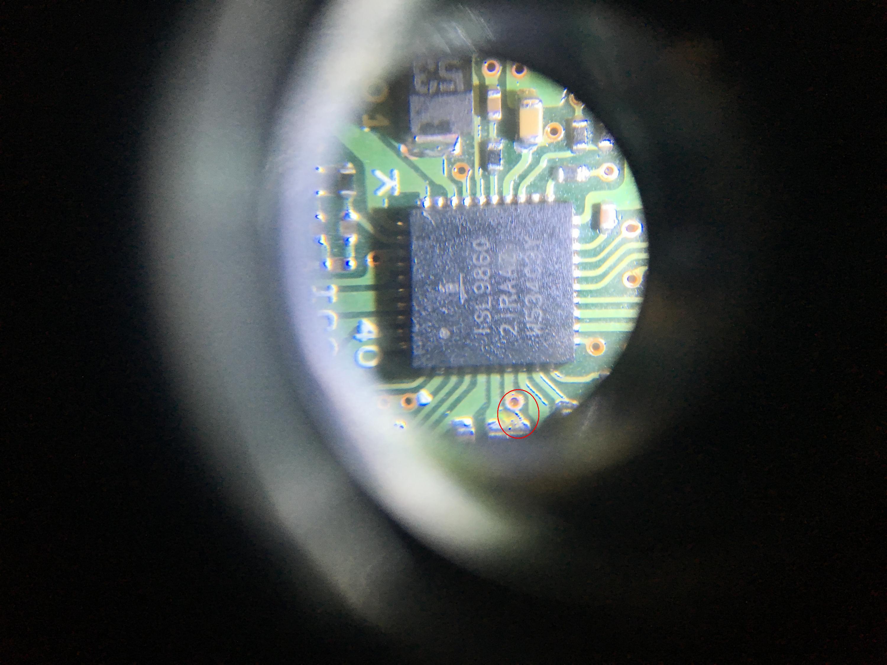

                              Hello i replace the IC200 but still no picture. Now the IC is getting hot, i check for shortages but there is no short in solder pins
                                  I order 5 of those IC, i can solder another one but i doubt.
                                  Here is the photo of my solder (i use hotplate)
                                    Hmm looks good, unsure tbh maybe your main processor is fried as well ? Will see if I can find anything on the internet about this board.
                                    • Diah
                                      • Feb 2013
                                      • 6435
                                      on the photo you have short contact at pin 7 with No 6 its solder running down.. take a look
                                        well i put new IC again, and not i do not have overheating (still no picture)
                                        i check voltages and here is what i have now:
                                        pin 39 (SWOUT) - 0V
                                        pin 12 (GHC) - 0V
                                        pin 13 (GHD) - 2V
                                        pin 30 (PVIN) - 12.9V
                                        pin 8 (DRVP) - 0V
