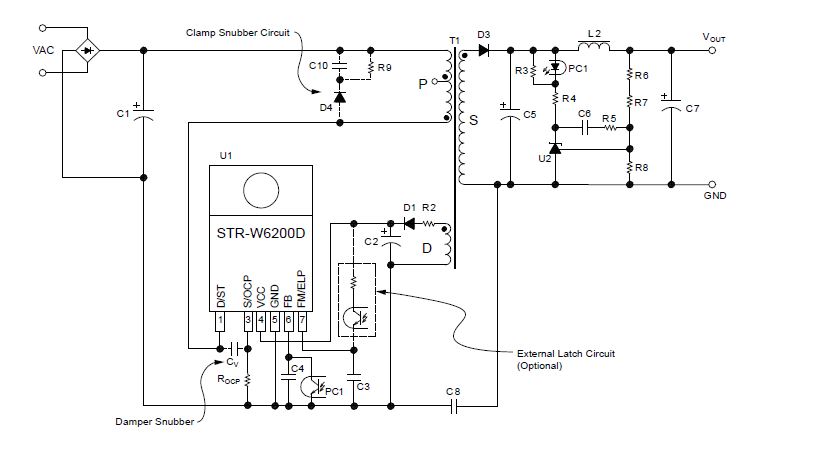

                I think you count the pin number wrong, pin 4 is VCC not Ground pin, as you can see pin 2 is cutoff.

                    Re: Clayton 19" LCD TV - Dead PSU
                    VCC needs a minimum of 13.9V to maintain it's operation on its own if I read the data sheet correctly. I would check the capacitor and diode that is connected to the VCC (Pin 4)

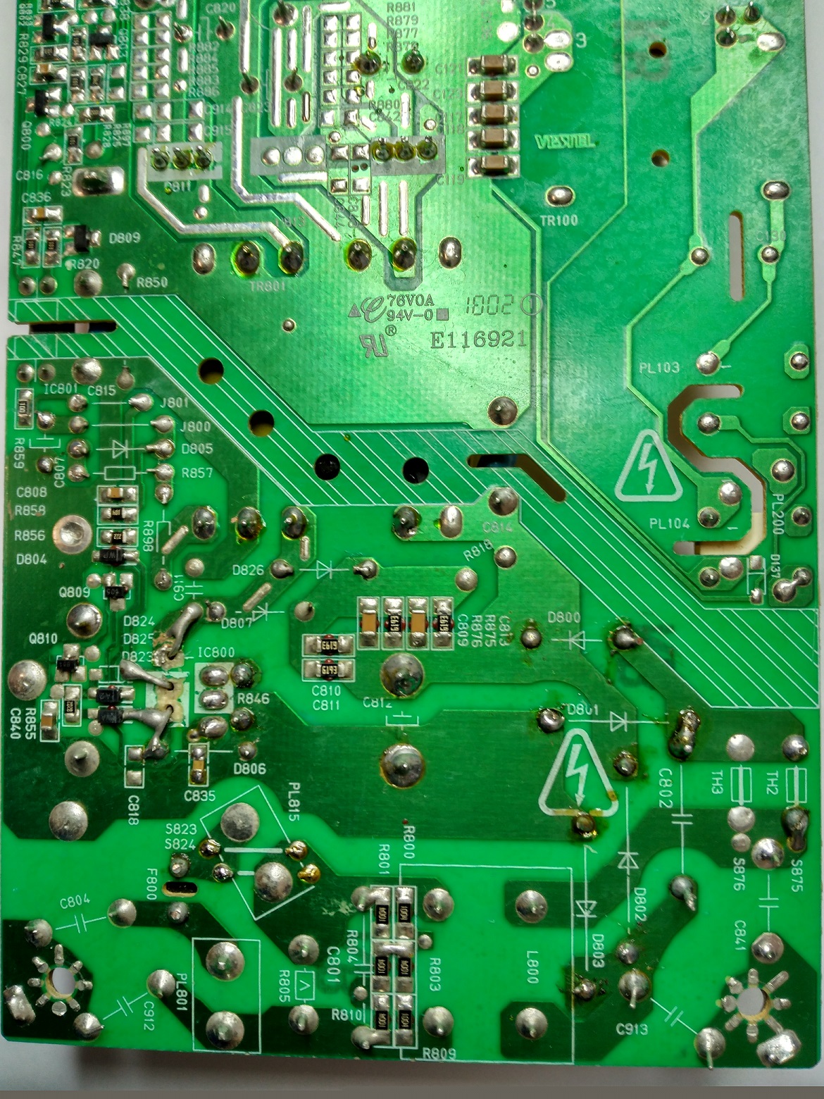

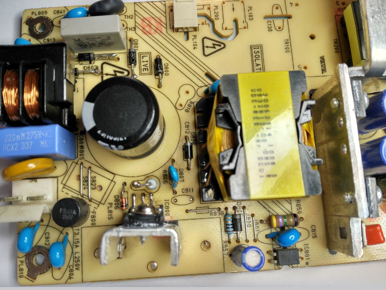

                        Here are two photos of the primary circuit:
                        -Top photo:
                        https://www.dropbox.com/s/f55bjhzlid...y_top.jpg?dl=0
                        -Bottom photo:
                        https://www.dropbox.com/s/ldtj85lv4g...ottom.jpg?dl=0
                        Now you can see the differences between the schematic and the real board.
                        Last edited by JaYmEz; 05-28-2016, 06:22 AM. Reason: Couldn't see/download the images.
                            I attached the photos to this post.
                            The voltage between pins 3 and 4 of the IC801 is 5v.
                                    yours PSU missing one SMD Diode D824
