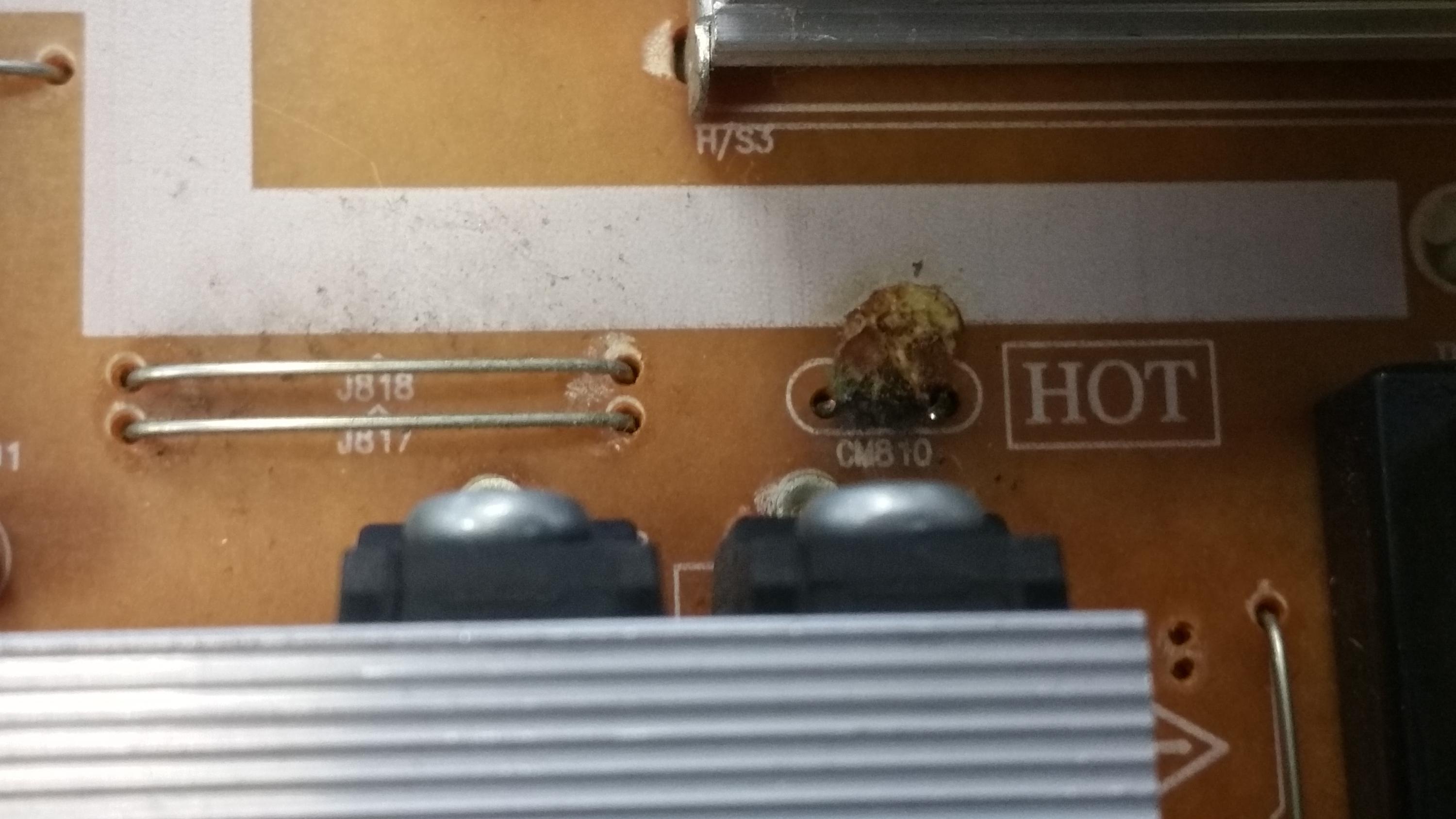

    hi guys, can anyone help me to identify this burned component?
    Is marked as CM810
    Can't find any proper schematics

    That looks like a ceramic capacitor. There should be something printed on it, you might be able to see it when you clean the surface.
    Is it short?

      i know is ceramic cap but i don't know what size.
      It's totaly burned , only pins on pcb left. looks like exploded. The glue probably shorted it

        1. the blue 18n capacitor is cracked and needs to be replaced, without it the resonant power supply doesn't work
        2. "the glue shorted it" - No. That stuff is there to immobilize the component and is definitely not conductive
        3. the cap you were asking for is probably anything from 100p to 470p, up to 1kV maybe. You need to tell us where in the circuit it is.
          Actually, the glue does become conductive somehow. It's a known fault with Samsungs.
          https://www.badcaps.net/forum/showthread.php?t=38628
          Check out post 4.

            Re: SAMSUNG BN44-00234A Identify burned component
            the glue is conductive in time.
            the blue 18n is not shorted . just glue on it
            the cap i need is probably 44n 1kv but not sure

              From your picture the blue one looked cracked. Anyway, they often loose capacitance on similar boards, maybe worth checking at one point.
              The small ceramic cap looks to small to be 44n / 1kV. But who knows. Good luck.
                That is snubber cap. Can we see the bottom side of the board?

                    I have the same problem with part CM-810. Can you help me with the value of the blue ceramic capacitor?
                    • andy vickers
                      • Mar 2015
                      • 2
                      • england
                      Hi its a 222k 1kv if that helps
