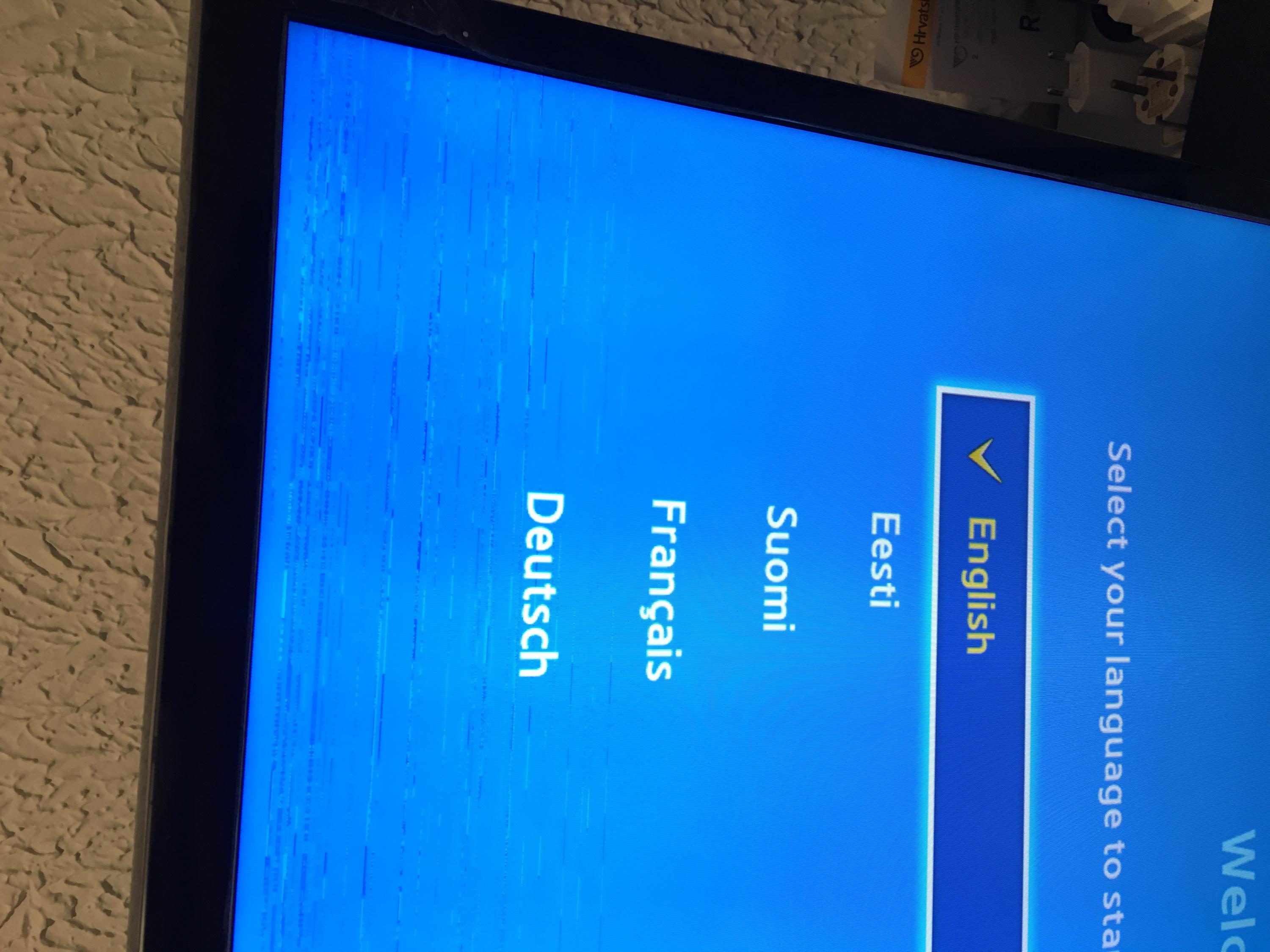

                    Hey i find new bard and install it, i get screen but have some lines. Any ideas what is this?

                      Images coming soon totally forgot. Also RTStorm thats a failed panel them lines

                        But wheb i disconect one flat cabke the line are gone
                        ...the quieter you become the more you are able to hear...

                          Yeah thats because the shorted panel drive isnt getting power so it cant pull the lines up.

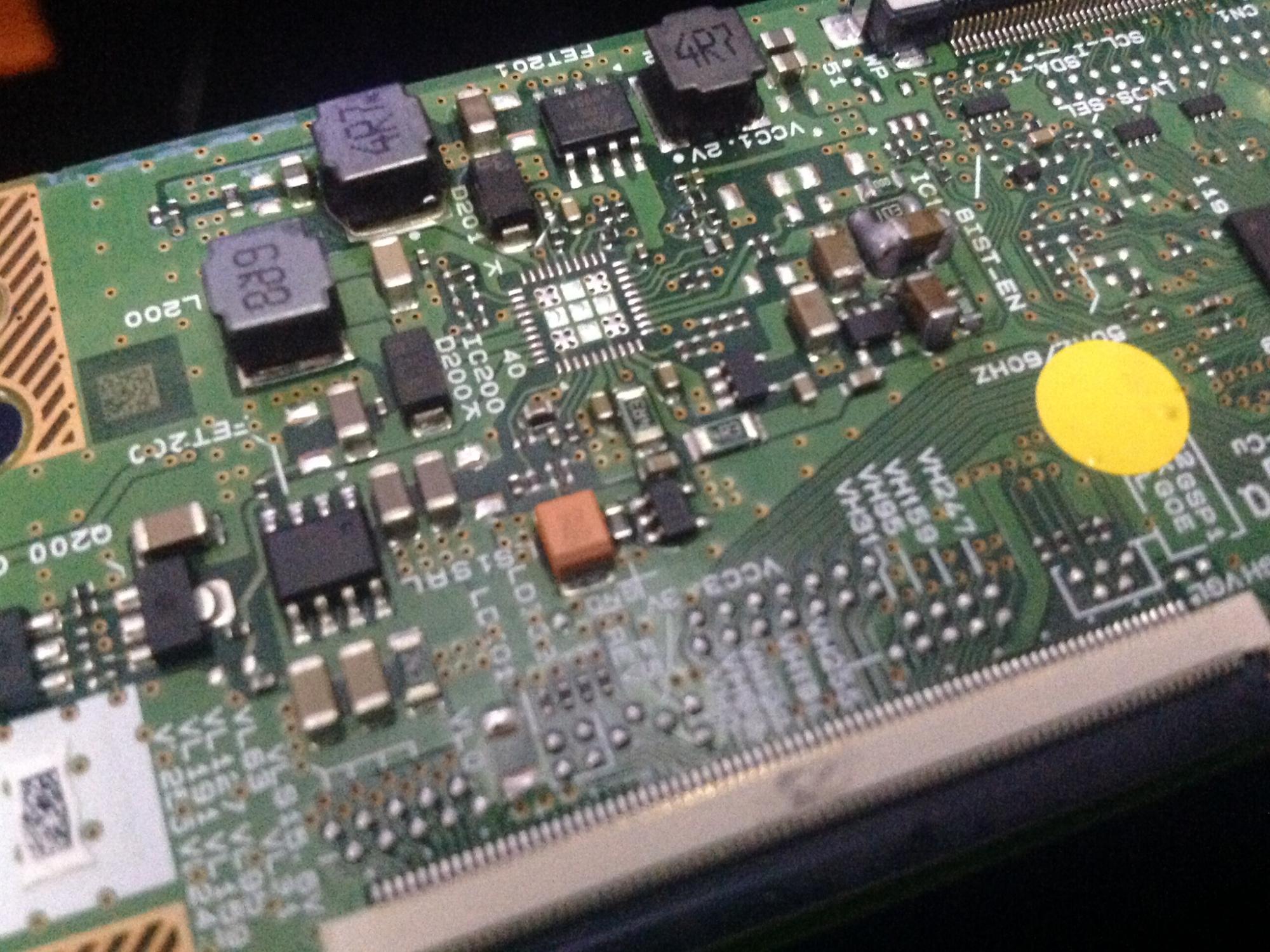

                              Forgot to upload pics of this fix, here they are just forgot. One by one as Vbullet will not let me do more than one at a time on mobile device. First one is old Ic removed.
                              • ReeceyBurger123
                                Never Give Up !
                                • May 2014
                                • 7325
                                • Britain
                                #35
                                Re: RUNTK 5351TP No Picture Failure

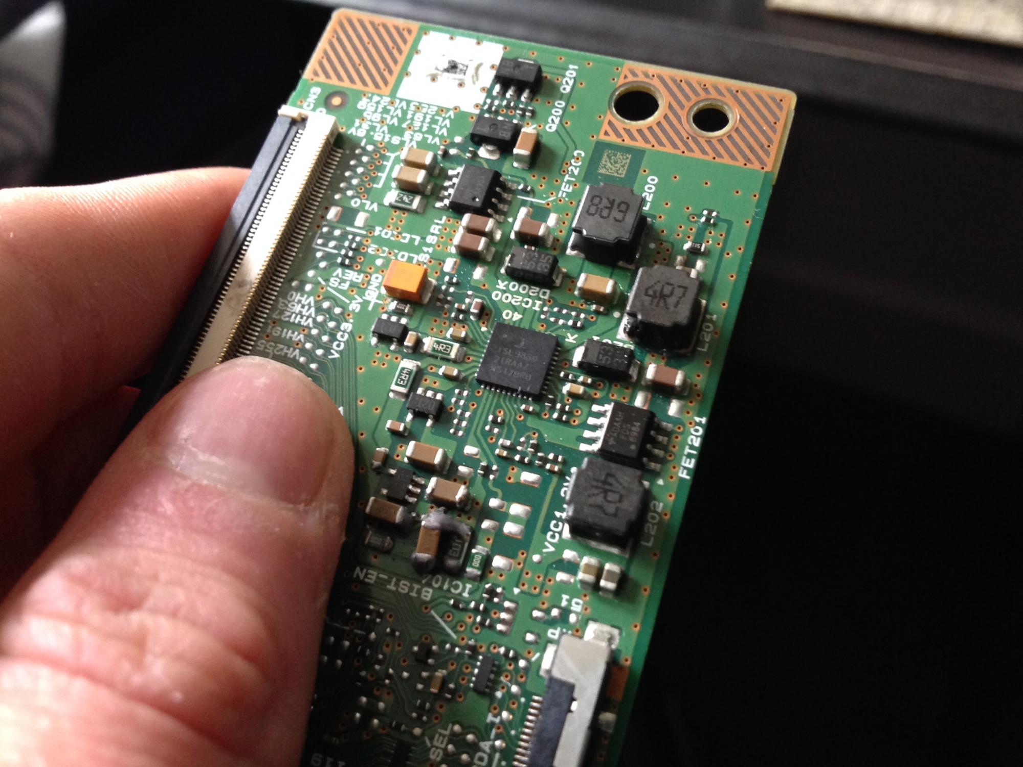

                                Second Ic changed flux residue still present.
                                • ReeceyBurger123
                                  Never Give Up !
                                  • May 2014
                                  • 7325
                                  • Britain
                                  #36
                                  Third is Ic with removed flux.
                                  • ReeceyBurger123
                                    Never Give Up !
                                    • May 2014
                                    • 7325
                                    • Britain
                                    #37
                                    Fourth pic is heatsink added to Ics.
                                    • ReeceyBurger123
                                      Never Give Up !
                                      • May 2014
                                      • 7325
                                      • Britain
                                      #38
                                      5th is working image after I pc change, was preformed ages ago never did a vid and forgot to upload image
