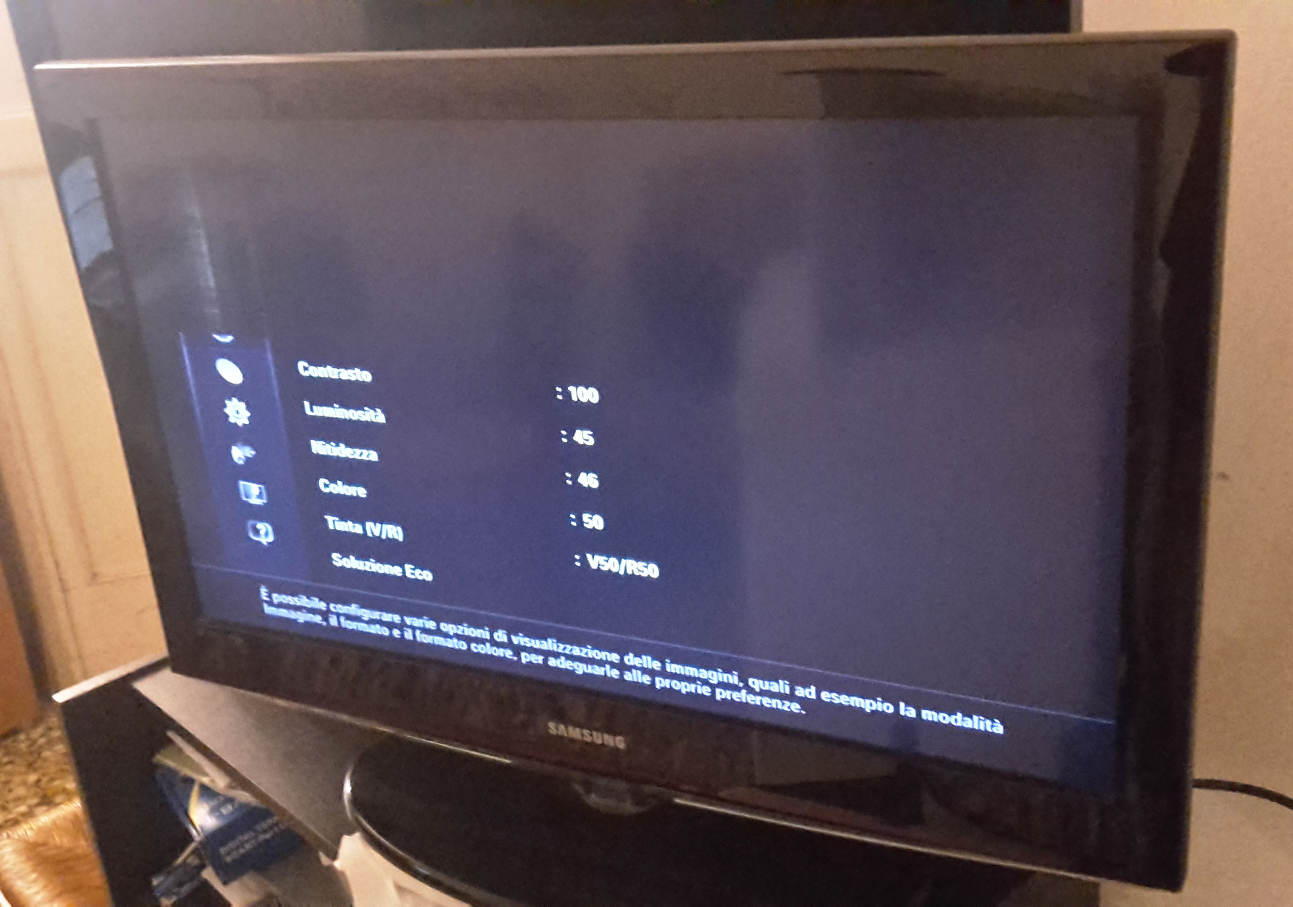

    Hi! I have a Samsung LE32C450E1W TV and suddenly half screen went black, as you can see in the picture. Picture and backlight seems ok. The TV hasn't a T-CON board, so I tried to reseat cables and checked if there's some capacitor blown, without success. Someone has a suggestion?

    please upload Photo for the screen with out any signal. just order to show the menu on it

      here it is. As you can see, only half menu is shown.

        Re: Samsung LE32C450E1W half display
        Panel failure, not fixable sorry

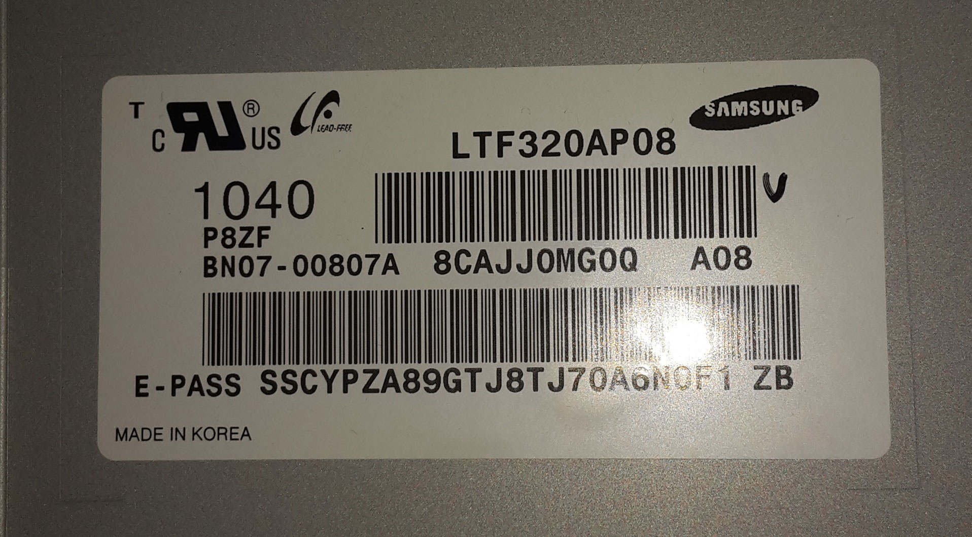

                Yes can you get us image of Panel please. It should be LTA320AP** number.
                        There are COF (chip on film) side address drivers built into the Lcd which drive sections of horizontal rows of the Lcd. It looks like the one near the bottom has failed as the screens in these are inverted, these drivers are bonded to the screen and not replaceable. Seen it plenty of times before on these Panels.
                          That's the label of the panel, hope it helps.
                            Yep AP08 deffo panel, the others I list also fail in the same way:
                            AP04
                            AP05
                            AP06
                            AP07
                              ReeceyBurger123 is correct,
                              as the diagnose the Panel, you will lost nothings, to take it out and inspect its X boards, if there 2 fuse on it,, also inspect the LVDS going in the Panel.. give try it may bring you luck
