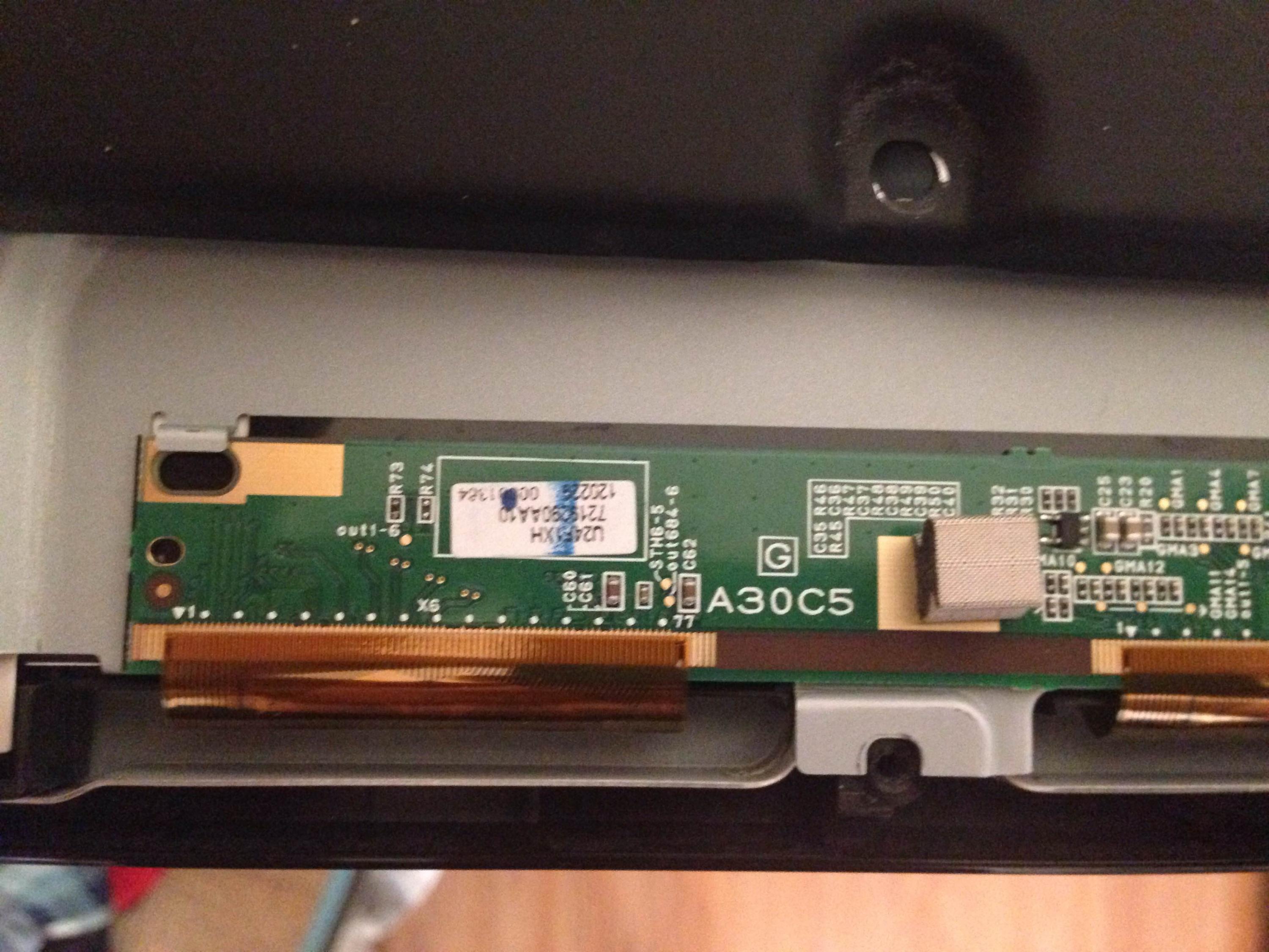

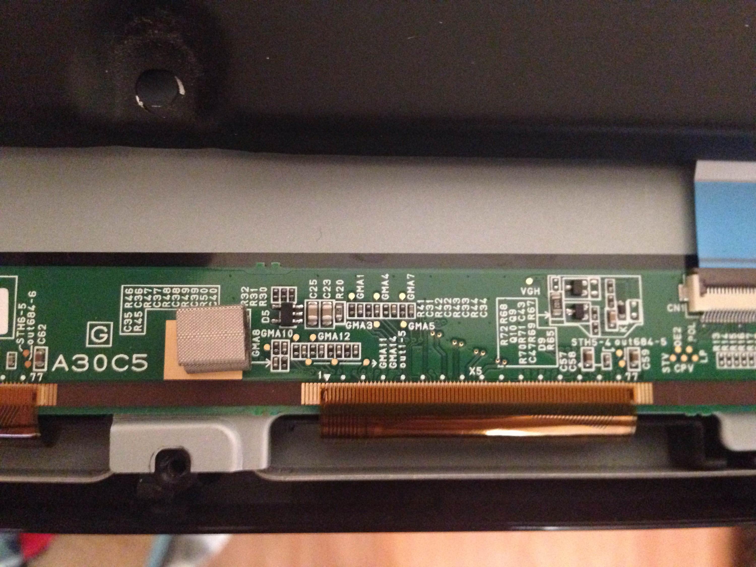

    Yes, it's long though so multiple pictures.
    I checked the cable and get continuity between the pins. I also checked the diodes on there and they look fine. I can't find a schematic anywhere.

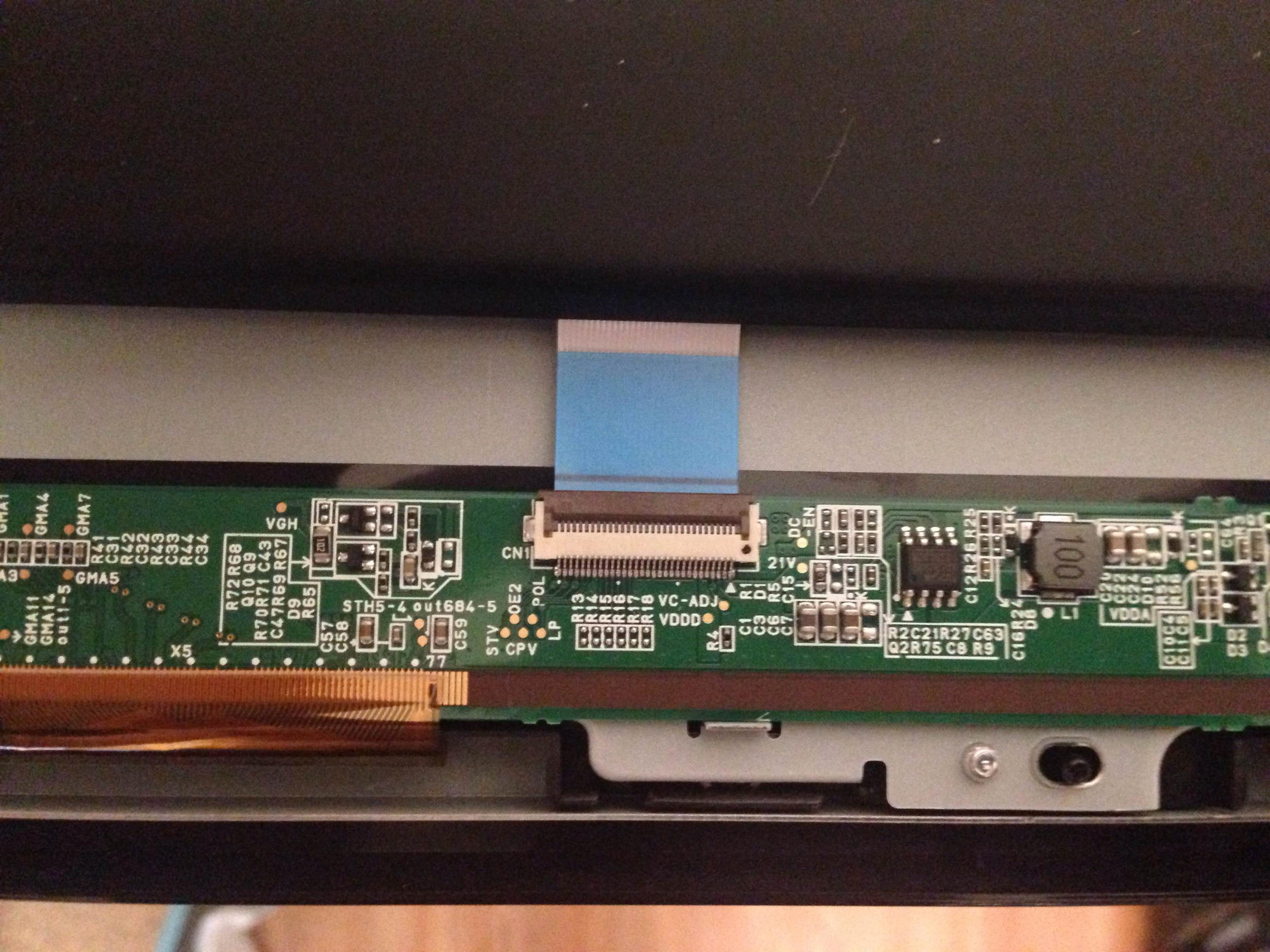

      the first photo, the blue color Ribbon cable ,,, where it connected ???
      • pyrohmstr
        • Apr 2016
        • 30
        #43
        Re: Phillips 32PFL4507/F7 screaming power board
        It goes to the main board.
        I checked continuity between each pin of the connectors. That all looks good.

              on first photo on the right side the ribbon you check point of DC IN 21V do you have it ?
              • pyrohmstr
                • Apr 2016
                • 30
                #47
                Yes. I get 21V there
                I also get 4.6V at VC-ADJ
                and 3.3 at VDDD

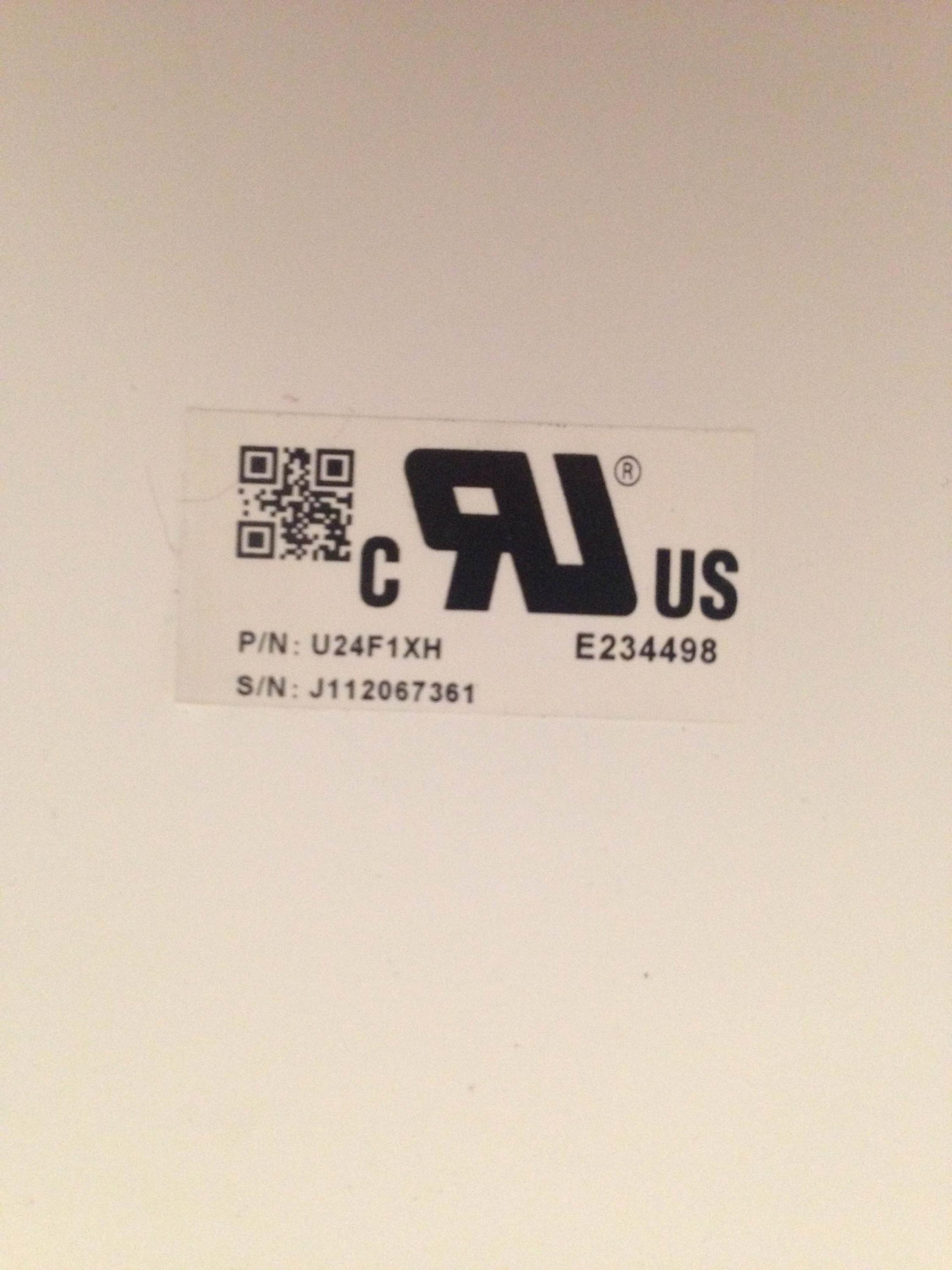

                        There are no 3 digit numbers anywhere on the panel. The panel only has a sticker with U24F1XH on it
                        Only 00001324 and 120229 on a sticker on the board.

                            I'm sorry, this is literally the only thing on the whole panel

                                  Ok so I promised an update.
                                  I got the tv working! Long story short I found an open resistor at R1 on the LCD controller board. It went into the voltage regulator and I recognized that as the same part and layout used on the motherboard. Those take 21V directly in so I assumed that one should have 21V too.
                                  I guess they were using a 0 ohm resistor as a fuse. Which is what they seem to do on the mobo too. This is probably common :p but I don't know this stuff like y'all do. Anyway, replaced it with a bit of wire and now it works. I realize that if it ever shorts again it won't be protected but idk, I'm not touching it again... If it burns the place down I'll post back.
                                  I used the eeprom from the old board to take care of the panel code problem.
