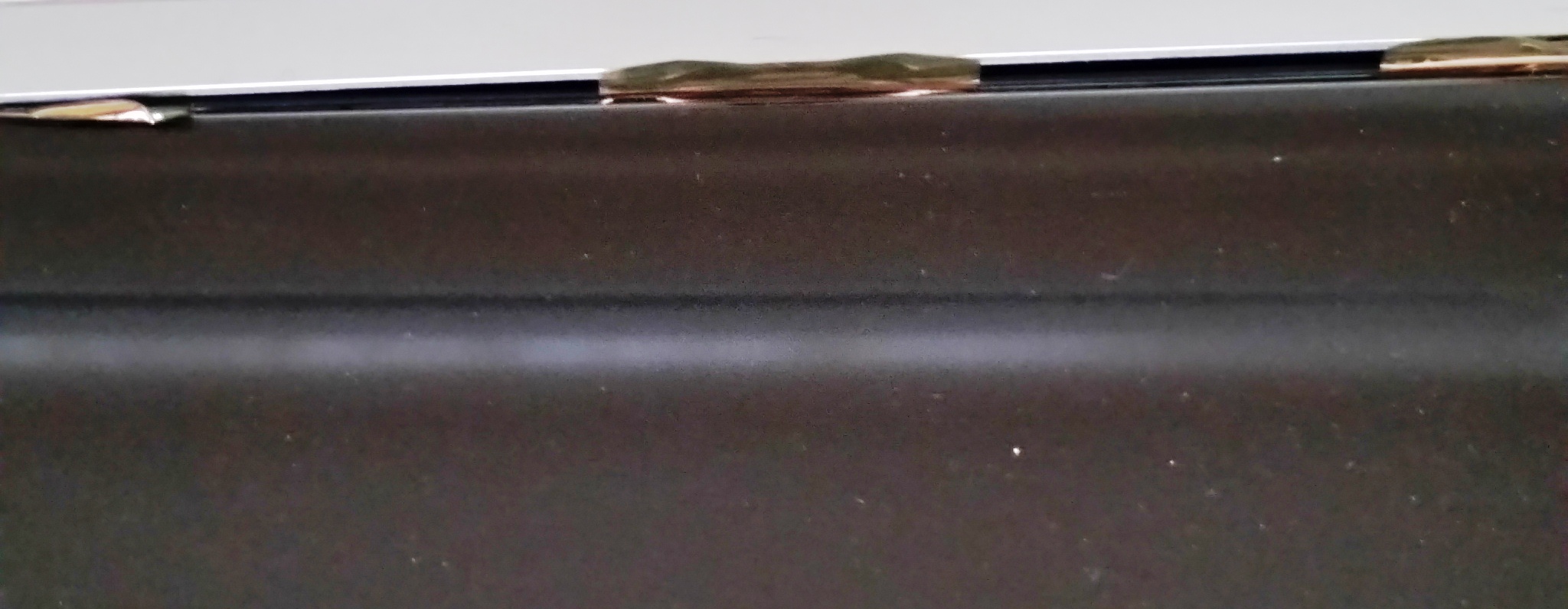

    I got that, I was selling a brand new Samsung 55" 4K nano crystal Led Smart Tv for £600.
    i just bought for 140 EURO over this weekends via ebay from known company new Samsung UE55JU6870 had transport damage, but the panel not Brocken. my questions, did the panel had on the sides Tabs bond?
    see the Photo

    Re: UE55JU6870 transport damage question (moved)
    Looks like the panel is damaged but not broken. Tear it down to the frame and try pressing on the tabs. Also be very careful to get them side drivers back in and not rip them off.
      still not arrived here, tabs re soldering no problem to me, just i was asking are this kind of 4K nano crystal had also Taps on both sides... ?
        Yes they do, theres alot of Pixels to manage, GIG drivers would be hard to do with 4k so they have them on the side.
          as i expected the right side TAP was brocken, unrepairable , refund
            Ahh no, the screens used in thw JU8 series are crap and way and have high failure rate.
