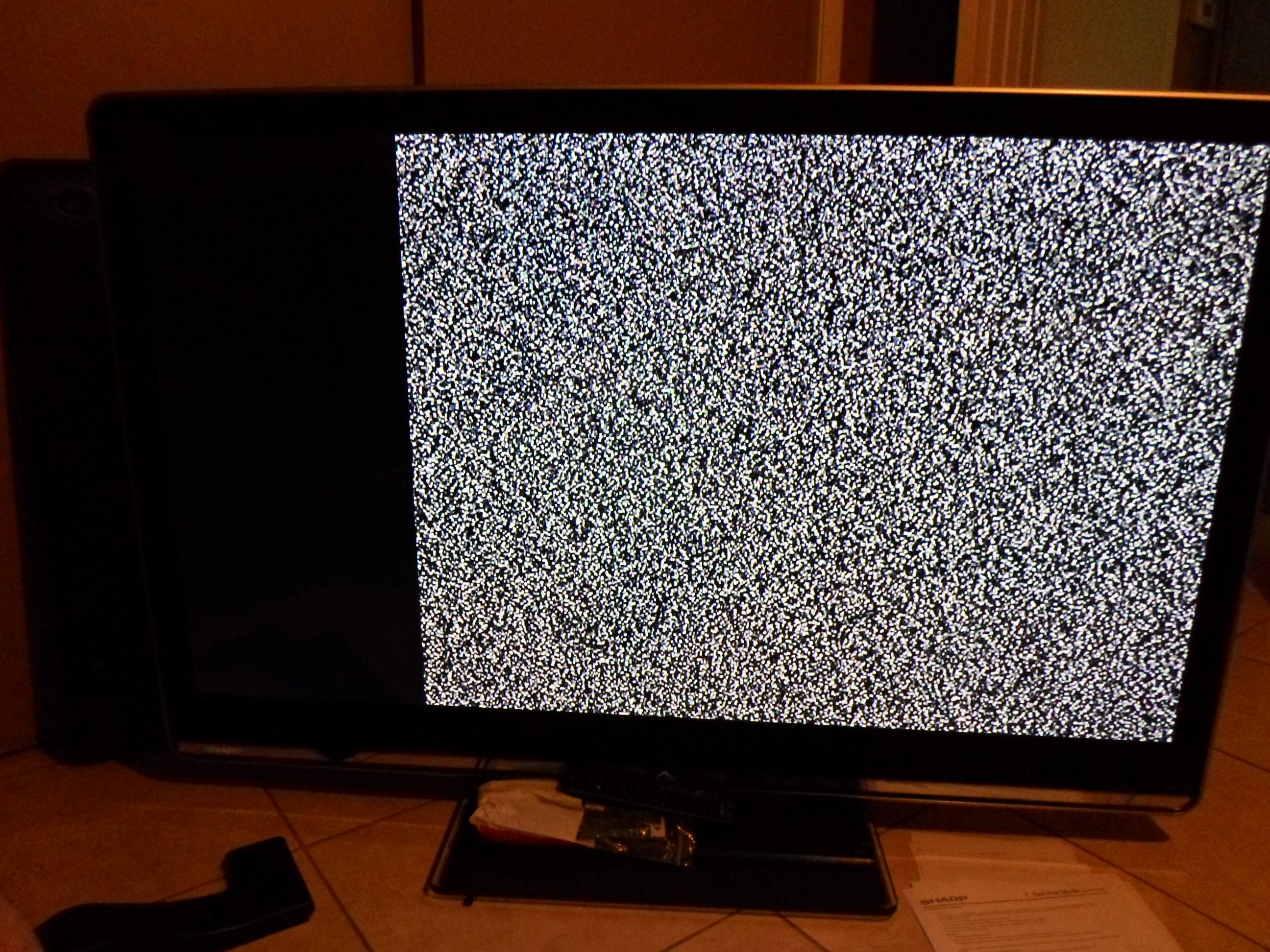

    After doing my research on this model, I found the problem and replaced the bad LED strip. I was very careful with the panel, and this model is actually not that bad to get into.
    But when I reassembled, I am now missing the left 1/4 of the screen image. Now, I am not sure that this wasn't like this before, but I assume it is something that I did.

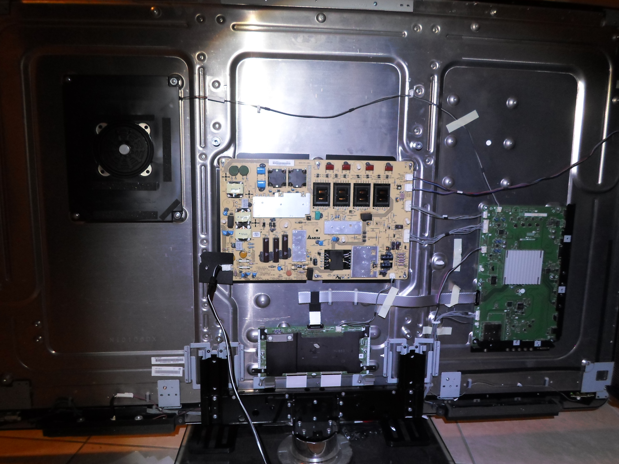

    I took the panel back apart again and tried reseating all the internal ribbons, and the 2 T-Con ones, but still the same issue. I even replaced the LVDS cable because originally the connectors were iffy..
    Any Sharp experts out there that may know what I may have done or where to look?

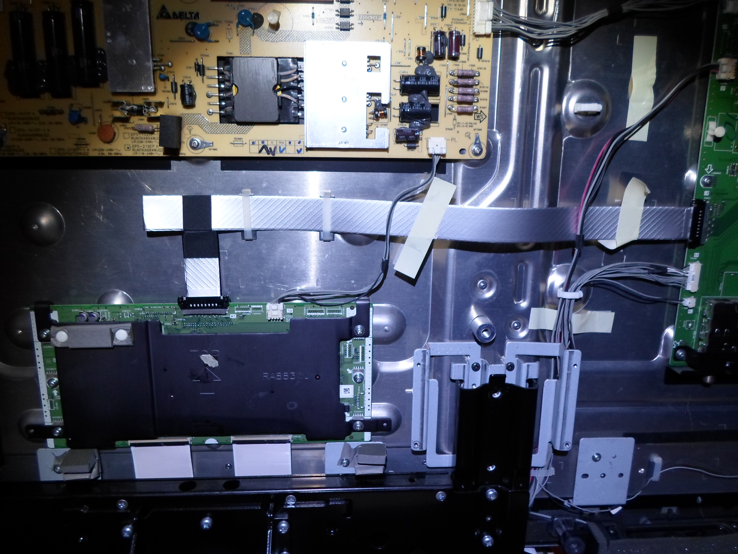

      It's been a few weeks since I missed with it, but I believe this was design that I didn't even need to get down to the tab bonds.. There are a set of 4 ribbons inside panel which I reseated... I may have to open it back up but I pretty much tried everything last time I opened. I guess I can try switching out a ribbon out of the 4. Hoping someone is familiar with this panel...

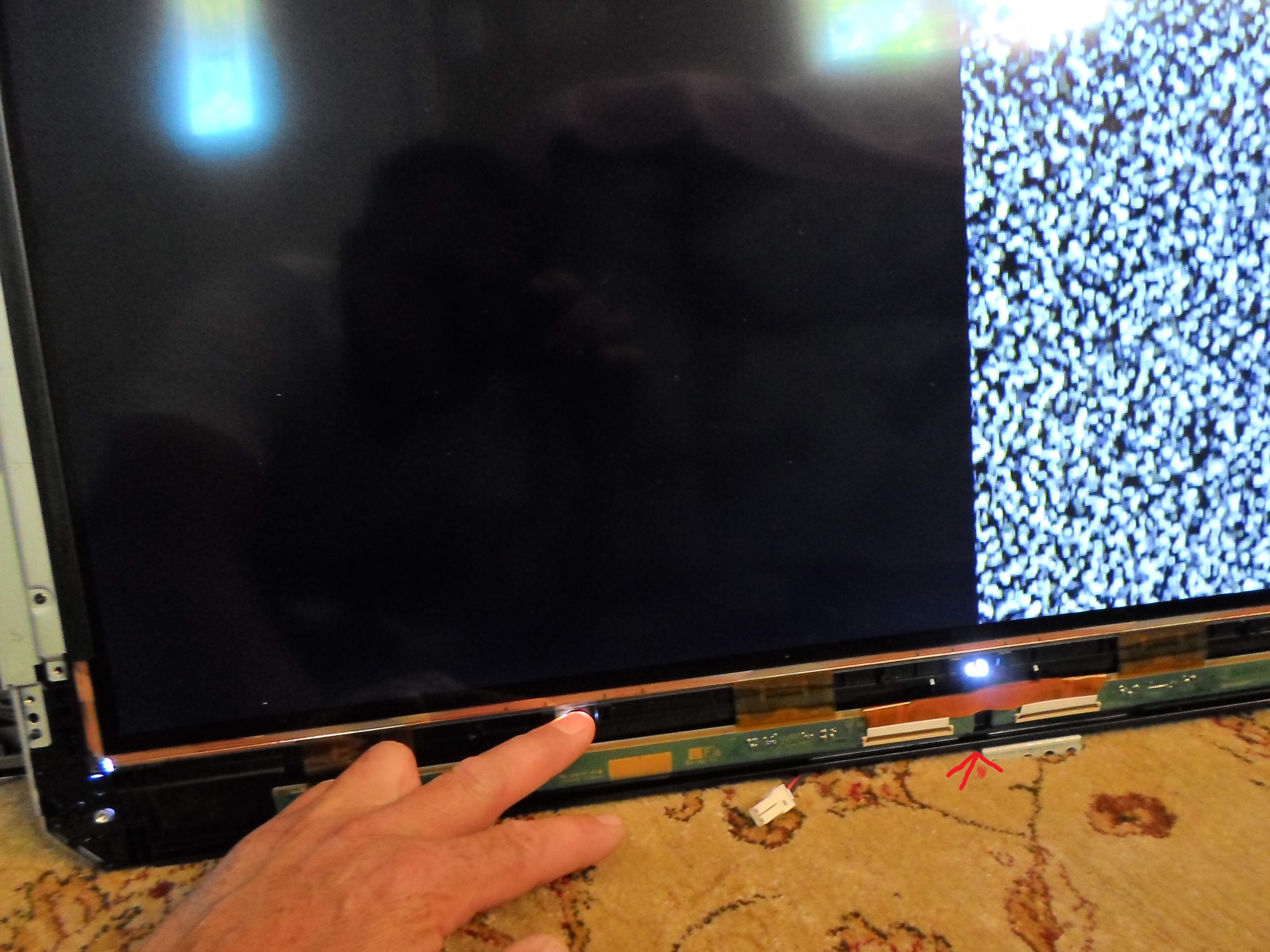

            Does it make sense that the problem is right around here somewhere??
            I just switched the ribbons that connect those 2 boards connected to the panel in the picture (same ribbon on the right side), and got the same results, the ribbon cable is not the issue.

                  Reseat the little ribbon that joins the tab bond board. Will screen shot it later if you don't get what Im talking about.

                    in the picture you finger is on one of the tab bonds i suggested before check the ones where your finger working left to right to make sure they are intact you may need an eye glass to see if they are damaged or torn
