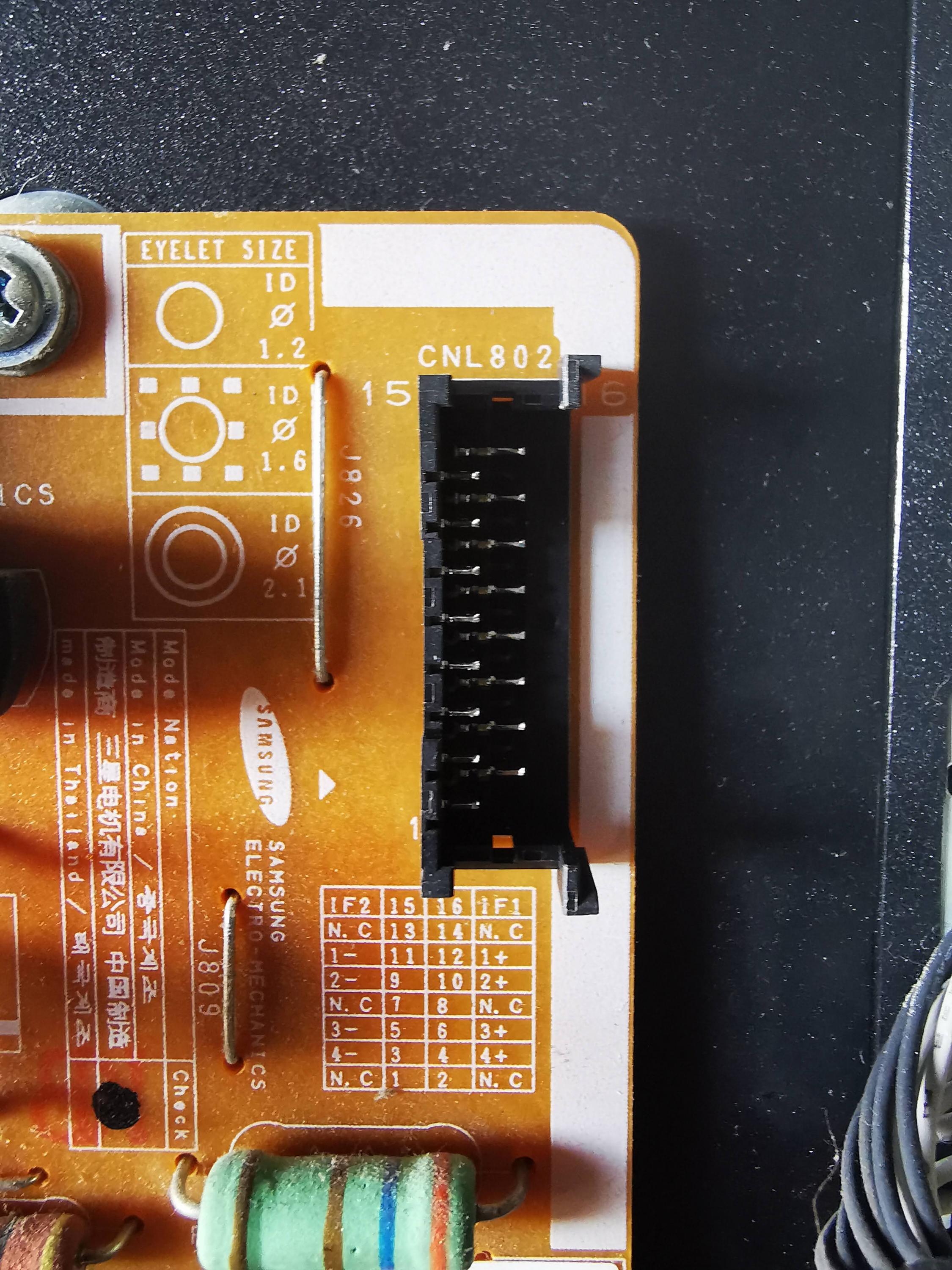

                          Re: Samsung UE32F5000 no Backlight
                          Hello There,
                          My TV stopped working again, it was forseen haha
                          I Couldn't remember the PIN order, it's pretty confusing on the LED Driver.
                          could someone give me a hand ?
                          thx a lot
                              yes I know but I don't understand it ahah
                              I don't know where the 1 is, or what's the order, the chart is not that easy to understand
                              Sorry about that....
                                Show us good clear pictures of the LED connector and the chart printed next to it.
                                  Here it is !
                                  thx a lot
                                    I figured it out I finally understood the chart.
                                    -4 was 0v, found the fault LED solder a new one (good idea I had to buy several ^^)
                                    keep this thread alive guys !!!
                                    thx a lot
