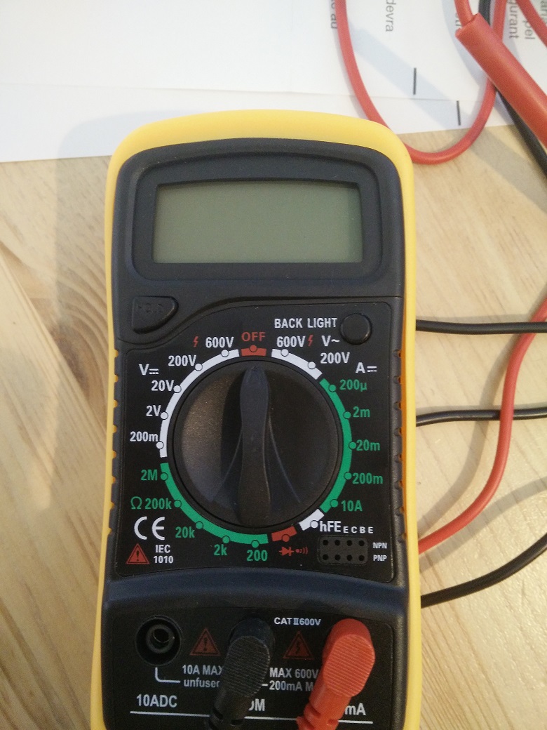

    - I read that i needed to plug the board, and check the current between the pin number 12 and the chassis
    - how do i do that ? I have a multimeter, i'm not sure on which mode i should set it (please check the picture)

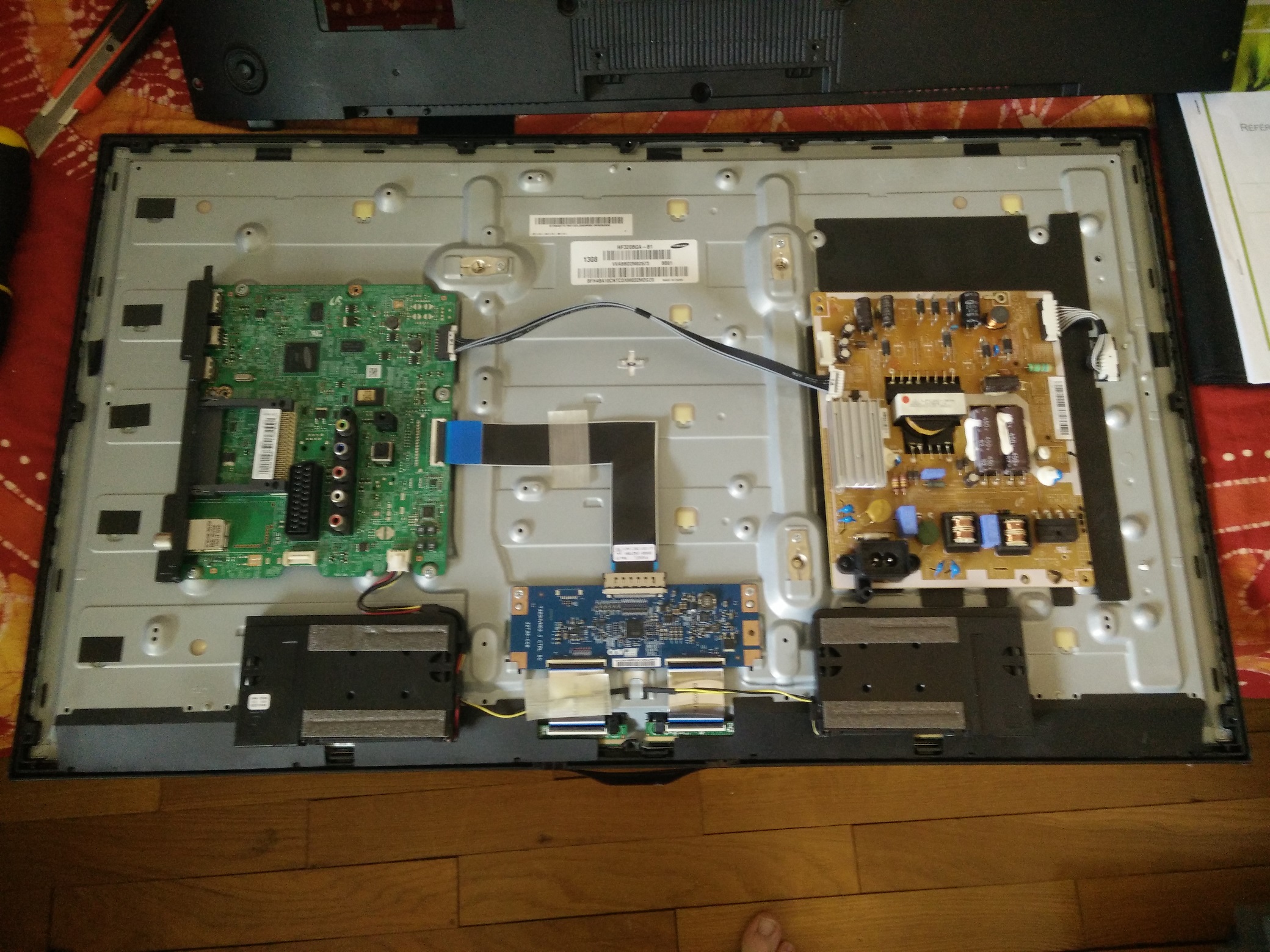

    Re: Samsung UE32F5000 no Backlight
    Update, I unplugged eveything.
    Accessed to the LED
    removed the mainboard
    removed the TCOn board
    Left in place the power board, plugged in the AC --> no light.
    As i understood, in the configuration, the backlight should lit up because the main board is not connected, right ?
    so it's either an open circuit, or a failling power board, right ?
    if I understood well, a short LED would not give this situation, as some LED should lit up, right ?
    many questions ...sorry
    still then I need to be sure how to :
    - check the power board output
    - check the LED strip individually
    could you guide me througt the step ?
    thx

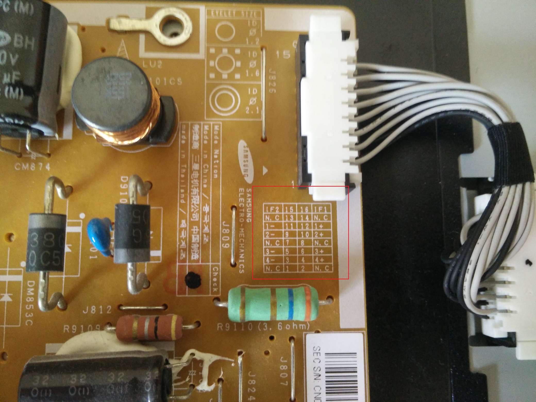

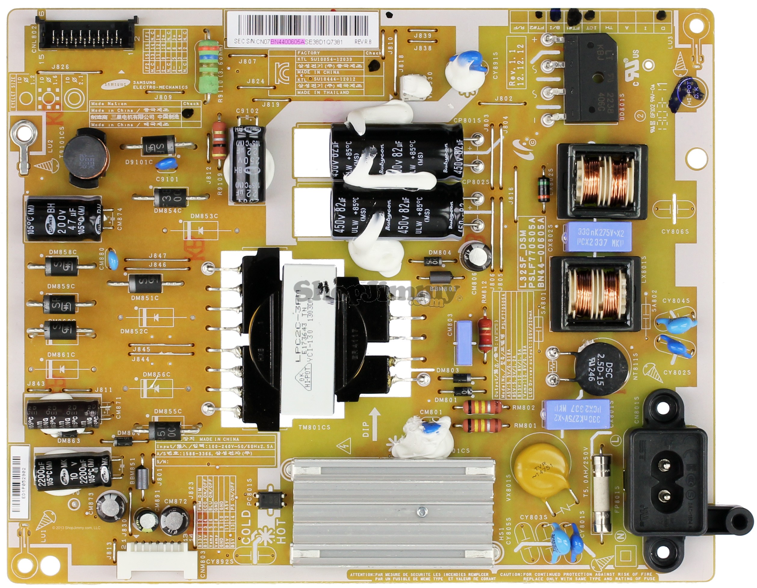

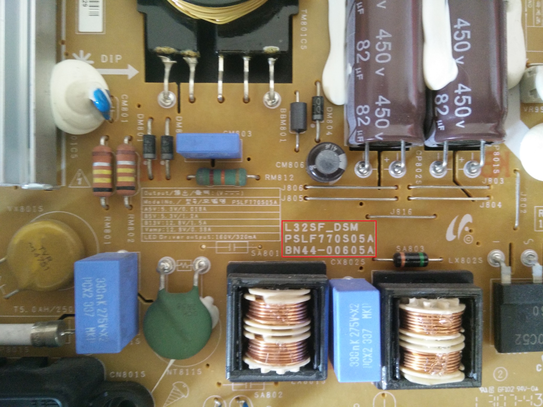

      BN44-00605A power supply/LED driver board.
      With just the power supply board by itself, you need to check the DCV between the chassis GND and the LED connector pins:
      +1, -1
      +2, -2
      +3. -3
      +4, -4
      Report what you get.
      I will not be surprised if you have bad LEDs in the panel.

        Anyway I will test the power board by itself first., but i don't know how to set up my multimeter, well i'm guessing i should be in DC mode and 200V ?
        thx
          "but i'm confused or i'm not understanding you correctly, you replied somewhere that to test the power supply, the LED strips must be connected. I understand the opposite from your answer."
          Right now I want to know what you get with the LED connector in place first, then we will take the readings without the LED connector in place.
          You need to use small probe to check the DCV from the back side of the female connector.

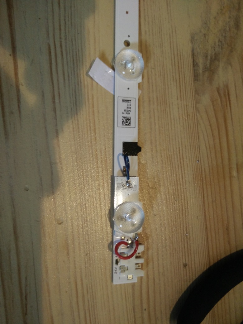

                      Hi all
                      final update to the thread, thx to everyone here I've order some new LED to replace the faulty one and my TV is up and running again.
                      again many thx to you
                          I bought pieces of led strip sold by someone from this forum on Ebay.
                          I did not wanted to unsolder and resolder the led like i saw, this method was way beyond my skills
                            OK, you use the stacking method.
                            Just make sure to turn down the Backlights level in the on screen user menu to as low as possible to extend the life of the LEDs.
                            • o0larry0o
                              • May 2016
                              • 26
                              • France
                              I did, the max on my TV is 20, it set it at 10, and frankly i don't see the difference I watched I show at noon with lot of sun, and it's okay.
                              Do you think half is enough or should I decrease it ?
                                That is more than enough, or lower if the pictures quality is good enough for you in the bright room.

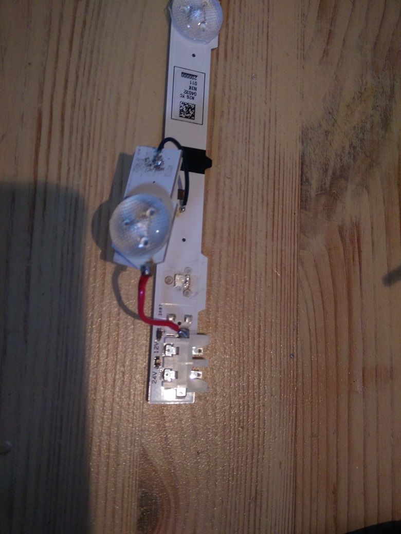

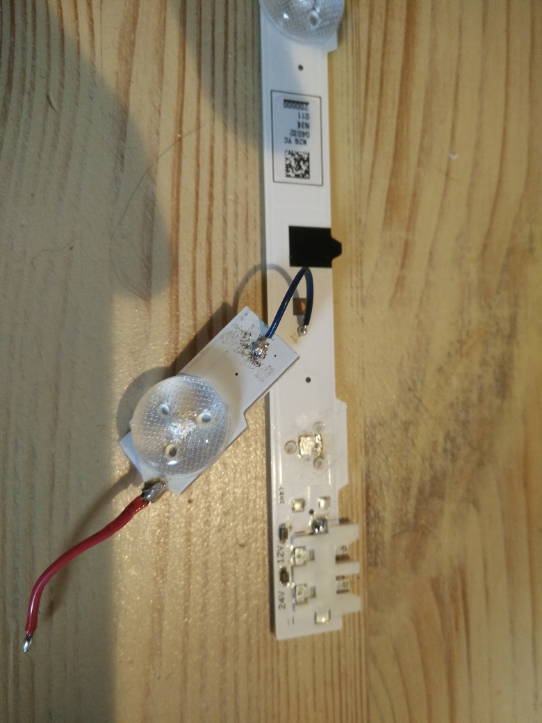

                                • flocko
                                  • Nov 2012
                                  • 1121
                                  • uk
                                  he sent me a photo of the failed LED and I custom made one for him to fit the limited space he had on the strip, and advised how to connect . I am all ways ready to help were I can. I have also added more lens types (5 types now) to cover most strips on my eBay listing and send to Europe and beyond Flocko
                                  • o0larry0o
                                    • May 2016
                                    • 26
                                    • France
                                    Ahh flocko, I couldn't find your user name on the forum :p
                                    thx for your help, it works like a charm
                                    • flocko
                                      • Nov 2012
                                      • 1121
                                      • uk
                                      Thanks glad to help.Even with very little room this has to be the better way to replace failed LEDs.
                                      • o0larry0o
                                        • May 2016
                                        • 26
                                        • France
                                        I think so too, unless you have a spare strip to try to unsolder the led with a heatgun ..and fail ...
