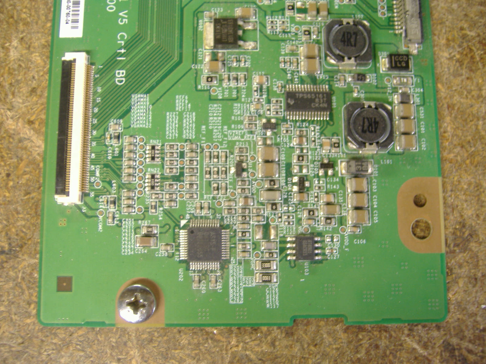

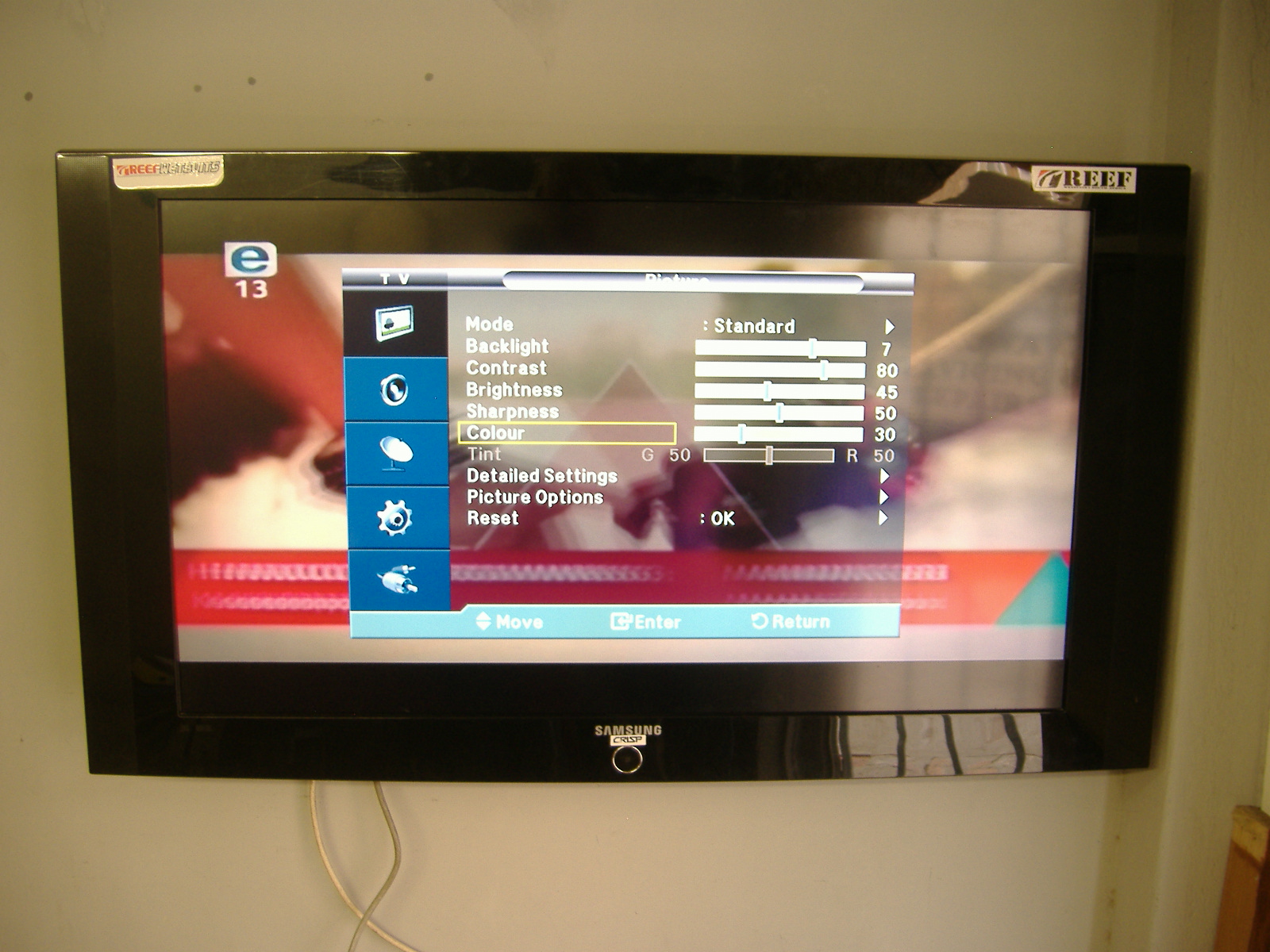

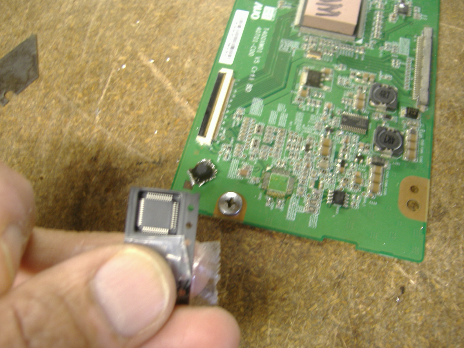

    Hi guys, Managed to successfully repair this television by replacing the AS15F with conventional solder station after following the link on this Forum.

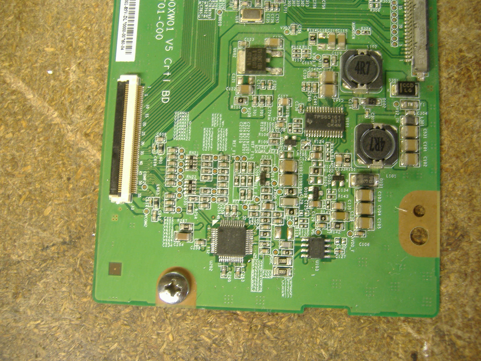

    Photo 1 Secured pcb to workbench using self tapper (its an old bench)

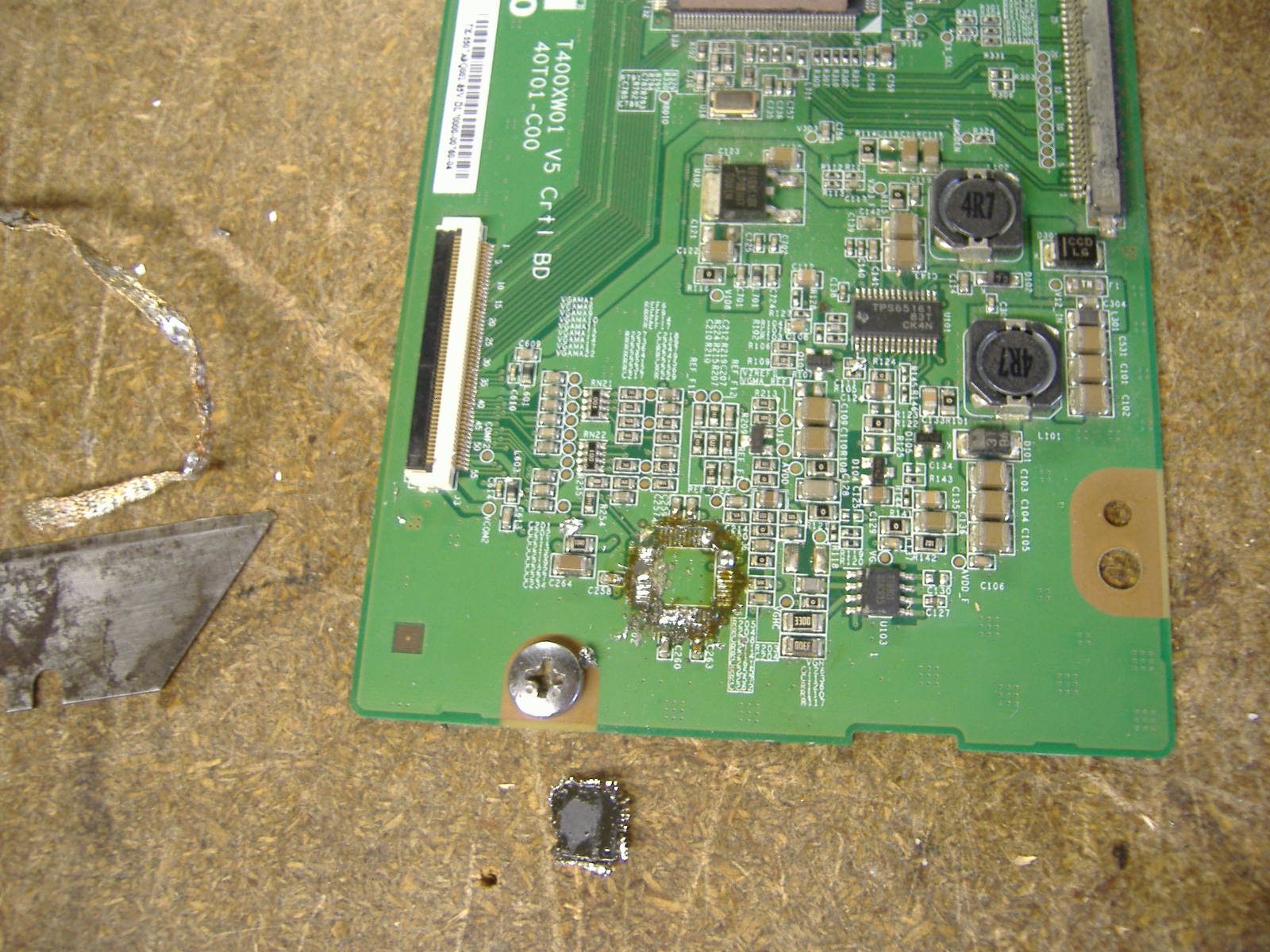

    Photo 2 removed IC by "flooding" all pins with solder, and slowly lift with blade.

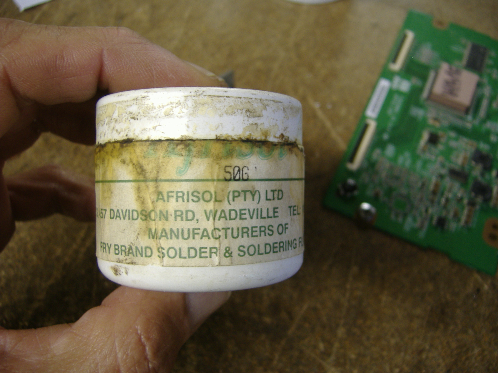

    Photo 3 Used a good dollop of Fry's Flux paste before i started.
    Photo 4 Cleaned up excess solder with Solder Braid/ wick & flux with tooth brush & methylated spirits.

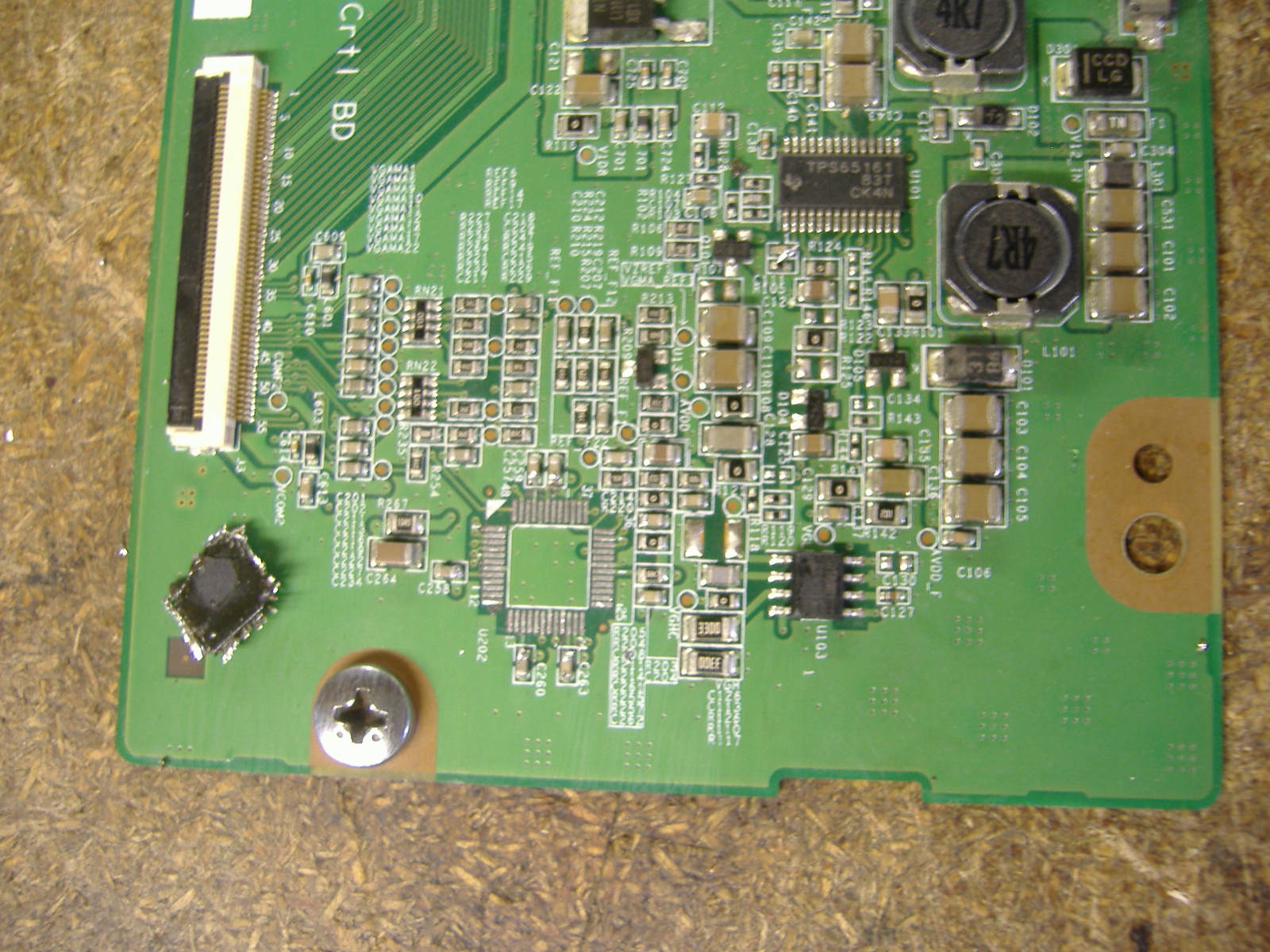

    Photo 5 New chip & in background ic's location with a thin smear of Fry's Flux.
    Photo 6 New chip fitted with standard solder iron & NO solder added. Just ran hot iron softly along all pins.

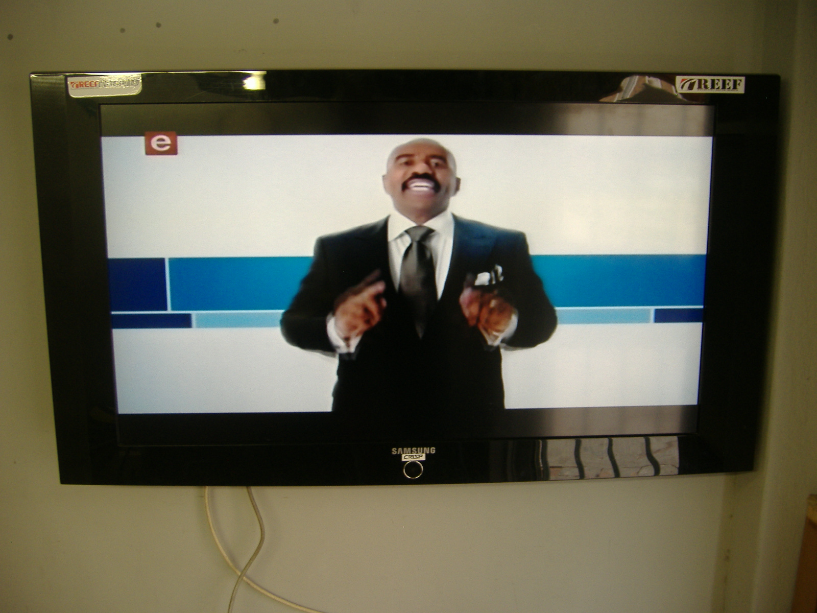

    Photo 7 I did remember to adjust the back light down a notch or Two (was full blast)
    Photo 8 Now good contrast & not milky white picture.
    I have two more to do, & hope this wasn't beginners luck!

    Re: Samsung LA40A330J1X white picture Solved
    Hi Guys, just to follow up, managed to repair my other two sets using same method. Saw the thread about fluxes, and will attempt AlistairE's recipe for fluxes once i have located the ingredients.
