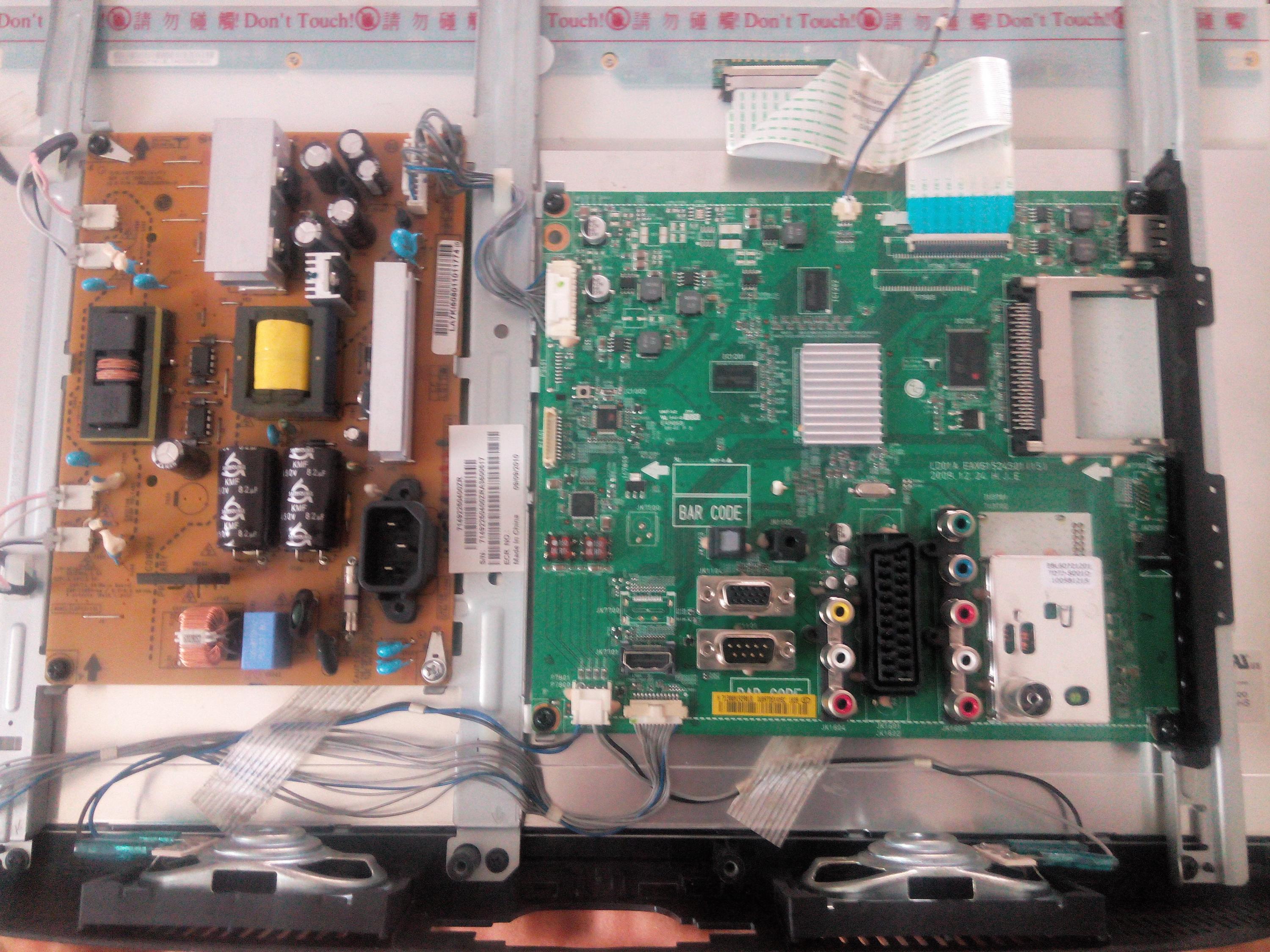

    Hi , can anyone send me a message to help me fix this LCD TV , because after turning it on, the picture disappears after 20 seconds and the red LED starts flashing. Any ideas? Thanks!
  • Andrew F. Ali
    • Jan 2014
    • 2450
    • Trinidad & Tobago
    Re: lcd tv 22ld350-za
    Share with us Make and Model of your TV and Clear Pictures of the back of the TV with the covers removed. Also clear pictures of the connectors to and from each board so we could see voltages expected at each pin of the connectors.

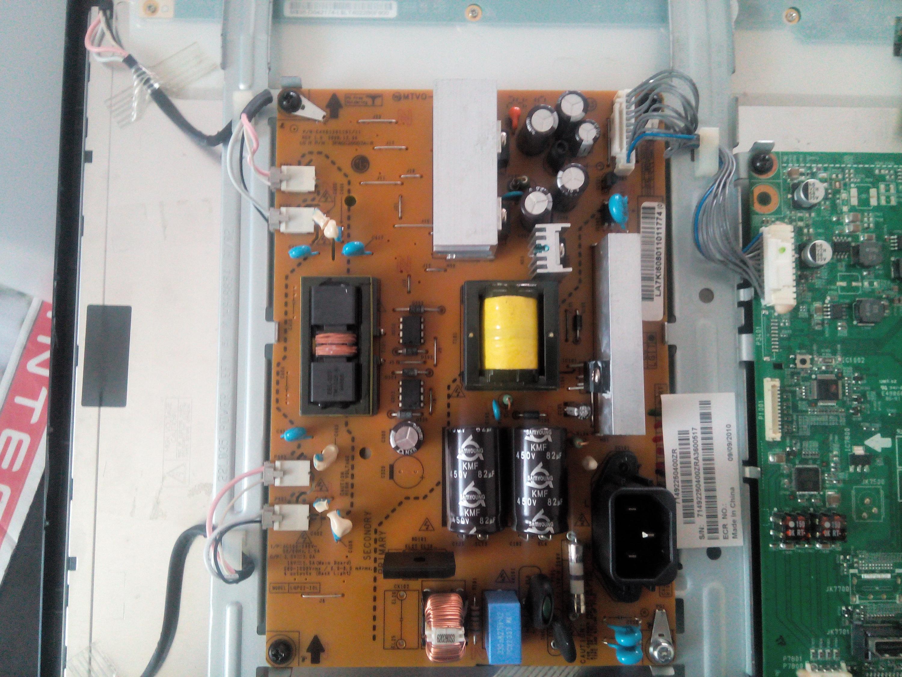

        Can you take the voltage readings when you first switch on and then when you lose the picture at the connector highlighted and give the names of the pins.

          Conn P201 on PSU at Stby : 1,2 to Gnd shoud be 15 VDC , measure =16,03V
          3,4 = Gnd
          5, 6 3,5 V , meas =3,41V
          7 = Gnd
          8 = OLP meas =0 V
          9 = EN m =0 V
          10 = BD ( M ) = 0,11V
          11 = AD ( M ) = 0 V
          12 = NC
          At ON ( picture exist ) : 1, 2 to Gnd....................................=14.7V
          5,6 ................................... = 3.45 V
          8 .................................. = 0V
          9 ................................. =0V
          10 fluctuation 3,27 ; 2.51 ;0 V ( 3 X )
          11 fl. 3,24 ; 1,71 ; 0,15V(3x)
          When red LED flashes 1,2 fluct. from 15,75 to 15,85 V
          6,7 ...................................= 3,4 V
          10 ..................................= 0,11 V
          11 ..................................= 0,15 V
          I saw backlight becomes black 3 times - when voltage on terminal 10 and 11 fluctuated to 0 V.
          All of this within 20 sec.
            Are you sure that when the backligts are on and you see the images on the the screen, the EN pin stays low? That EN pin is the BL-ON control signal.
            BTW, the power supply is an always on power supply and it is OK.
            9 = EN m =0 V. EN = BL-ON
            10 = BD ( M ) = 0,11V. BD = PWM dimming control.
            11 = AD ( M ) = 0 V. AD = Analog Dimming control.
