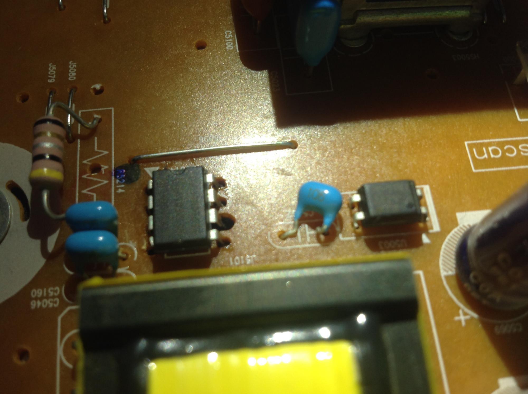

Hi chaps got this faulty samsung Ymain diagnosed that the Ice controller chip was failed but also have heard that the tantalum capacitors next to it also go. Im looking for replacements but cant find what voltage these are they just say "106" on them. Any ideas are appreciated, there is also no schematic for the board either.

That looks like ceramic cap to me. How is it connected in the circuit?
Which ICE series IC?Last edited by budm; 05-03-2016, 02:07 PM.Never stop learning

You might be correct there as dont think they are polarized. They are in series with some of the pins of the Ic to ground.Please Do Not PM My Page Asking For Help Badcaps Is The Place For Advise, Page Linked For Business Reasons Only. Anyone Doing So Will Be Banned Instantly !

Aye-- the usual MLCC in through-hole package...
106 what, 1 nan....?Last edited by Alastair E; 05-03-2016, 02:19 PM.TELEFIX

Its a ceramic think its about 1uf or so ? Cant seem to find much.

Right seems to be 10uf 50v if that seems good ? I can find Smd versions of this cap so might SM it rather than TH.Please Do Not PM My Page Asking For Help Badcaps Is The Place For Advise, Page Linked For Business Reasons Only. Anyone Doing So Will Be Banned Instantly !

Yep they are 10uf each measured them with my meter, so going to order some 10uf 50v ceramic caps. Thanks everyonePlease Do Not PM My Page Asking For Help Badcaps Is The Place For Advise, Page Linked For Business Reasons Only. Anyone Doing So Will Be Banned Instantly !

Hmm does any one think its possible for me to use lytic caps instead as I have some on hand will just have to polarize them properly ? I have done this before and not had issues.Please Do Not PM My Page Asking For Help Badcaps Is The Place For Advise, Page Linked For Business Reasons Only. Anyone Doing So Will Be Banned Instantly !

They use ceramic due to lower ESR than lytics cap.Never stop learning
