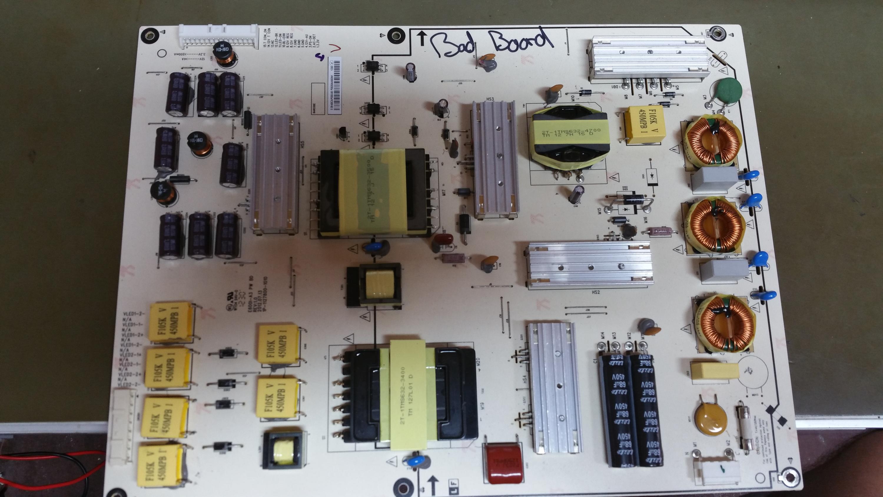

    Hello All!
    When I got the television it was not powering on and the person told me that they heard a loud pop and then it turned off. This person replaced the fuse but it kept blowing. Once I had the television I confirmed that, yes the fuse was blowing whenever it was replaced. There was no standby light and the replacement power board was not expensive so I opted for a replacement immediately. Link to image of original board is attached.
    Once the new board was installed the fuse no longer blew but I was still not getting a standby light. Putting the meter up to the 3.3v on pin one shows 3.33v which I'm assuming is the stanby voltage. This may be my problem but there are no other indications of where to test for stanby voltage. When testing pins 14, 9, 8, and, 4 they all read what they're supposed to read. I've attempted shorting pin 3 to pin 1 pin 4 and pins 8 and 9 to force the television on but I get nothing. I've also shorted pin 11 to pin 12 and the back lights flash on and off over and over. I've replaced this board with 3 others with the same results. I've also replaced the main board with no success. Every time no standby light. To be honest I'm a little in experienced when it comes to advanced testing so any help would be appreciated. Thanks!
    Last edited by Hiatsu2k8; 05-01-2016, 11:16 AM. Reason: Imgur link is not displaying

    Re: VIZIO e601i-a3 No Stby Light but Stby Voltage Good.
    What voltage do you get on Pin 10 (Backlight Error)?
    • Hiatsu2k8
      • May 2016
      • 25
      It bounces from 1.9 to 2.4 very quickly. That's with no jumpers.
        It looks as though you have a faulty led(s).
        Can you measue the led voltages at the connector (picture fuzzy so cannot see the number) and post them. Suspect at switch on they are high and then fall.
            I don't think you have a problem with the main board so reconnect everything and check the voltages where it says VLed1,2,3 etc. Switch on and see if the voltage goes high and then drops low. Set meter to 200V dc.
              If the voltage on this pin is bouncing then you have a backlight problem.
                Also check the 4 diodes alongside with your meter set to "diode" check.
                  All 4 diodes read around .43V with Negative on the silver side and OL when switched. Am assuming this is correct that it's because they are allowing current through one way but not as much through the other? This makes me think they are working correctly.
                  Concerning reading the other pins, I was already fairly sure that the back lights were the issue now I'm trying to understand why. The labels are confusing me when they say VLED 1-2- and 1-2+ does that mean I need to use the positive on 1-2+ and negative on 1-2-? Or is it just a positive lead on each pin and negative on ground? Or is the 1-2- just lead to ground anyway?
                    If you can read them with the negative lead on the chassis and use positive pin to take the readings.
                          You haven't said what the readings were? Could be helpful to others who have the same fault.
                            Each pin was right around 5v. They would fluctuate between 3.5 to 6v up and down. A couple of pins were steady at 5. What was more confusing was on certain parts of the chassis I got fluctuating readings but they were much higher, in the 100s. I had the ps-on pin shorted to the 3.3v while I did this.
                              Disconnect all the led connections and measure the voltage at switch on between the edge connectors and chassis. I would expect an intial voltage of 150 - 200V at switch on and then a sudden drop.
