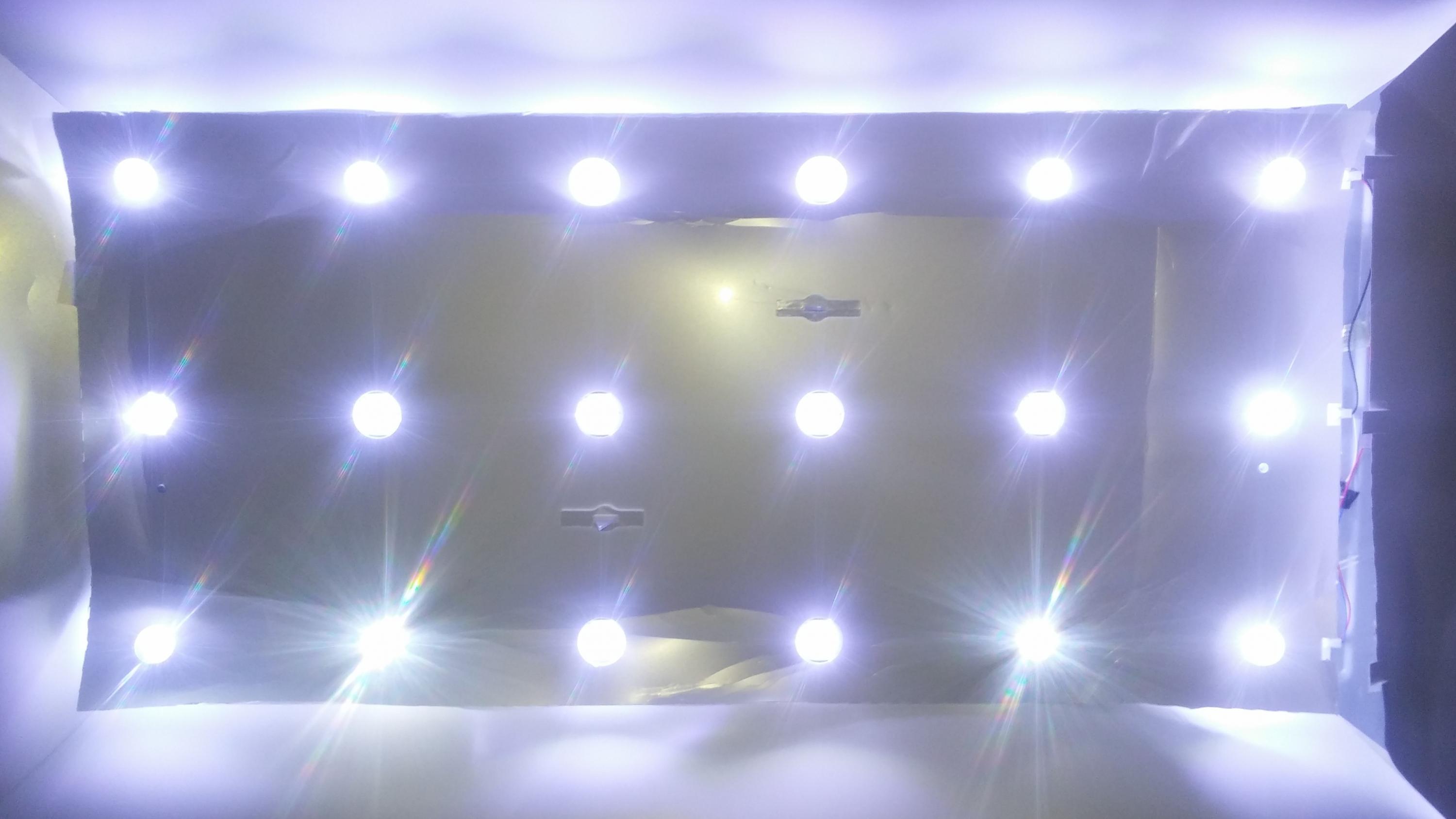

      No, no flash from the backlights. I can, barely, see the "Highsense" emblem with a flashlight.
      Has anyone tried wiring up a test backlight LED string? From other posts it looks like if even one LED fails open, the TV senses no current and shuts down.
      There is ~85V on the high pin LP, and less than 24 VDC on the LN pin. When I unplug the LED string LN goes to 0.

        So wait do you get brief Led voltage of about 90v ?
          Re: Hisense 32K20DW missing LED voltages and 6 blinks
          'When I unplug the LED string LN goes to 0'
          How about LP without LED connected?
          If the meter is fast enough:
          85V- 24V = 61V Total Vf.
          61V/3V = about 20 LEDs, does not sound right for 32 inch panel, may be some of the LEDs are shorted which may have cause the original MOSFET to be bad in the first place.

                I finally got up the nerve to open the panel and test the backlight strips. Two test fine on all LEDs with diode check. The third has two dead LEDs. I see a few incompatible strips on ebay. Where can I buy the little square diodes? Do you pros have a part number?
                The identical strips have several numbers. I've gotten hits for keywords E227809C but not for HE32VLEAK14010503847 , 1130209 or 89ma062L-B1.
                • steves7839
                  • Nov 2014
                  • 200
                  Persistence paid off!
                  I replaced the open LEDs with 3 types before I got one in that does not die instantly. And only 1mm thick like the originals. The panel has been all lit up for 15 minutes so far; I'm going for an hour before I put it back together.
                  In case anyone reading wants to try this repair, the led ic's that work are Digikey 1516-1050-1-ND AKA Brightek QBHP686-IWK-CW. An entire 3mm by 2.5mm by 1mm thick.

                        What is the least maximum current I should look for? I have 61 VDC lighting 18 LEDs.
                          #32
                          300mA or higher.

                            MXA7-PW65-H001 Lumilite from Digikey. The 'working' replacements worked about an hour before one went out.
                            To Vince_Rodgers, The two replacements looked slightly yellower without any diffuser, essentially the same. I won't reassemble the panel until the LED strip works for an hour or more.

                                  Here's a pic of the exposed LED strips powering 300mA smd LEDs. If these stay on a full hour I will put the panel back together. The color is a bit yellower than the originals, similar to the earlier replacements that lasted about an hour. But the LED is described by its manufacturer as "Luxeon Cool White 6500K 2SMD". Perhaps a better match would be obtained with daylight color, 7000K or so. I hope the filter panel will absorb the color difference.
                                  No more fault codes, at least!
